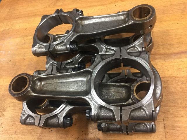

Only a small update, but quite a significant one.
I was sitting down last weekend and doing some spreadsheet juggling of individual component weights, to get the optimum combination across rods, rod bolts, piston/rings and piston wrist pins.
There was some fettling work required with a spread of 2.5gms from heaviest to lightest. Before doing any alterations, I thought I'd just give the wrist pins a quick look/see on the rods, and then had a face-palm moment. I'd made the assumption that the previous pistons had used 23mm pins - they didn't, instead 5yrs ago the rods were re-bushed and sized for 22mm.
Not the end of the world by any means, a quick re-sizing and a hone out to 23mm and "job done". Of course, the rods would have to be removed but that in itself would allow me to get them end-to-end balanced, which I never did the first time around.

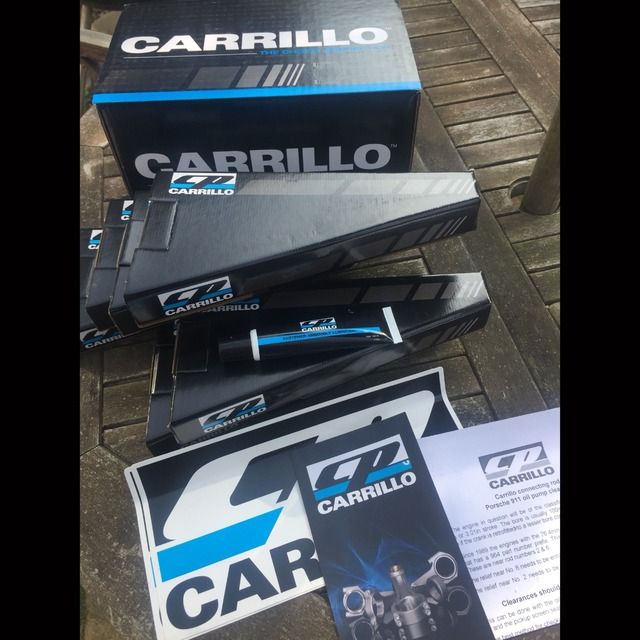

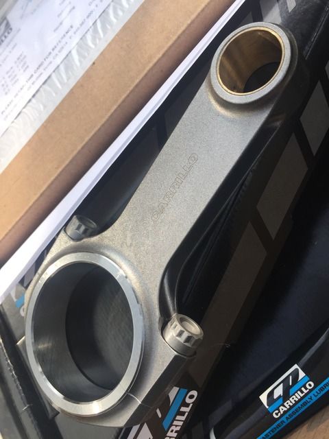

But why would I want to only spend a handful of ££'s when I can spend a couple of thousand? Lol.
A couple of calls with Chris, and I've decided to invest in a lovely new set of CP Carrillo steel rods. A set is in stock and should be available pretty quickly....the back-of-sofa fund hunting will commence tonight.
In the meantime, I'll be removing the existing rods with ARP bolts, and they're going to be up for sale...I can't keep storing the removed parts! If interested, shoot me a PM. The ARP bolts have only been tightened once, and this was done using a stretch gauge (as you can check in the earlier pages of this build thread). The small-ends were re-bushed for the rebuild, so as a 22mm size they've done no more than 400-500miles. Of course, if honing out to 23mm, then you're back to zero miles

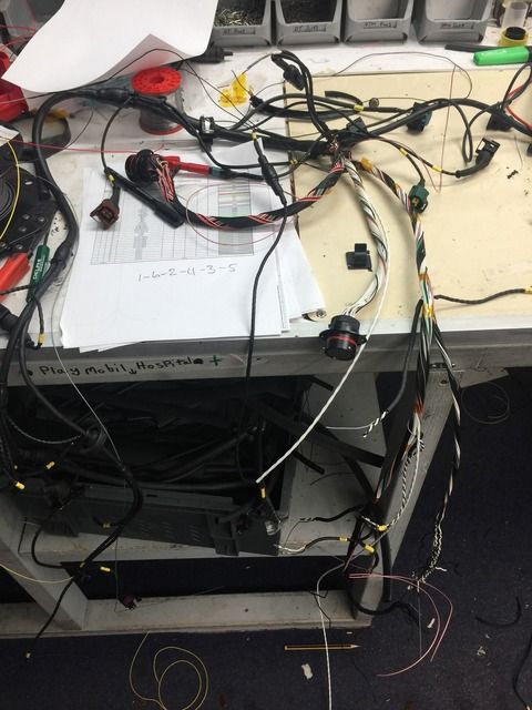

Yesterday I went across to my wiring loom guy, to refresh our memories as to what mods we're going to make (more later), and where to breakout out these additional items. Well worth the trip over; the engine half of the loom is partially stripped...its a shame as the mods are quite disruptive but Simon knows what my expectations are in terms of doing a proper job, and not something that looks like a hack-job. Hoping to get the loom back in a few weeks time.
http://img.photobucket.com/albums/v2...d/IMG_0963.jpg

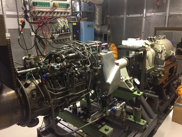

In another building is an amazing engine dyno cell, with one of the real RR Gnome engines hooked up to a Schenker dyno, testing oil tanks (versus engine temps)....
http://img.photobucket.com/albums/v2...d/IMG_1027.jpg
Interesting to discuss this unit, and see some of the closeup detail. This won't come as any surprise to somebody with any aviation experience, but to me (who doesn't) seeing things like every single fixing being a 12-pt piece was amazing. Then to get an overview of how these engines work (constant speed?) and realising that such a compact unit delivers north of 1,200hp....needless to say it raised my eyebrows.

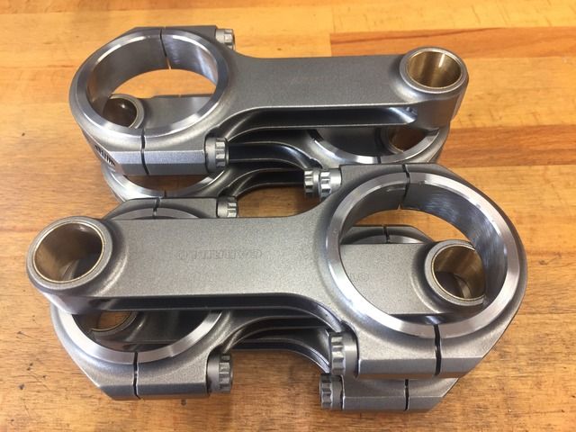

Some quick shots of the rods, post balancing....

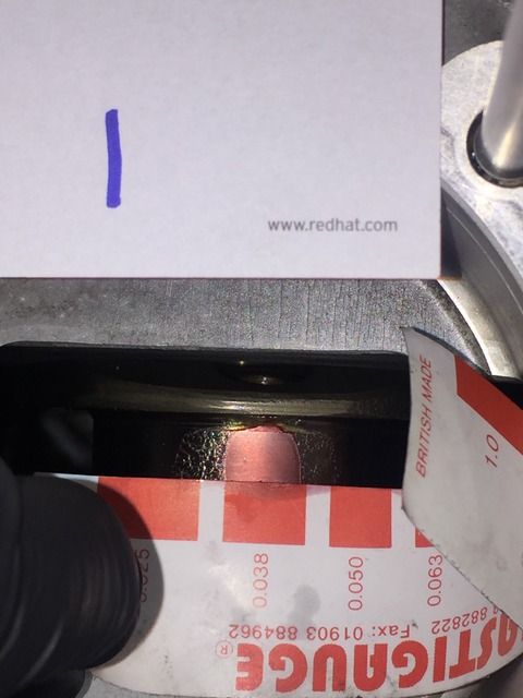

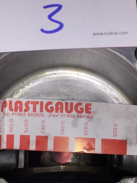

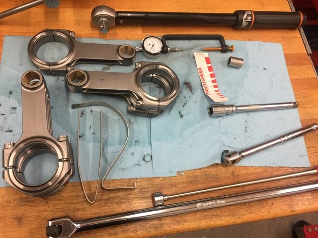

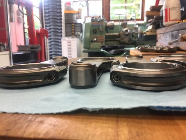

This weeks progress has been of the slow-but-careful type. Checking the rod clearances on the crank journals, full and thorough clean and then a build of #1 cylinder to check volume for CR calculations. There's been a bit of a hiccup as well, but that's now been overcome and we're good-to-go.
A thorough cleaning of the rods following the grinding work needed to balance them; of course I can't risk there being any grinding remnants in there. Somehow the tube of lube that came with the rods has gone AWOL (possibly sitting in Alex's workshop somewhere) but per Carrillos guidance on their install sheets, I'll mix some engine oil with some moly base grease to coat the threads and the undersides of the heads.
I don't have access to an accurate dial bore gauge to measure the ID of the rod BE's with the shells installed (nor do I have a 2"-3" digital micrometer to set up such a gauge...it's on the shopping list). But I do have plenty of Plastigauge. I consistently measured a fatter "spread" than the 0.050mm indication on each rod journal - not as large a clearance as the 0.038 patch, so I would guess that each rod is around the 0.045 mark. The Porsche spec is 0.030 - 0.088mm clearance, so I'm comfortably within the parameters - in fact, looking back at my build sheet from the first assembly, I'm running tighter clearances this time; the range of clearances on Build #1 were 0.059 - 0.066mm as measured on a dial bore gauge.
http://img.photobucket.com/albums/v2...d/IMG_1080.jpg
http://img.photobucket.com/albums/v2...d/IMG_1084.jpg

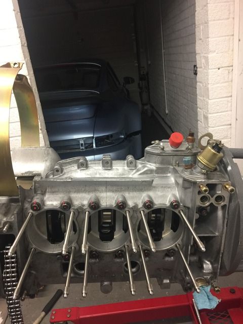

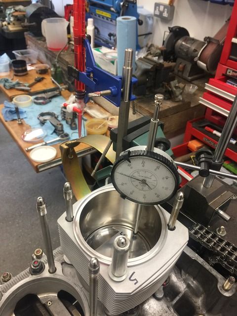

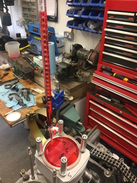

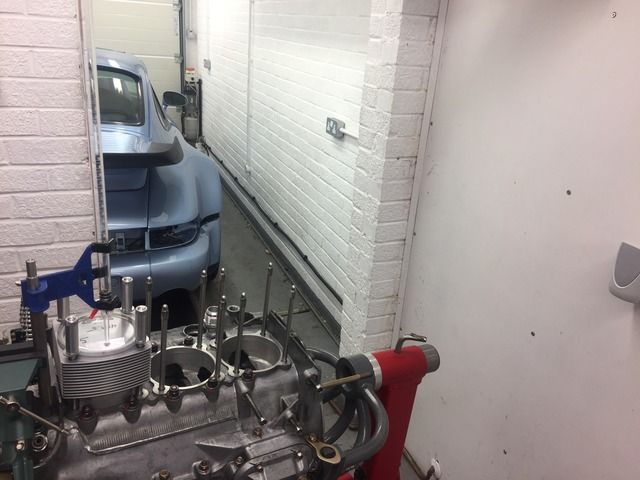

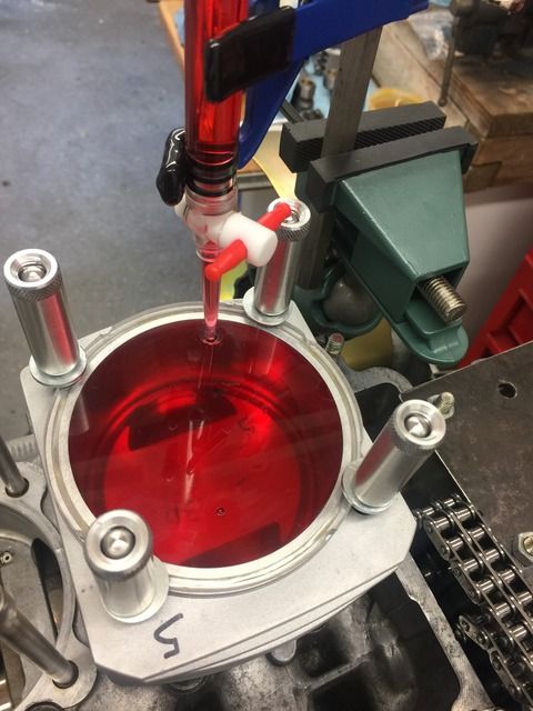

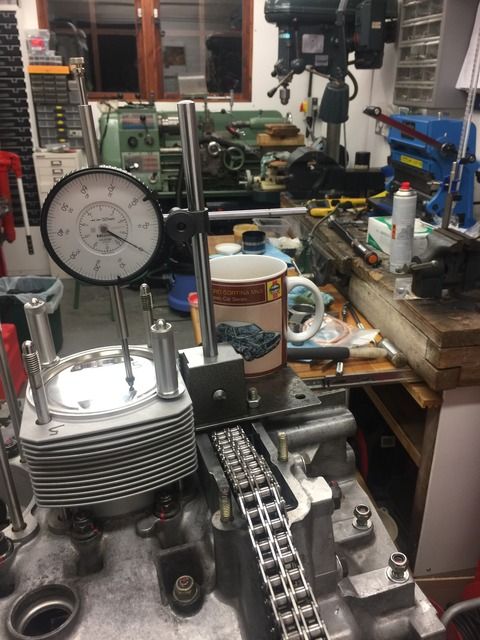

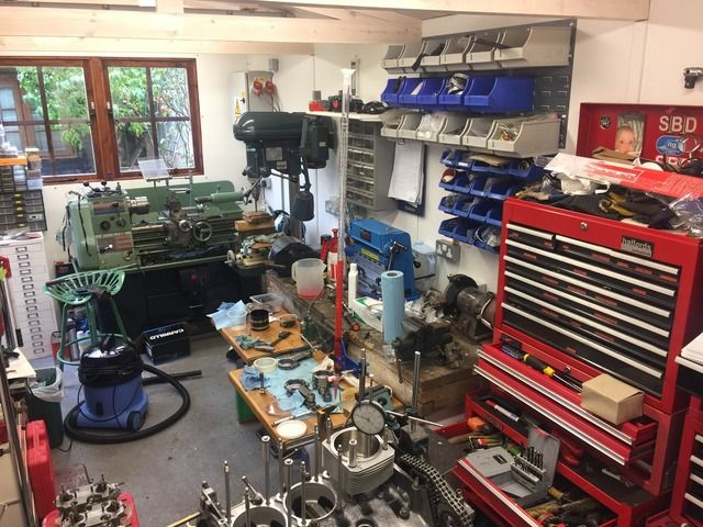

Todays job was to work out the compression ratio options. If you remember back, the cylinders were damaged en-route to LN Engineering by the couriers. Certainly nothing disastrous, it required a 0.1mm skim of the head mating surfaces to remove some marring. However, this in turn affected the channel depth for the fire-rings, which then affects the rings themselves.
So, the channels were re-cut by Chris's trusted machining shop once the repair work had been done by LN Engineering (they're all nice and round again!). At the same time, they made me a new set of fire rings, each one being custom to accommodate the ever-so-slight variation in the corresponding channels in the heads (...that were machined by the clown who screwed me over some years ago). The new rings are a little taller as well, and now made of a known grade material, so I feel a lot more comfortable that somebody who knows what they're doing, has now supplied the parts.
Back to volume checking....because of the mating surface skim, we now need to recover that deck height using the copper base gaskets. Chris supplied a number of different options in one of the shipments a few months ago, including some trick Viton coated pieces, at 0.30mm versus the stock 0.25mm.
After getting the engine stand wedged level and tilted slightly to get the intake pocket of the piston at the highest point, this morning was spent rigging up the burette. The piston needed dropping by 5mm so it sat below the deck. I had a cunning idea this time; I gave the underside of my perspex sheet a coating of Autoglym Silicon Resin polish, to try and lessen any surface tension of the liquid...and it worked really well!
TDC measurements....
http://img.photobucket.com/albums/v2...d/IMG_1125.jpg
http://img.photobucket.com/albums/v2...d/IMG_1132.jpg
http://img.photobucket.com/albums/v2...d/IMG_1133.jpg
BDC measurements...
http://img.photobucket.com/albums/v2...d/IMG_1135.jpg
http://img.photobucket.com/albums/v2...d/IMG_1136.jpg

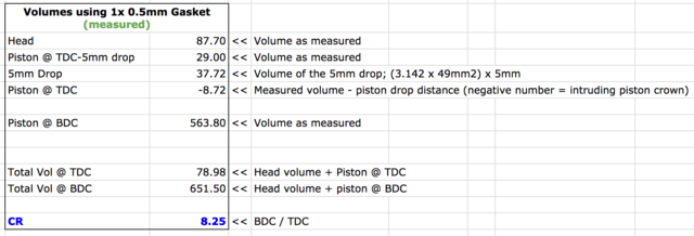

So, after an hour of back-and-forth topping up of the 50cc burette (12 fills required!), I had some numbers. This is with a 0.5mm base gasket installed >>>
Cylinder Head = 87.70cc
Cylinder Vol @ TDC-5mm = 29.00cc
5mm Drop = 37.72cc
Corrected Cylinder Vol @TDC = -8.72cc
Cylinder Vol @ BDC = 563.80cc
Plugging those numbers into a spreadsheet....
http://img.photobucket.com/albums/v2...2022.39.03.png

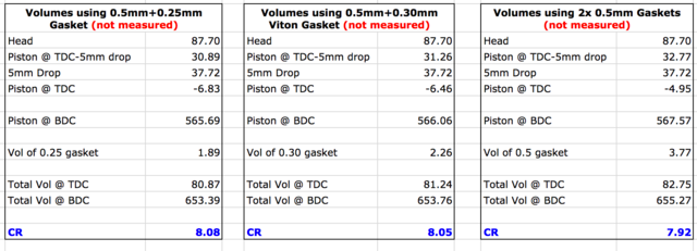

To try and reduce the CR, I can stack the 0.5mm with one of the other thickness gaskets....some calculated rather than measured musings...
http://img.photobucket.com/albums/v2...2022.44.32.png
If I'm honest, I'm not sure about stacking gaskets. If we end up reducing the CR to the lowest calculation of <8.0:1, then I may see if my local waterjet cutting company would be able to cut some out of stock 1mm copper sheet.
That's where I'm at, at the moment. Hoping to chat through with Chris later on, then getting on with the assembly itself.....ie., the bit that actually looks as though you've accomplished something! (contrary to the present situation...apart from turning the workshop on its head...
http://img.photobucket.com/albums/v2...d/IMG_1134.jpg

What deck height do you have? If you have a 1 mm deck I get a CR of 8.1 with your numbers. This is how PMNA calculates it:
1) Figure area of bore and divide by 1000
2) Measure volume of cylinder head. This is "Head CC" (A)
3) Write down final deck height
4) Drop piston enough to get dome below top of cylinder and write down the distance
5) Add item 3 to item 4
6) CC the cylinder and write down this number
7) Multiply item 5 by item 1
8) Subract item 6 from item 7. This is "Dome CC" (B)
9) Multiply item 1 by the crank stroke. This is "Swept CC" (C)
10) Multiply item 1 by item 3. This is the "Deck CC" (D)
11) Compression Ratio:
C + A + D - B divided by A + D - B
TurboKraft 10-23-2017 10:26 PM
Spencer -- this will be a helluva lot simpler if I pull the spec page on the pistons and tell you the exact piston dome volume, eh?
Then you only need cylinder head volume and piston deck height.
