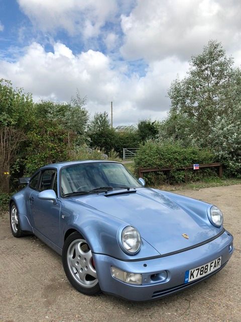

Hi Guys,

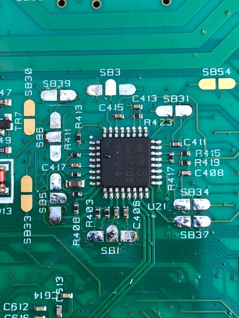

As-of yesterday evening, yes, some progress thanks. Sam went on vacation just as I came back from mine, so in the meantime I've been speaking with Syvecs in order to ensure that the changes needed on the mainboard of the ECU are what's needed to switch it from working with a Bosch sensor to an NTK. After some slightly contradictory advice, we've now got that nailed....
http://img.photobucket.com/albums/v2...d/IMG_4071.jpg
http://img.photobucket.com/albums/v2...d/IMG_4072.jpg

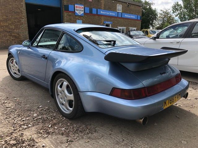

After getting back from another days diving on Saturday (PADI Rescue Diver course, great fun), I popped a brave pill and took the car out for a 30mile drive mid-evening with a mate and his "trade plates". Hopefully nice and quiet should there be any difficulties.
All's well, no oil leaks. A few rattles to sort out, not least of which is a buzzing from the front fuel pump. I checked this a few weeks ago, nothing obvious I could find, but I'll have another look; perhaps it's the cover thats vibrating on a fitting. I'm also going to switch back over to the stock 964T engine mounts from the 964RS mounts currently in there. I'm hearing too many noises and feeling vibrations that I don't remember from when the car was stock - it could be nothing to worry about and simply a function of harder mounts. There also appears to be a rumbling from the alternator or cooling fan, dammit....could do without that, now that we're only a fortnight away from dyno-day, with 500miles to get driven before then.
Yesterday was the day the car had been re-booked in for it's annual MoT test, and I have to say, I wasn't at all confident that it would pass the emissions test after I had observed the readings in the Syvecs SCal "dashboard"...but then I have very limited knowledge of such things and how to interpret it, so....
Well, as predicted, it didn't pass all of the emissions test; it DID pass the hydrocarbons element, but not CO2. Oh, and I also have a sidelight bulb blown.
http://img.photobucket.com/albums/v2...d/IMG_4101.jpg
http://img.photobucket.com/albums/v2...d/IMG_4100.jpg
So, coming back home, "kicking the cat" (metaphorically) and cueing up a few Plan B's (involving returning the ECU for a thorough diagnostics check and if required, a session up at Northampton Motorsport this weekend to really get to the bottom of it), I then touched-base with Sam in the evening. A quick video of what I was seeing on the Lam1 trace in SCal and he confirmed that it was absolutely working, just not very aggressively. Purely down to how he's set it up. At the time of typing, we're scheduled for another remote session this evening for him to rework the control calibration, and I'll go back and see if it then passes the test.

For various reasons, the remote-in session a couple of nights ago didn't happen. We did get a quick session in last night, and hallelujah, the Lambda sensor is at last working beautifully.

A call over to my pal this afternoon, and he had a spare 30mins to get a re-test done on the emissions. Because of the rush to get over there, in my haste I forgot to switch over to the "MoT calibration" once the car was in the workshop (what a dumbass), but...it still passed! So, I'm all legal, and able to now start driving it once we rig up the water cooling circuit.
We've identified that it could be marginal driving the fluid pump directly from a PWM output on the ECU; steady state current draw is fine, but the inrush on startup may pop the drive output. Same goes for the Spal cooling fan.....so we're going to stick on the safe side and eventually drive it via a relay. No speed control by doing so, but not really needed in this instance, just on/off @100% controlled by the ECT sensor that's in the circuit.
In order to just get up and running, and over to Simon to make the modification properly, I'm going to temporarily rig up a +VE feed from something like the rear screen heater, ignition switched but with control via the demister switch.
