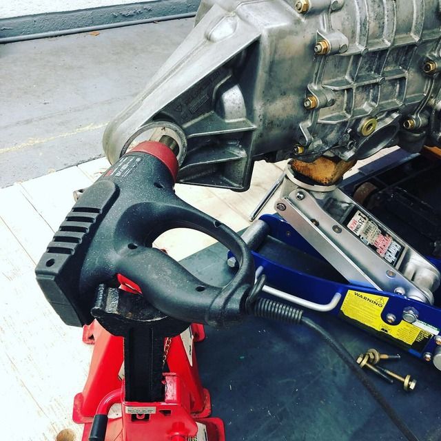

Back home, and it's time to put that theory to the test. Tonights job, undo the 6x transmission mount bolts, lower and support the trans away from the tub and see what it sounds like without it being mounted (aside from the front "crash" tie bars that bolt into the tunnel).
[drum roll]....after 5mins of warming the fluids, I gradually increased the revs to about 2,000-2,500-3,000 and no vibration. Hmm, looking good...Chris on a video link, big grins, and then time to bolt it back in for a back-to-back test. Two minutes later, fire up the engine and the vibration is there. GREAT!! Absolutely repeatable.
So now that I know what it is, I'll happily live with it. It was the not knowing and my extreme twitchiness after the failure of Engine v1.0 that was concerning me. Once the full calibration has been completed, the sensation won't actually be anywhere near as pronounced. This is because the break-in map I'm currently running has a deliberately slow rate of opening of the eGas throttle body, so naturally I'm spending more time in that rev "window" than I would be ordinarily.

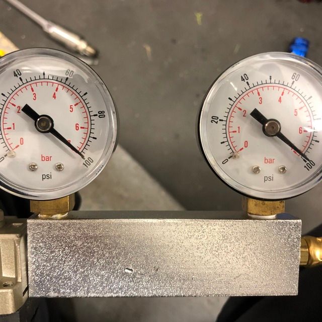

Next job, do a full leakdown test on each cylinder. Gulp....the test that conclusively proved that Engine v1.0 was broken. Very easy and quick test to perform, using 100psi of air. Good news, all cylinders showing between 1-2% leak....
http://img.photobucket.com/albums/v2...G_5284%203.jpg

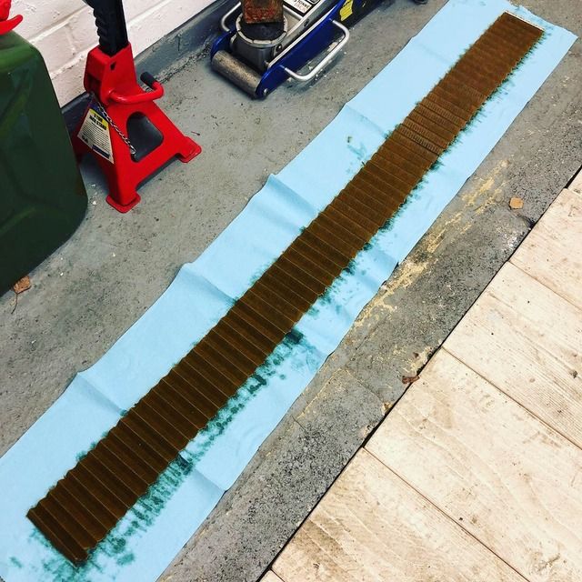

Finally, another oil filter swap. I didn't have anything clean enough to catch the oil when removing the engine (and somehow don't feel comfortable pouring back used oil, albeit less than 200 miles old). Unfortunately this meant another £140 in oil plus another filter, but, I've now really diluted any remaining break-in oil that was left in the oil cooler circuit from oil swap #1 a few weeks ago, so all's good. I opened up the filter again, removed the element and spread it out looking for any horrors. None there, filter very clean. Phew.
http://img.photobucket.com/albums/v2...d/IMG_5274.jpg
http://img.photobucket.com/albums/v2...d/IMG_5275.jpg

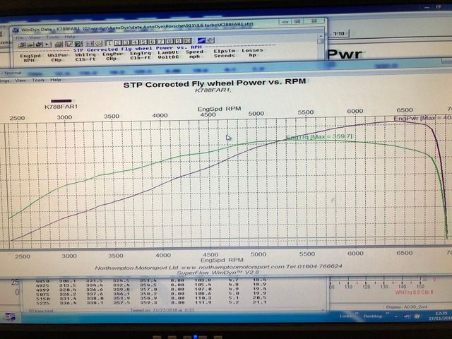

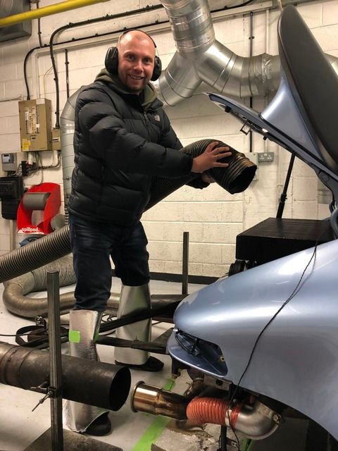

Well, as you may have guessed, the news isn't great. The dyno-day up at Northampton Motorsport took place; I travelled up the day before so that I could a) meet some of my Customers who are about 3miles down the road, and then b) remove the rear bumper in readiness for getting the car onto the rollers first-thing in the morning. (we removed the bumper as a precautionary measure, to prevent any heat damage, but it actually proved useful in other ways...)
The car made it up to Northants just fine - it's the single longest drive I've ever done in the car, even when it was running CIS! There's nothing like a 150mile journey on one some of Europes busiest motorways (the dreaded M25 and the M1) to get you crossing your fingers and praying to the Petrol Gods!
All good so far......the next day I arrived bright and early, we got the car strapped down, hooked up with an auxiliary knock detector...
http://img.photobucket.com/albums/v2...d/IMG_5460.jpg

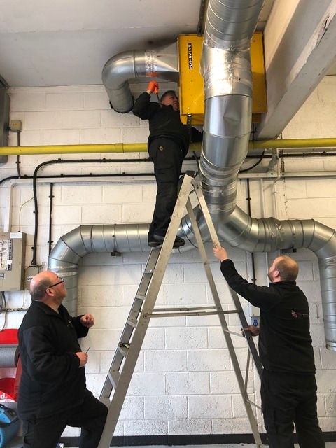

....and then was rudely interrupted by a visit from the Health & Safety inspector. Upon activating the half of the dyno cell extraction system that never normally gets used, an errant piece of heat protection matting then got sucked up into the fan 20ft up in the air, and stalled the fan. Some grim faces from the NMS guys, followed by an hour delay to dismantle and clear the blockage. Thankfully the fan didn't burn out, and we resumed shortly after. Phew. I'm sure that's the last thing Troy and Steve wanted to have happen on the day, it's just one of those things, absolutely no harm done (and a little bit of ribbing along the way!)
http://img.photobucket.com/albums/v2...d/IMG_5456.jpg
So, the engine warmed up, telemetry all set up and ready to do the first run of the day...
<iframe width="560" height="315" src="https://www.youtube.com/embed/WwI98CupPWc" frameborder="0" allow="accelerometer; autoplay; encrypted-media; gyroscope; picture-in-picture" allowfullscreen></iframe>

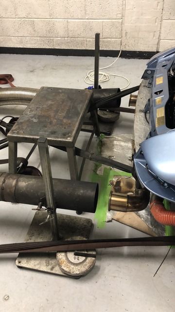

This was more of an exploratory run; at this stage we hadn't set up a cooling hose to the intercooler, but despite this, at 0.7bar boost it made 409hp & 359lb/ft with very conservative ignition timing.
http://img.photobucket.com/albums/v2...d/IMG_5465.jpg
Next job was for me to be a crash-test-dummy and stand behind the car with the hose aimed at the IC...
http://img.photobucket.com/albums/v2...d/IMG_5482.jpg
And after I practically melted my trainers, we then got the special stool ;) ...
https://img.photobucket.com/albums/v...6F489C815C.jpg
All along the way, Troy was constantly tweaking the calibration, taking stuff out, adding stuff in and making it a nicer, smoother engine to drive on the road. More of this later.
Next job was to wind the boost up to our theoretical max, and see what she does. So 1.4bar, and....Not. That. Much. Only 425hp, but again running very safe ignition timing. Along the way, however, some observations were made....
1) The vibration I had felt all-along was still very much there. The transmission mount wasn't the source, it was merely amplifying something else. This concerned Troy greatly (and me, of course), as he said that it felt like an "unwilling" engine. His comment was that "for a reasonably large capacity, 6-cyl turbocharged engine, it should be extremely smooth...but it isn't...it feels reluctant to rev cleanly". He perfectly described it as a harmonic.
2) For some reason, the fuelling compensation required at idle was massive. The Syvecs does a great job of auto-compensating and masking this issue, but when you observe the live compensation, instead of being +/-2-3% (typically), at best we were seeing 5% but at worst, after doing a run on the rollers, it was as much as +/-30%! It should be the simplest thing to set up and leave, but instead it required constant tweaking.
In a bid to try and rectify, we checked a few things out. Could it be the Lambda sensor? ("oh no, not the Lambda again!!!") Well, Troy and the guys are big fans of the commercial off-the-shelf NTK sensor, but to see what's what, we installed their calibrated lab grade NTK probe into the system (hence a good job that we removed the rear bumper). It did read ever-so-slightly different, but nothing that was unusual. We then welded on a second Lambda boss, so we could install the two probes adjacent to each other. Any difference we did see was consistent across the run, and could be compensated for with a trim map. But we proved the probe I was using was indeed functioning correctly.
As always, Chris was extremely helpful, as we called him a few times to bounce ideas off of him (Northampton Motorsport aren't Porsche specialists, but they have done a number of high profile air cooled 911's). Of course, always a difficult ask to try and remotely diagnose problems from 5,000 miles away, but certainly very useful nonetheless. Thanks Chris!
After discussion, and checking that the ignition baseline was as we expected (not a case of the advance angle being added to an existing offset), we then dialled in more ignition advance. This proved a little more successful but still nowhere near where we'd expect to be. We eventually got it to 525hp & 521lb/ft but that was with borderline detonation, so of course, absolutely not a safe state of tune to run with. As a reminder, "Engine v1.0" made 544hp 3yrs ago, so clearly not a good result.
http://img.photobucket.com/albums/v2...1164D0D996.jpg
Next check was ignition...Time to get the timing light out and make sure everything is firing correctly. All cylinders and top/bottom plugs appeared to be firing, and in the correct order.
By this time the day is really getting on, from memory it was about 9pm and the intake system is now in pieces (to access the CoP's), and the bumper is still removed. A decision was made to run with the safe 409hp calibration, in order for me to drive the car home that night. In the end, I left I left Northampton Motorsport at 10.30 that evening.
As a side note, it also sounds like my front Bosch 044 fuel pump is about to expire. I thought it was perhaps vibrating against the access cover or the chassis, but upon checking it, it isn't...but it is making a horrid coarse vibrating noise. Likely a bearing about to seize.
Immensely frustrating to not come home with a fully tuned, big horsepower number. But at the back of my mind, I wasn't entirely surprised when I still heard that harmonic after swapping the transmission mount. I kind of knew something wasn't right.
A three hour drive back home gave me plenty of time to think....firstly the positives...
1) It drives beautifully now....significantly different from the running-in (break in) calibration. Troy has done a superb job of taking Sams initial calibration and tweaking it for road use. No more horrible kangaroo'ing with light throttle and low speed. No more stalling when reversing up a very slight incline (ie. the entrance to my garage). It also starts perfectly from stone-cold. Previously it would always stall the first time after about 3-5secs, then fire and idle on the second start. Not the end of the world, but niggling nonetheless.
2) Despite the roads being treacherously wet on the way home, you could feel that even with a pathetic 409hp, it felt mightily strong, some really nice low down torque. I didn't get anywhere near 65-75% throttle, just too risky for the road conditions...but it still felt entertaining.
Laying in bed that night I had a lightbulb "eureka" thought. When the intake system was apart to check the ignition, we noticed that there was a lot of steam vapour coming from the dry sump tank breather system. If you remember (probably not), I over-engineered a catch-tank arrangement to try and replicate what the Factory did on the stock engine (feed the breather hose into the air box, pre-filter side). With my setup, the tanks breather hose enters into an air/oil separator tank. The output hose from this tank then feeds into the inlet tract (after the foam air filter) to the turbo. I wanted to keep the engine bay clean, no oil vapour floating about....but of course, this hot, dirty, oily air can only serve one purpose...reducing the effective octane level of the intake. No WONDER we couldn't add more ignition advance, it was probably the equivalent of running donkey fuel sourced from the middle of Mongolia!
It also probably explains why the huge amount of fuel compensation was required after a dyno run....of course, the oil being returned to the tank is way hotter than at idle, and is being pumped at a higher rate, therefore far more dirty oil breathing is happening, therefore really contaminated air being sucked into the engine....at least until a good few minutes later once everything stabilises again (and then the fuel trim returned back to 5-10%, with just the mildly contaminated air!)
