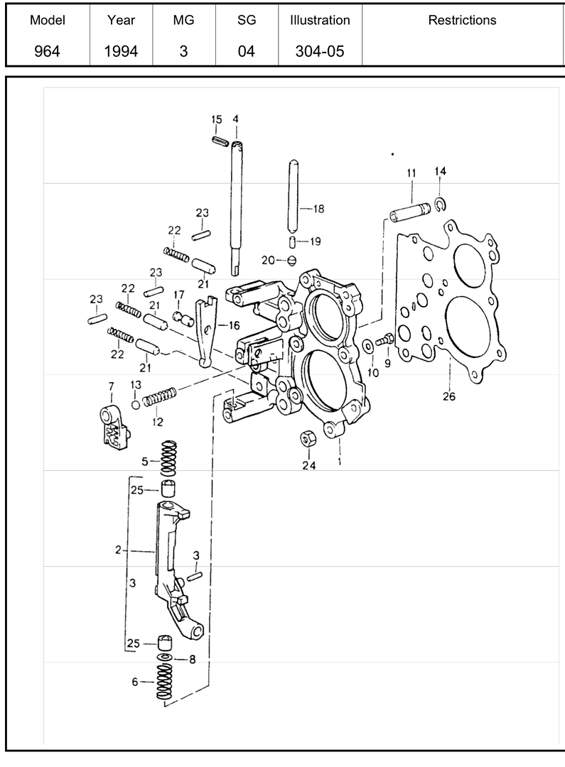

If anyone here has experience of this, please let me know asap...a new plate (Item 1) (>$700, likely the same in GBP) is about to be ordered from Germany.
http://img.photobucket.com/albums/v2...2021.42.01.png
Both the 4-point bearings I think are in UK stock; hoping these are Items 15 and 24...in which case they're the slightly cheaper ones, £307 + VAT & £142 + VAT respectively. Not going to skimp on trying to source pattern parts, genuine all the way for this exercise. Just hoping that the other pair of bearings aren't also needed (#16, #23), they're £427 & £410 respectively! Also, no word yet on condition of the synchros, but I can feel slight notchiness on 2nd-3rd shifts, so am anticipating this will need attention as well.

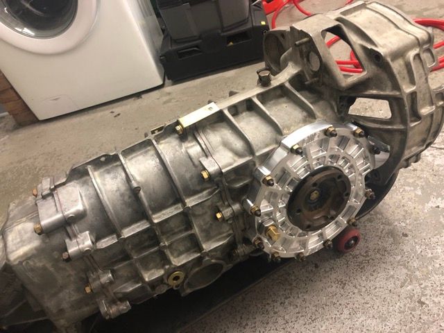

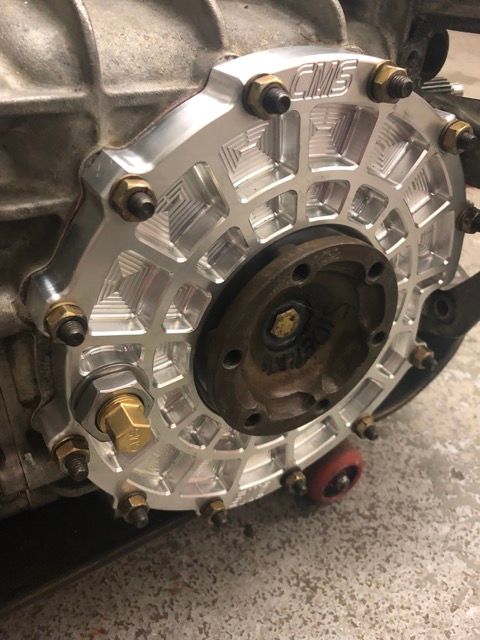

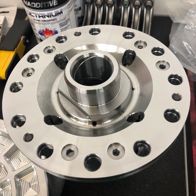

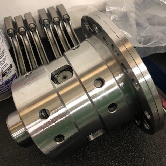

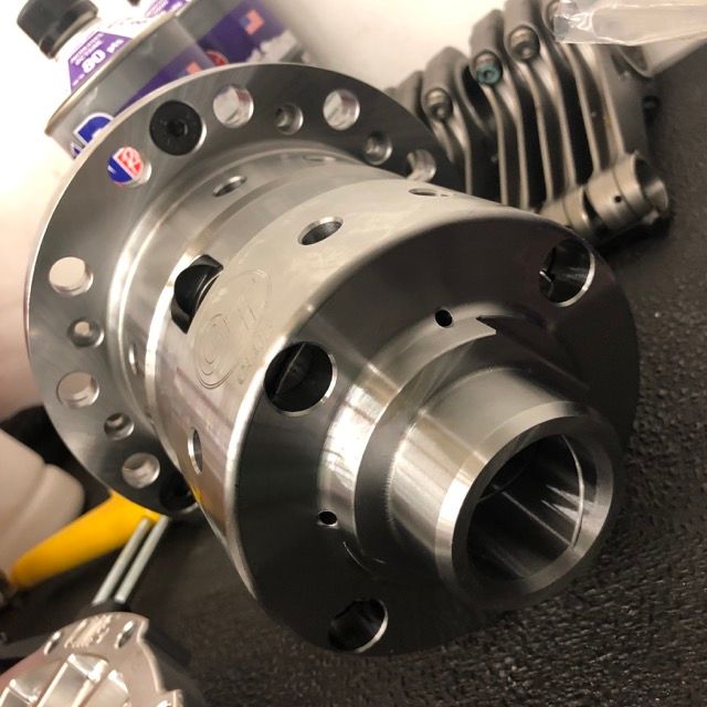

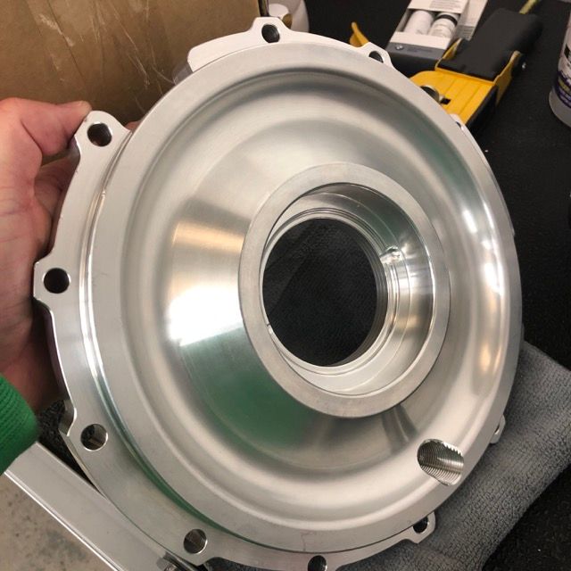

At the point of getting the news and costs for the transmission rebuild, I thought I had been dealt a "get-out-of-jail" card, so thought it was time for an upgrade. Something that I started researching many years ago (before I even bought this car, and was just hunting for one) was the upgrade to a Guard differential. I dug out an email from 10yrs previous (yes really) that I wrote to Matt Monson, seeking guidance. I bet he had a "WTH??!" moment when he received a reply with a continuing conversation!
Chatting through the options with him on the phone, we decided that a Clubsport spec LSD would be perfect for my use case, but me being me, I also decided to order the billet diff cover, as it's not unknown for the stock cast item to shatter, albeit usually under extreme conditions with slick tyres, but anyway, never let these details get in the way of an upgrade purchase.
As things were progressing quickly, the transmission was over with the rebuilders, and it absolutely made sense to get the diff installed at the same time rather than doing it later. So we got it expedited from Guard to Fearnsport within a couple of days. Thanks to Matt for sorting that out. I went up to Silverstone a few days later for other reasons (more on that shortly), but snapped a couple of photos of the new toys....
https://img.photobucket.com/albums/v...d/IMG_6041.jpg
https://img.photobucket.com/albums/v...d/IMG_6045.jpg
https://img.photobucket.com/albums/v...d/IMG_6046.jpg
https://img.photobucket.com/albums/v...d/IMG_6042.jpg
https://img.photobucket.com/albums/v...d/IMG_6043.jpg
I think you'll agree, it does look very nice and "trick". Looking forward to many years of a far more focussed differential, rather than the [as Matt called it] "litigation special" ZF diff that the factory installed. From what I understand, it was nether Porsches nor ZF's finest piece of work, being a very fragile effort and reverting to an open diff if you dared speak to it in a harsh tone. Not cheap to rebuild either.

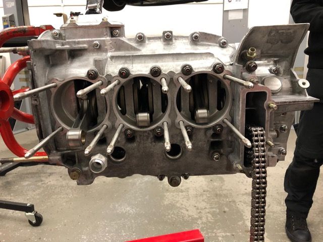

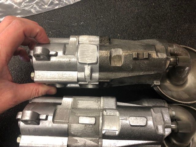

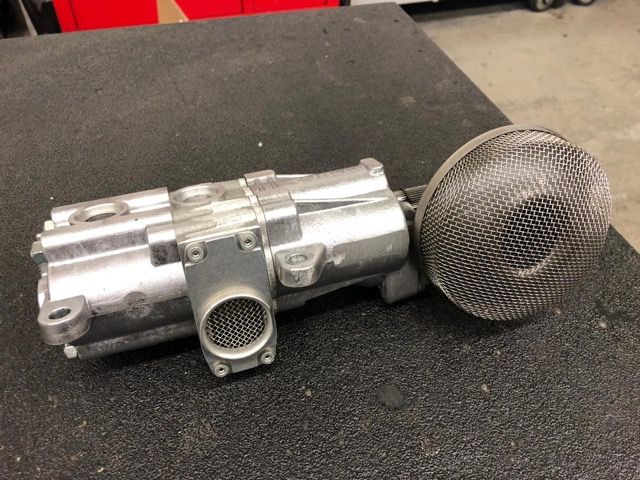

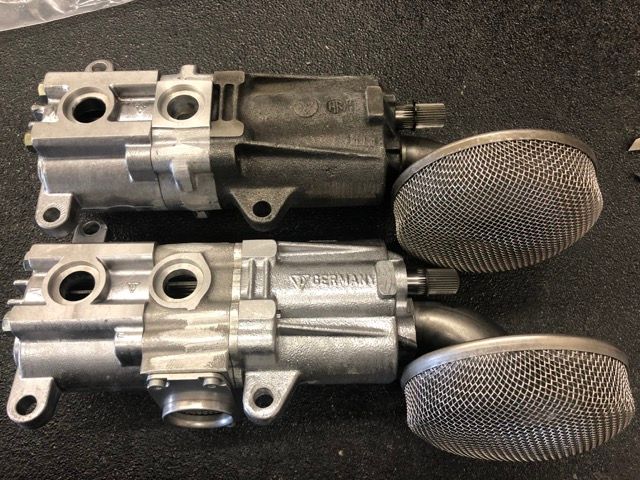

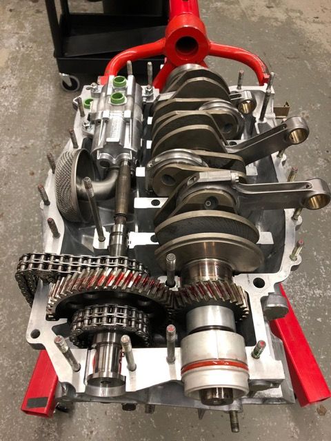

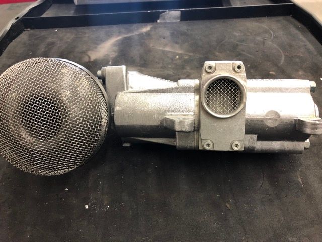

If you stretch your collective memory back to a few years ago when rebuild #2 was being done, I didn't actually strip the crankcase again, only the mid and top sections. I kind of always regretted not doing so, it went against my mantra of doing things properly, so I did take this opportunity to ask Matt to completely strip it, re-check crank journals and bearings, as well as being really really sure that my work to clearance the oil pump for the Carillo rods was sufficient.
And then he had a cunning idea. It just so happened that Matt had available to him a factory RSR oil pump, virtually new.
https://img.photobucket.com/albums/v...d/IMG_6092.jpg
https://img.photobucket.com/albums/v...d/IMG_6213.jpg
https://img.photobucket.com/albums/v...d/IMG_6237.jpg
https://img.photobucket.com/albums/v...d/IMG_6238.jpg

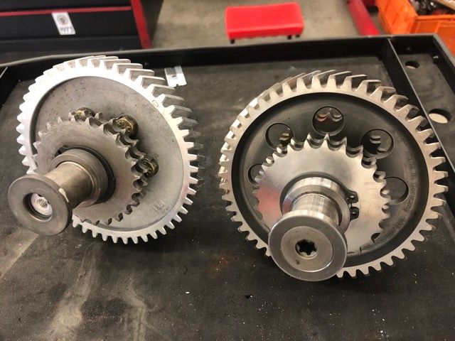

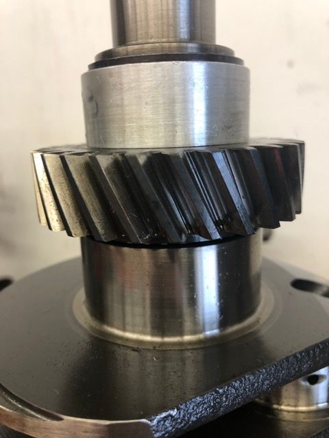

He also had what he assumed was a GT3 intermediate shaft. The difference with this particular unit is that it’s a single piece, in steel of course; the one I’ve been using is a steel arbour with an aluminium driven gear bolted onto it. Apparently Porsche moved away from this design on the later GT3’s as it had been known that the ally gear had vibrated loose.
https://img.photobucket.com/albums/v...d/IMG_6217.jpg
https://img.photobucket.com/albums/v...d/IMG_6224.jpg
Now, the slight unknown, because Matt hadn’t built these items into a 930 derived crankcase before, was whether the pump and I.S. would line up correctly with the I.S. drive gear on the stock 964 Turbo crank. A few minutes spent mocking it up, and it worked just fine! The only mods needed were to clearance a couple of the ribs on the inside of the crankcase for the pump to sit in there.
At this point, Matt went a-delving through the PET to find exactly which model GT3 used the part we had in our hands….hah…it turns out it’s no common-or-garden GT3 or even GT3RS…or even GT3RS 4.0….it’s a GT3 Cup car item, only listed in their Motorsport catalogue! Of course, you fit the shaft and its drive gear as a gear pair, so the old distributor worm drive gear was removed, new I.S drive gear fitted, and the corresponding ally spacer slipped on.
The crank journals were measured by one of the nearby F1/WEC supplying manufacturers, and were all in tolerance, so a new set of genuine Porsche shells ordered and fitted. Read:"reassuringly expensive". In fact, Matt will only use genuine Porsche part numbered parts, be that bearings, gaskets sets, fasteners.
So, I now have something akin to a “Works” bottom end…apart from the crank of course….

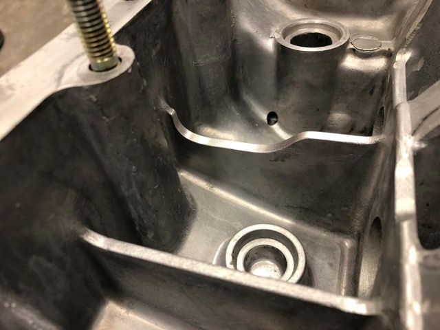

Spenny_b 06-25-2019 05:40 PM

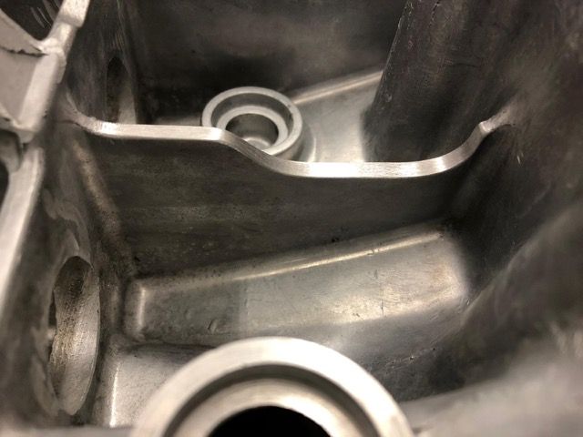

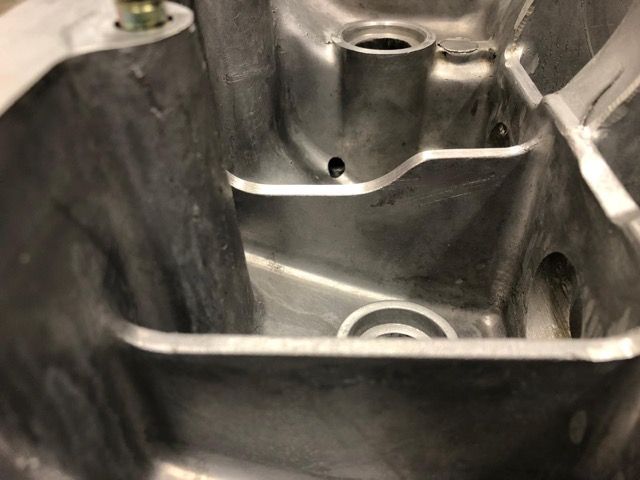

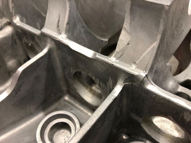

We did discuss boat-tailing the crankcase webs, but like me, he’s not a fan and would rather leave the material in the castings. Besides, with an oil pump with dual suction pickups, it should scavenge far harder than a stock pump, therefore oil windage becomes less of an issue.
https://img.photobucket.com/albums/v...2-13-52-46.jpg
https://img.photobucket.com/albums/v...2-13-52-45.jpg
https://img.photobucket.com/albums/v...-52-45%204.jpg
https://img.photobucket.com/albums/v...-52-45%203.jpg
https://img.photobucket.com/albums/v...-52-45%202.jpg
https://img.photobucket.com/albums/v...2-13-52-41.jpg
