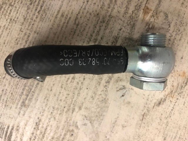

The plan was to refit the CIS pump from 8yrs ago, so long as it worked fine and hadn't seized with any remnant fuel doing what fuel does after a long period. Some testing on a few litres of super unleaded proved it was just fine....
<iframe width="560" height="315" src="https://www.youtube.com/embed/Qudaak3tBCY" frameborder="0" allow="accelerometer; autoplay; encrypted-media; gyroscope; picture-in-picture" allowfullscreen></iframe>
However.....after removing the passenger seat to remove the section of wiring harness, I thought "ah what the hell, the weathers lovely, I'm going over to Rachels house, I'll put some more fuel in and use the Porsche"....well, you would, wouldn't you. So, seat back in, the small qty of fuel I bought for testing was put into the tank (after checking for any obvious particles in the jug, of course) and I drove 100yds down the road to my local fuel station. Just a little family run affair (important point). £20 more of SUL into the tank and I was off. Except the car felt like a bag of spanners and my heart sank.
Maybe I'd fouled a plug with the 2 starts earlier in the day, to move the car around? I gave it 5-6 miles before deciding to turn back. Not plugs. Had I messed something up with removing the harness? A feed to a bank of coils perhaps? Or water in the fuel? (seen that before on a mates car in the middle of rural France)....or was this something far more serious; broken rocker shaft....cam timing slip...holed piston....?
Circling back to the fuel station to ask about possible water in their tanks, and a quick printout showed 0% for all 6 underground tanks, but the attendant did say that the reason their price for SUL was so high (25% more than other stations) was because they just don't sell enough to give them buying power. Huh. Soooo.....when they do occasionally buy in the SUL, I guess they're topping off fuel that has potentially gone stale?
The next day I replaced the harness exactly as it was (not a simple plug/socket, but some spliced-in +Ve feeds for relay power). The next test drive was even worse, with proper popping and banging, not just a missing cylinder sensation. Uh-oh....well...not the wiring I guess.
Time to completely drain the £25 of SUL from the tank, do the CIS pump swap, refill with known good fuel (99RON) and re-try. And hope.

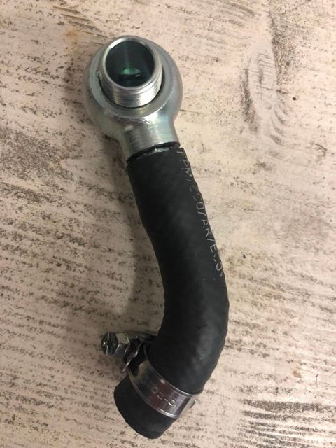

Now, on the fuel pump side of things, I needed to buy a new tank>pump hose; or rather, another hose, as I bought one a few years ago that I chopped in order to feed the 044 pump via a banjo fitting....
https://img.photobucket.com/albums/v...d/IMG_6858.jpg
https://img.photobucket.com/albums/v...d/IMG_6857.jpg
https://img.photobucket.com/albums/v...d/IMG_6859.jpg
And then it dawned on me….is it possible that 044’s don’t like banjo fittings on the inlet side, and the fuel flow that happens with them? Was this the noise I’m hearing? The CIS pump has an integrated fuel inlet, not a screw-in fitting requirement. However, the surface area of the 4x banjo bolt holes should’ve been ample for the pump feed….I think…Anyway, a few hours later, new hose on the tank, CIS pump back on and the -6 banjo on the outlet side feeding the engine.
New fuel in there and magically the misfiring has disappeared. Cue the elated-car-driving-and-jigging. Most of the cavitating noise has gone, its certainly a lot quieter (and now tolerable) but not gone entirely, which is still baffling me. The CIS pump from factory feeds into a banjo fitting that in turn feeds the injection distributor, so it’s not like I’ve swapped from a straight fitting to a banjo on the outlet….
Oh well….lesson learnt….don’t use my local fuel station again with their sub-standard 97RON fuel. Perhaps it wouldn’t have been a problem in a few weeks time, once the proper calibration has been put into the ECU. I’m wondering whether the REALLY conservative ignition advance curves that I’m running aren’t aggressive enough to burn the lower grade, perhaps slightly stale fuel?

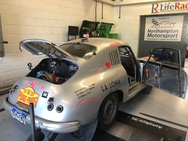

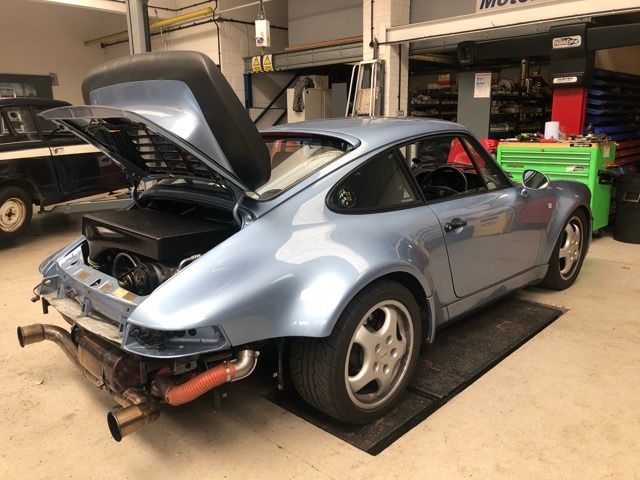

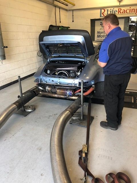

My session was booked in for a 1pm start, so after the bumper came off I decided to also check the top 6 plugs, “just in case”. Not the easiest job but all was good.
https://img.photobucket.com/albums/v...t/IMG_7090.jpg
https://img.photobucket.com/albums/v...FE837989C6.jpg
Car strapped down and everything just-so, it was time to fire up the old girl, and for Troy to starting examining the calibration and make some changes. A good number of light runs, checking driveability and making sure everything’s good before then doing some power runs. I should point out that we had a few very nice days of weather, ambient outside temps were mid to high 20’s, whereas the dyno room was up to 30 degs after some light runs and idling. Their doors have to remain shut for noise reasons, so it gets pretty hot in there despite having a pair of big ventilation fans/ducts piping in fresh air.
https://img.photobucket.com/albums/v...A05B7FEEFF.jpg

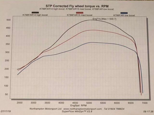

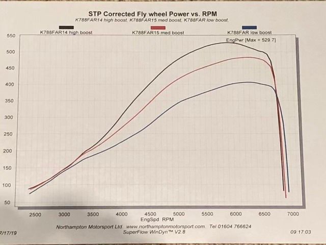

The initial power runs were done using high boost but very conservative ignition settings. As a safety measure, Troy then hooked up another knock sensor, a third one in addition to the two on the engine. Some time spent teaching the Syvecs what is noise versus what it needs to listen out for (i.e., profiling) was then done before going again for some power runs. A quick consultation with “our man in AZ” (thanks Chris!) to get an independent view on the ignition window that we should be expecting, and it absolutely confirmed what Troy was seeing, and was consistent with what he’d done before on a 993 GT Evo.
One of the first full boost power runs, albeit I think this was with conservative ignition advance, so just under the 500hp mark iirc.>>
<iframe width="560" height="315" src="https://www.youtube.com/embed/CJgLy0jUfKg" frameborder="0" allow="accelerometer; autoplay; encrypted-media; gyroscope; picture-in-picture" allowfullscreen></iframe>
A later full boost power run, 1.4bar with full ignition advance, 530hp and a discrete nod of approval from Troy, lol >>
<iframe width="560" height="315" src="https://www.youtube.com/embed/znIPi4zr-Lw" frameborder="0" allow="accelerometer; autoplay; encrypted-media; gyroscope; picture-in-picture" allowfullscreen></iframe>
Long story short, we made 529.7hp (corrected) at the crank, with 500lb/ft of torque @ 1.4bar and 30ºC ambient. Troy was happy with this, and reluctant to push further on the basis that he wanted this to be a VERY safe tune, not a hint of knock and with plenty of safety margin in there to accommodate “something” potentially failing later down the line. Matt at Fearnsport said all along “Spence, this is a solid 530hp build”, and so I was happy to agree with the plan, although I can’t deny I was hoping for more than Engine #1 (which made 544hp), so a little underwhelmed (keep reading… ;) ).
BUT…far more important that we have a successful day, no dramas and something that I can enjoy. Let’s remind ourselves of the M.O. from the very first post in this thread – nothing bleeding-edge or risky, and it’s a road-going hotrod.
Two further maps programmed in, one for 0.7bar and a middle tune for 1.0bar. A road test later with Troy sat in the passenger seat with laptop. I was driving along a stretch of dual carriageway out of town, nail the throttle and then question Troy with “is this running 1.4bar?”. I think he was busy doing other tweaks at the time, and gave me a “yep, it is” reply. Hmmmm. Now I’m underwhelmed. It’s certainly smooth….very smooth, way better than the running in map….but it’s not feeling like 530hp. I know we’re heavy, two passengers, a frunk full of tools and “stuff”, but even so. By my reckoning it should feel similar to my M5…..that’s 562hp officially, although always reckon to come in at about 580hp and of course heavier. Similar power-to-weight, Shirley? My arse-dyno is either letting me down or….
I leave the car in the Northampton Motorsports workshops, as there’s no time left to refit the bumper and drive home. Frankly, I wasn’t feeling like driving 3.5hrs back either, far too tired. Another night in a hotel, then resume in the morning and get home during the day. Once in my room, Costa and I had a video call, and I think he could tell I was a little disappointed. On the other hand, there’s no significant changes in the build that SHOULD’VE justified another 40-50hp….better injectors, steel rods, better oil pump, better intermediate shaft and lot better management system, but no improvements in gas flow or thermal management, so why would I expect to get more bhp?! In fact, slightly lower CR this time around....so I think that the 14hp delta between Engine #1 (5yrs ago) and Engine #3 last week can probably be explained thus:
1) Different testing facility, therefore different calibration
2) The engine was in an engine dyno cell…out of the chassis….lots of cold fed air in the room and a shroud atop the intercooler with force fed air evenly cooling it. The rolling road was at an ambient of 30degs at best.
3) Rolling road versus crank attached dyno, therefore calculating transmission/drivetrain loss on the rollers is just that, a calculation.
But, the engine dyno isn’t at all representative of the real-world, especially with our engines, their extreme heat build up and the out-of-the-airflow installation location.
So…530hp. Troy did say “we’re not a “Quote-You-Happy” dyno facility, no BS numbers, it is what it is”.

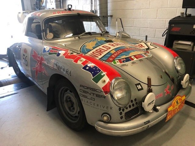

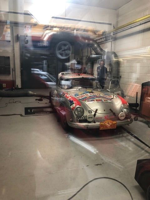

The next day I head back to NMS to refit the bumper and lights; Their first customer of the day? None other than Francis Tuthill himself….
https://img.photobucket.com/albums/v...t/IMG_7106.jpg
….with a very nice 356 that had just come back from the London > Peking rally. There’s a funny story that Mr Tuthill was telling us, which I won’t go into detail on here, suffice to say that he wanted this latest engine dyno checked to see how strong it was, after he was flown out to St Petersburg with suitcases full of new engine, to build and install out there so they could finish the rally!
https://img.photobucket.com/albums/v...t/IMG_7108.jpg
https://img.photobucket.com/albums/v...t/IMG_7107.jpg

Some graphs - not the best quality, just photos of the printouts - I'll scan them in tomorrow and re-upload.....
Power >>
https://img.photobucket.com/albums/v...t/IMG_7146.jpg
Torque >>
https://img.photobucket.com/albums/v...t/IMG_7147.jpg
