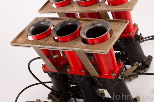

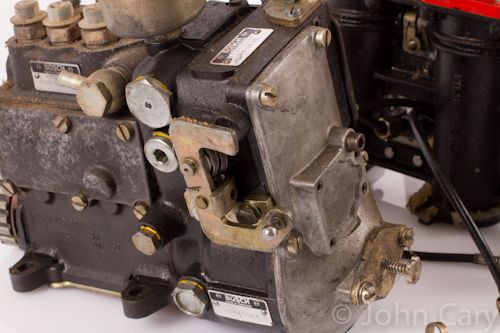

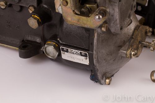

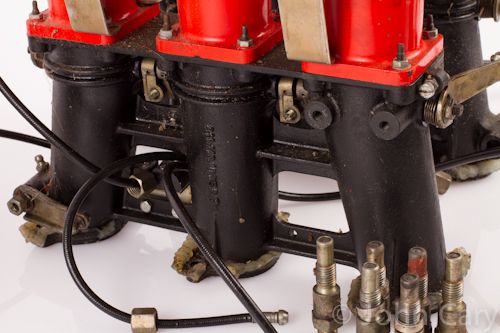

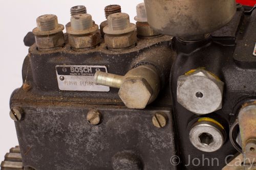

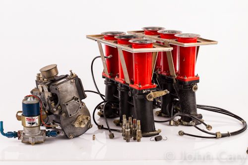

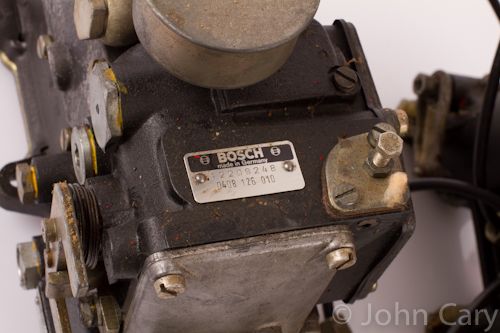

Over the weekend I picked up the twin plug heads from TLG and did some cleaning on the High Butterfly MFI system. Can someone help me determine the system based off the numbers found on the throttle body?
Old 08-05-2013, 10:21 AM
356RS's Avatar
Location: Bend, Oregon
Posts: 2,334
The high butterfly casting number 911.110.107.5R indicates a 2.8 - 3.0 RSR's. Both the 2.8 & 3.0 had 43mm to 43.5mm ports with a 50mm top opening. The ST high butterfly had the casting number 911.110.107.2R and had 41mm to 41.5mm ports also with a 50mm top opening.
What a difference the heads are now after seeing the first photos of them. They look great after a good cleaning and valve job. Casting numbers 911.104.307.0R with the 1819h marking on the heads indicate there early 72S heads.
