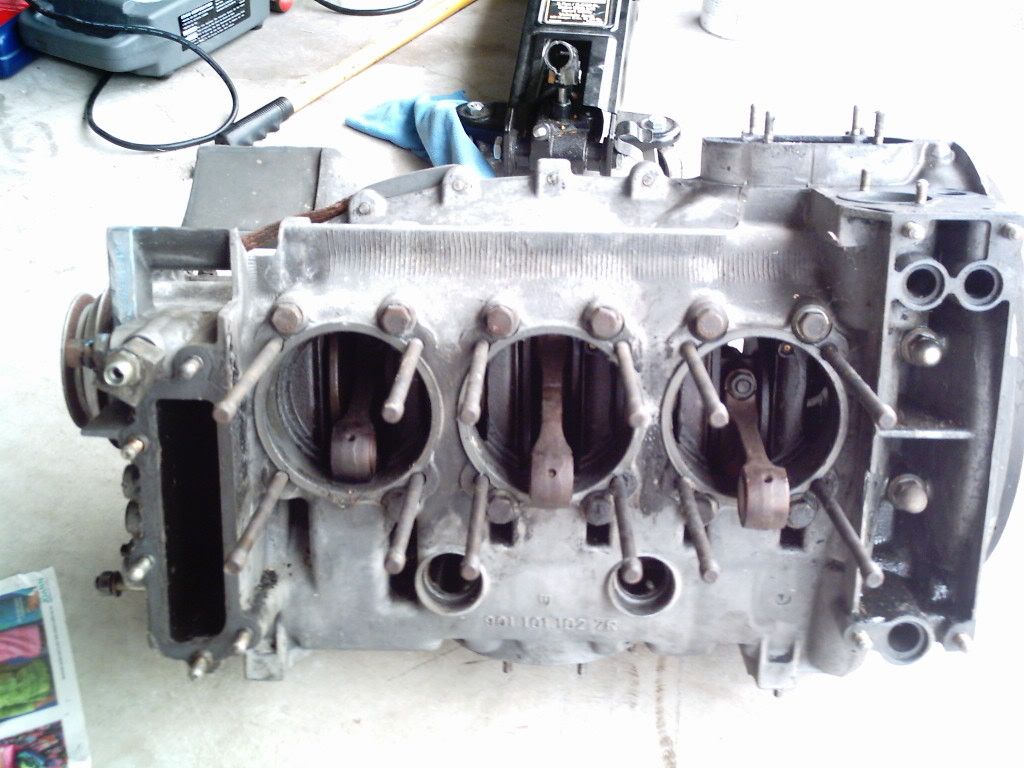

Just got more bad news about my ever growing list of engine teardown discoveries. My car is a 1981 sc.
After removing 1,2 and 3 cylinder heads, it looks like the rebuild done in 1997 (I just bought this, my first Porsche) replaced the head studs but re-bored the threads crooked on a couple! Too much material missing adjacent to the cylinders too so a re-bore looks way too risky, in fact, one of the cylinders has a small perforation in its wall about 1" from top opening. The crooked studs were actually bent in order to fit the reinstalled heads! One of them is now pulled through completely.
Not exactly what I was hoping for when I finally pulled the trigger on a car like this, but that's what I got and I have to deal with it. Yes, I did a P.P.I by a reputable PCA mechanic too...
Question now for anyone out there is what should I do now? Used case? Used engine? two month bender?
I would really appreciate some insight. BTW, I am in So. Arizona...

Bill,
I'm very sorry to hear of your misfortune here. Its tough to spot these issues in the average PPI due to time and customer budgetary constraints. I've seen this problem before and I simply cringe when seeing the result of "shade-tree mechaniking".
I think the best way forward here is to either source a GOOD used SC/Turbo case or perhaps a decent complete 3.0 core engine for parts and sell off what you won't need when the job is completed & running.
I'd postpone the bender until its all running well once again and give you good cause for celebration.

Ahh, hurts my eyes to see such a damage on otherwise good case.
I may be totally wrong here but wouldn't heli-coil or timesert work in this case? or is it too little meat there?

While open to all second, third and fourth opinions, my mechanic is pretty adamant about your "not enough meat" assumption. I would love to be pleasantly surprised but I am not holding my breath.

Ok, my opinion was purely based on the fact that 2.7 mag cases have equally small amount of meat between head stud and spigot but case-savers, tim-serts really work on those and aluminium is stronger than magnesium.

Can you TIG it and then have it drilled and tapped straight? Ollies is in Arizona, they might be able to give you a second opinion.

You can see the area that "punched through" about an inch down in the cylinder "hole" . . . I, too, would look at getting that welded and machined (but Steve didn't mention that option so maybe it is not doable?) . . .

I didn't mention TIG welding (I've done that on rare, collectible cases such as RSR & 935) because the parent metal around the weld is changed and its not as reliable. I only do that for display engines such as the above. Remember, those are 1 million dollar cars with special cases that are NLA.
For anything you will USE, I'd strongly recommend getting another good used, unmolested case.

The tig thing was discussed and dismissed for the same reasons Steve pointed out. I want to restore and use this thing, then pass it on to another who will appreciate it... do NOT want to half-ass it once again (too much bad "car-ma" already... sorry).

Buy a good used 3L engine from an SC, and replace yours with it.
THen part out your engine to recover some of the cost.
Quick, and you are no worse than before. But if you are a stickler for the devil you know, then buy a used case, measure it out, clean it, line hone it, and put the guts back.
