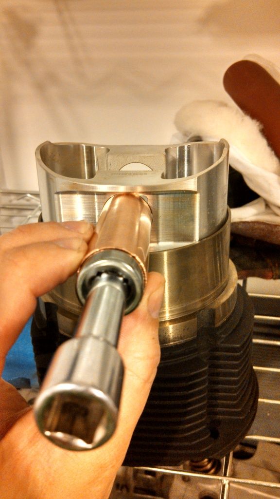

Few folks contacted me about this tool and how to create/use. Here's what worked for me. When you're done it should look something like this:
First, start with copper tubing available at most hardware stores. This piece is available at Home Depot in the plumbing section for under $10.
Chop off a 2-3" section and choose the direction of the of the tool at this time. The end with the square/flat cut (probably not the one you just created when you cut it) should be the end that will face the JE piston and the other end will be where you load the clip. The end that faces the piston should be tapered down with a file around the entire edge and then sanded smooth. I also chose to sand the inside surface of the tube a bit to open it up a bit more but that's probably not necessary.
Here's the relative size of the tool and the clip for reference:
Next, insert the clip into the tube with your fingers. Careful steady pressure so you don't take skin off. These clips are tough buggers because they're so thick in diameter and stiff.
“Of the value traps, the most widespread and pernicious is value rigidity. This is an inability to revalue what one sees because of commitment to previous values. In motorcycle maintenance, you MUST rediscover what you do as you go. Rigid values makes this impossible.”
― Robert M. Pirsig, Zen and the Art of Motorcycle Maintenance: An Inquiry Into Values
Old 05-17-2013, 12:27 PM
  Pelican Parts Catalog | Tech Articles | Promos & Specials    #208 (permalink)
Straight shooter
Lapkritis's Avatar
Join Date: Sep 2012
Location: Vilnius
Posts: 3,088
Drive it in with the socket appropriately sized socket and your bare hands; there are no hammers or mallets involved at all with the use of this tool:
It's probably wise to lube the inside of the tool with a little oil or assembly lube. View from the piston end of the tool with the socket and clip loaded and lubed:
Work the clip up to the piston end of the tube until it is at the edge or just a mm or 2 over:
Square the tool to the wrist pin bore and apply steady pressure against the copper tube to maintain contact while pressing the socket/plunger towards the piston, which drives the clip into position:
Couple notes - load one clip into each piston on the workbench while being careful to note orientation of the piston and planned direction of wrist pin insertion during assembly. If you load into the wrong side of the piston you could end up having to remove it in order to install if the piston is second or third in the row. In other words you would end up being blocked by the cylinder you just installed.
When you load on the workbench, you will need to use the wrist pin to seat the clip from the back side carefully.
When you're installing the second clip above the deck of the engine when you're attaching to the connecting rod, you will only have to worry about the tool end as the wrist pin is clipped on the other end already, of course. No hammer, no banging or prying tools, just bare hands and steady pressure to keep the tool in place while working. The first time it clips in you won't believe how easy it works.

Poor man's Stomski circlip injector tool. Nice job.

Until I added some lube to my Stomski tool I thought even it wouldn't insert these blasted things. Harder to get in, and harder to get out than the factory clips.
So far, I've seen opinions that regular circlips (the ones which have ears with holes for the plier's like circlip tool to engage) are not good for wrist pin retention. But no reasoning given. It looks like J&E will cut your piston for circlips (or spiralocks, though those who rate those as bad because even harder to install or remove or both deserve to have their experiences listened to if, like me, you have no experience with them in this application).

We have the Stomski injector tools here. I had made my own on the lathe as well. After one late night trip to the ER for stiches in my palm when my modified screwdriver slipped and nearly came through the back of my hand (a search will find pics) I decided enough was enough.....
Your tool look like it will work well....

Works great. Hadn't heard of that tool name before, had to Google to see what it's all about. Looks pretty nice with the texture for your pleasure...

Flat edge must have been lying. Left chain wasn't operating as smoothly as I liked. About every 3rd rotation by hand it was catching a tooth and clicking. Removed two shims and gained smooth operation.
All new tensioners installed. The brown on the lower right in the engine was replaced with a black like the rest previously. I swapped it back to the brown.
Brown is same as black just a bit shorter in overall height.
Finding a lot of uses for the 1/2" PVC pipe.
Prepping the chain mount holes.
Cam timing soon, perhaps tomorrow.

Be careful with using the copper spray on the cam cover plate gasket. It's tackiness can cause a leak. Reason I say that is because the installation of the cover plate can sometimes move the gasket and the sticky nature of the Permatex can disrupt the gasket placement and not allow it to slide a bit as you're seating the cam plate. Happened to me on my last build.
Also, it's often a good idea to surface the cam cover plate. It's surprising how uneven the sealing surface can be. Do a test by coloring the surface with a permanent marker and then surface it on some fine sandpaper atop truly flat surface like glass or the like. Like I said, surprising.
Also doesn't hurt to flatten the receiving gasket surface on the cam housing itself. That area is equally uneven on a lot of housings. I'm ashamed to admit i've had to do my fair share of cam housing "reconditioning" for various reasons.
