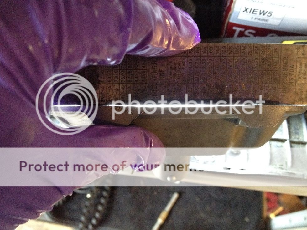

So I measured the hole in the camshaft housing today, it's 4mm, so I still have a bit restriction in the new fitting after I drilled it.
I agree with the increased oil pressure etc, and then there are those who think the cylinder heads need all the oil (coling) they can get, so that's why I went in between with the holes in the fitting, so now I can please both parts

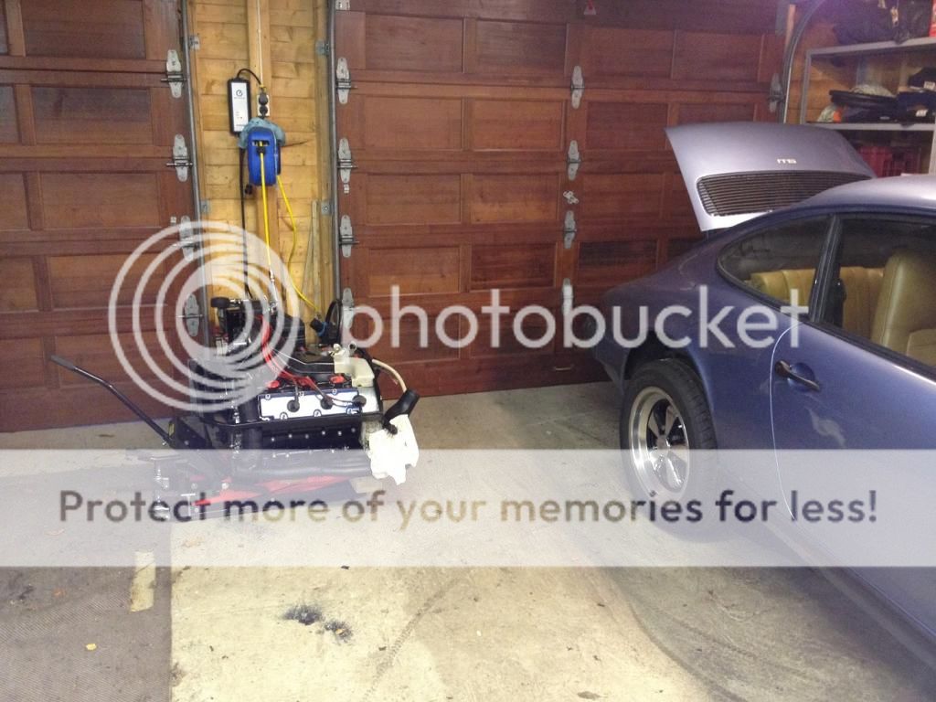

Zenith's at the moment, I'm breaking in the engine before switching to efi/itb's since I'll probarbly use a lot of time learning it
250miles done now, breaking in the engine after waynes r dempseys book.

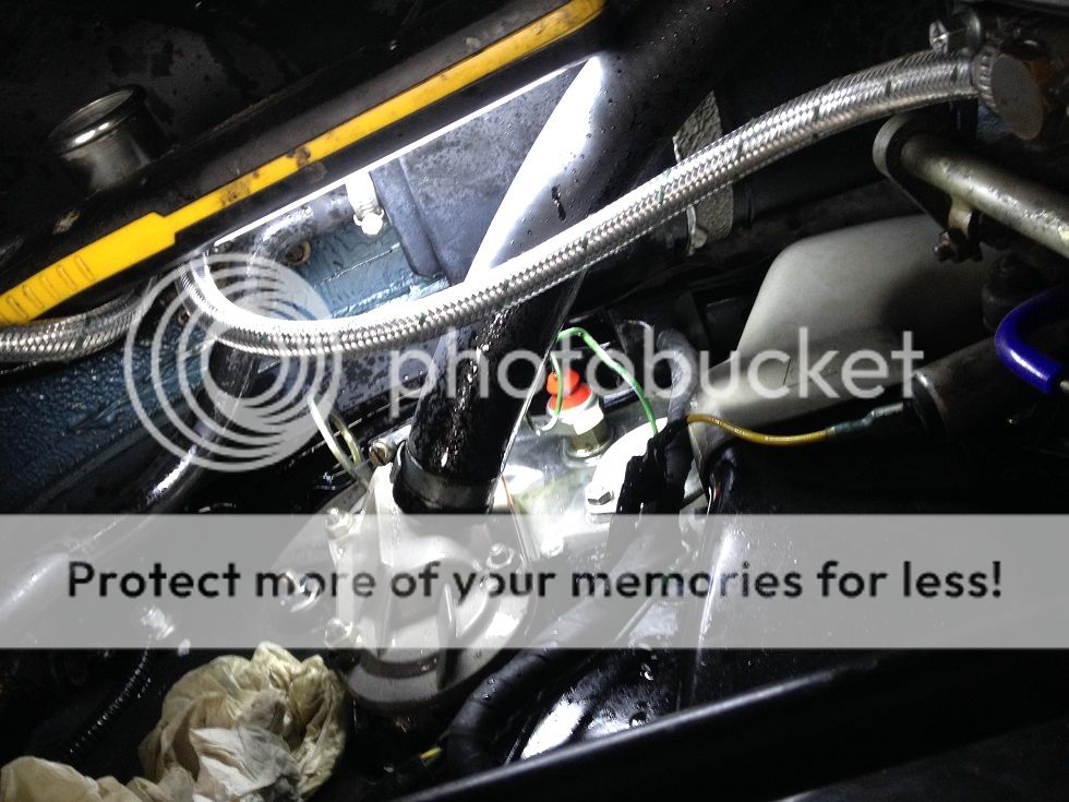

Had a small oil leak
Old 11-16-2014, 02:09 PM
Join Date: Jan 2013
Posts: 148
I thought this was the oil pressure sender leaking, but it turned out the be the crankcase breather cover, I had taken it from another engine and didn't check it.
From now called the banana cover

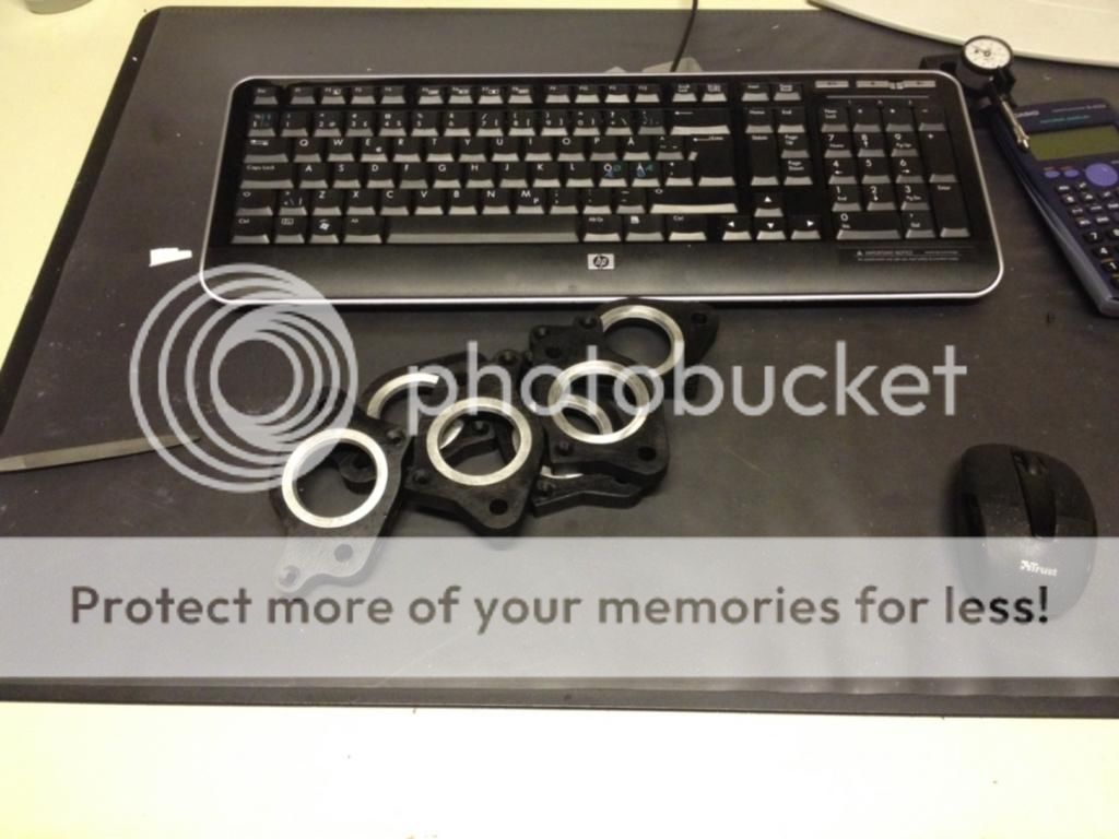

Winter is here so I'll continue the efi/itb saga in the garage, made some adapters to fit the intake manifolds-gsxr600 tb's

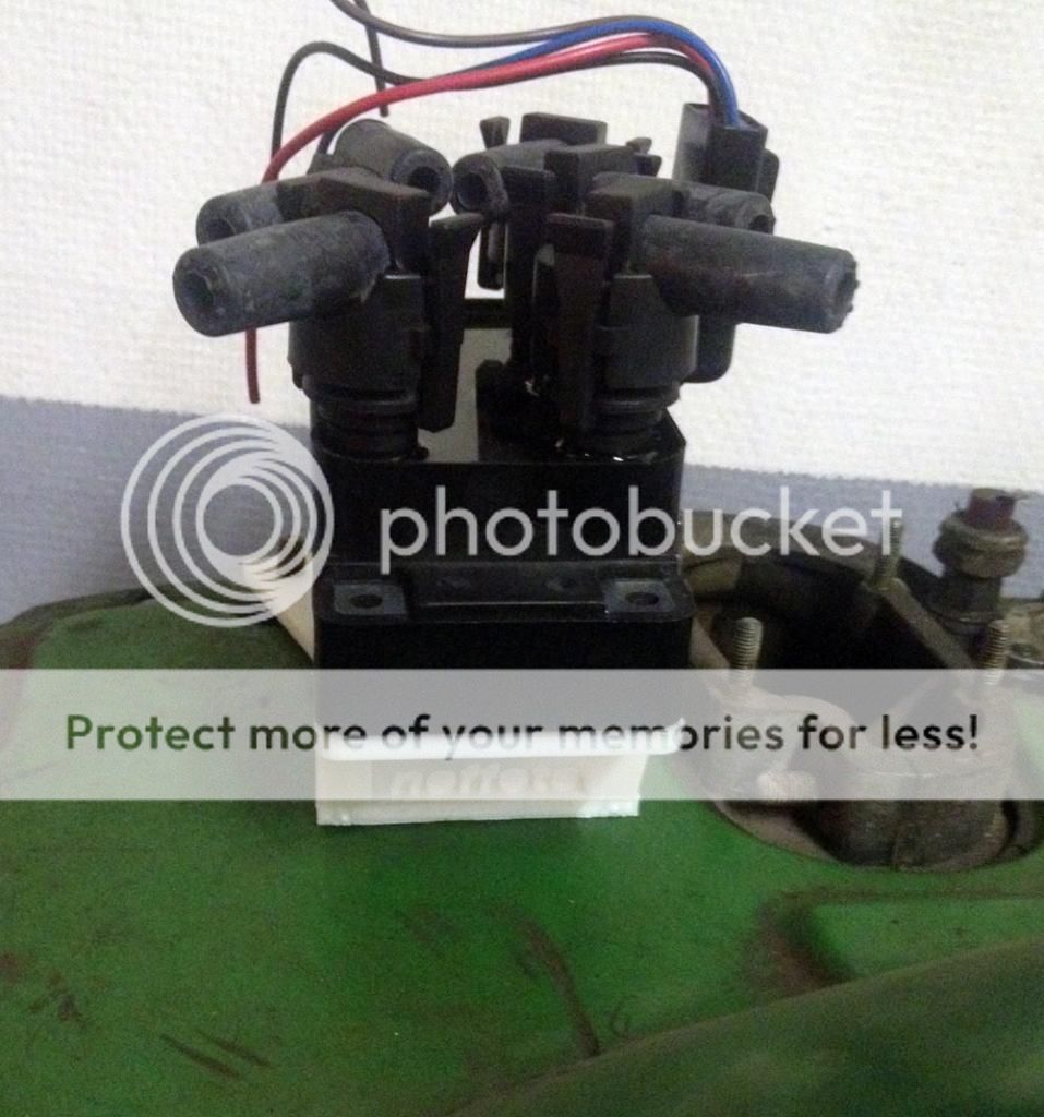

A coil pack holder

Arent you going to keep the Porsche cylinder spacing? IMO the Porsche manifold with Weber spacing looks kind of weird and was certainly a compromise back in the day..
GSXR ITB's can be easily spaced how you like with some fabrication.
'83 924 (2.6 16v Turbo, 530hp),'67 911 hot-rod /2.4S, '78 924 Carrera GT project (2.0 turbo 340 hp), '84 928 S 4.7 Euro (VEMS PnP, 332 HP), '90 944 S2 Cabriolet
http://www.facebook.com/vemsporsche
Old 12-02-2014, 11:41 AM
Join Date: Jan 2013
Posts: 148
Eventually I will space them evenly, I just want to test how long my 3d printed adapters will hold out, so this is just a in-between setup
