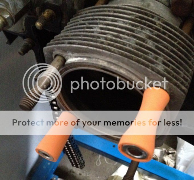

While I'm waiting for my new valve guides I drew a cylinder holder tool you can make if you have a 3D printer
Porsche 911 cylinder holder tool by neffets - Thingiverse

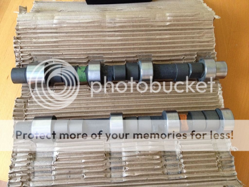

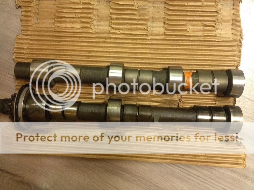

cams arrived today :
What goes where? Port and starboard?

Posts: 1,124
4 bearing cams in a 2.7?

Join Date: Jan 2013
Posts: 148
the 4th bearing will just spin in free air

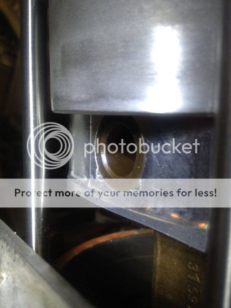

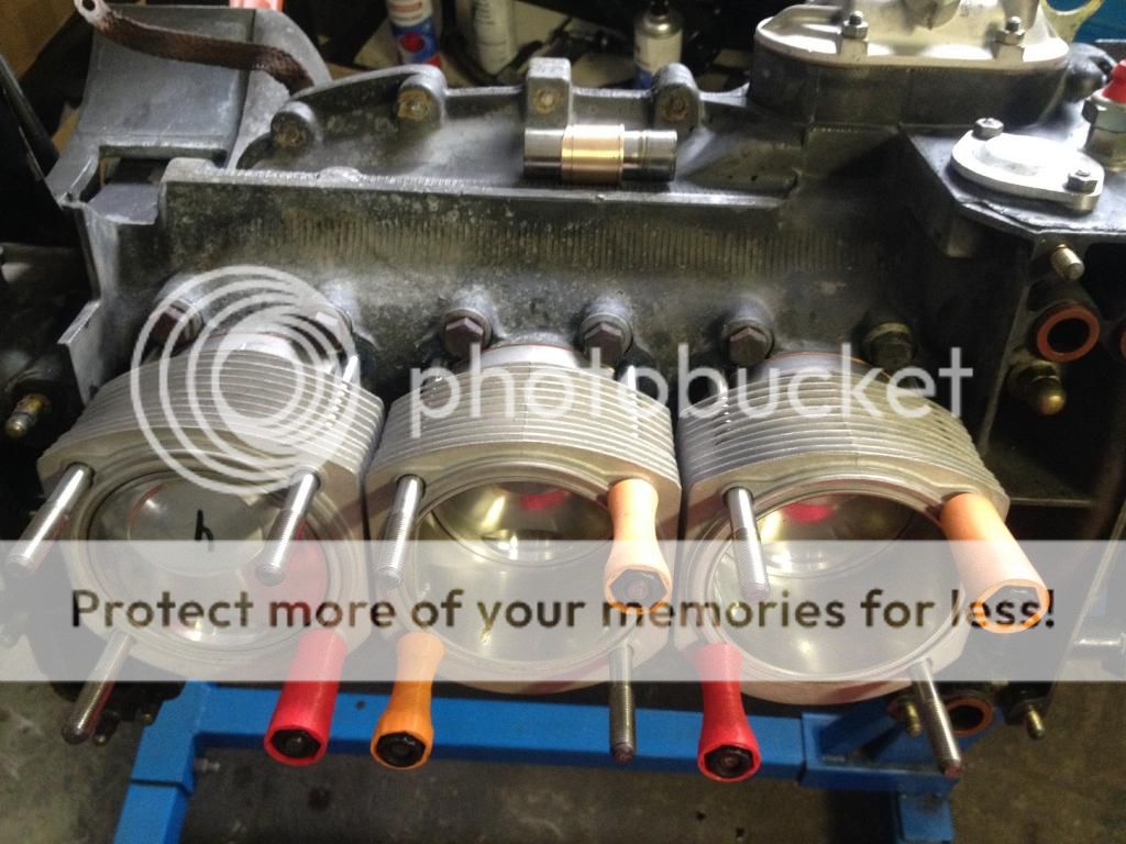

So finally I got 5 of 6 cylinder base gaskets....
Installed on p/c to find out that stock rod pins are to long for JE pistons, argh
Old 08-28-2014, 02:23 PM
Join Date: Jan 2013
Posts: 148
Forgot to update here
P/C installed with supertec headstuds

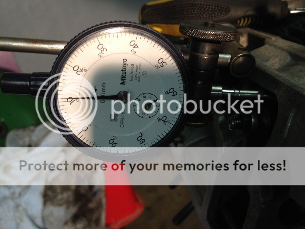

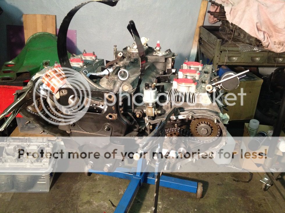

Cam timing, took some time and some tries ended up with
cyl1-2-3 3.89mm
cyl4-5-6 3.81mm that was as close to 3.8mm I could get on the DC-30 camshafts
Old 10-26-2014, 03:16 PM
Join Date: Jan 2013
Posts: 148
The dial goes backwards from 0, so this is at 3.89mm

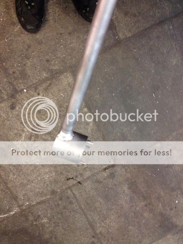

Made myself a camshaft tool

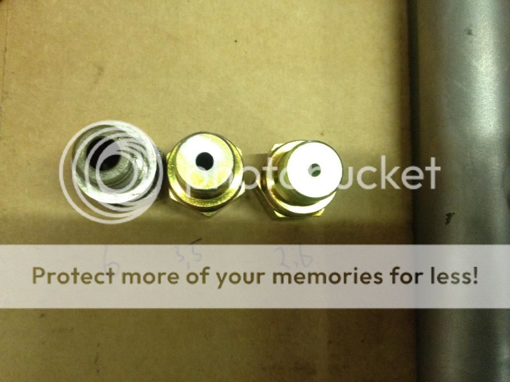

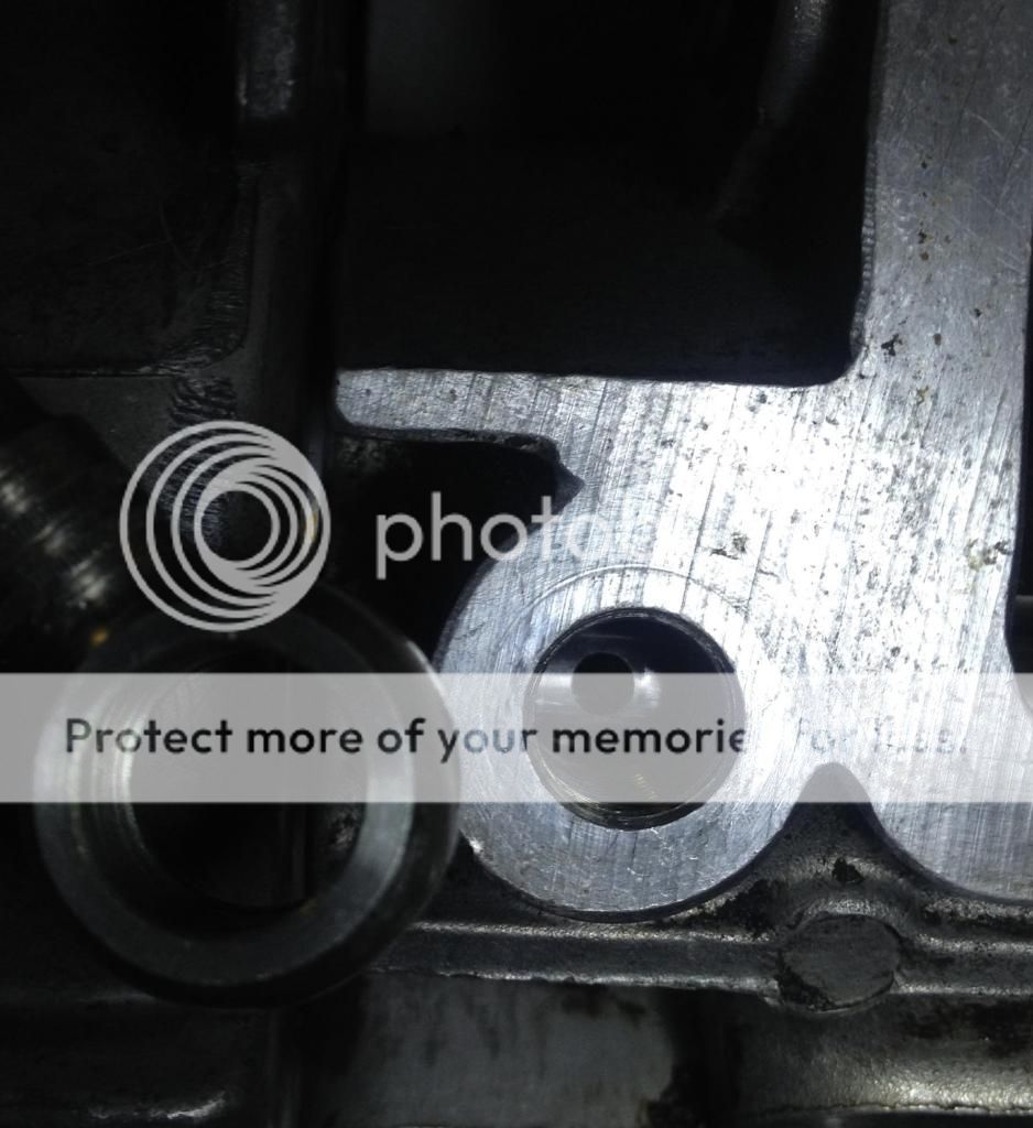

So I bought the camshaft oil restrictors, and after reading much for/against I decided to drill it somewhere inbetween.
From left stock - drilled - restrictor
Old 11-06-2014, 02:30 PM
Join Date: Jan 2013
Posts: 148
Then I looked into the camshaft housing, and dooh there is a much smaller hole than the stock 6mm, I'll measure it tomorrow, but anything bigger than that up to stock hole is meaningless then...
I drilled mine 3.5mm, but if that is bigger than what's in the camshaft housing than it's the same if it's 3.5 or 6mm...
Old 11-06-2014, 02:32 PM
911 tweaks's Avatar
Location: northeast
Posts: 4,530
u r correct on all that u say here...but... keep in mind the entire oil circuit when using the later "restricted/smaller hole" fitting has increased overall system oil pressure which is another gain from using the smaller hole fitting...the other gain - debated by many - when using the restricted/smaller hole fitting, less oil is on top of the motor = better oil scavenging by the oil pump as there is more oil down in the sump that can be scavenged & a bit less fluctuation in the qty of oil in the oil tank...
