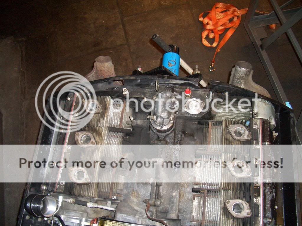

Anything out of the ordinary on these pictures?

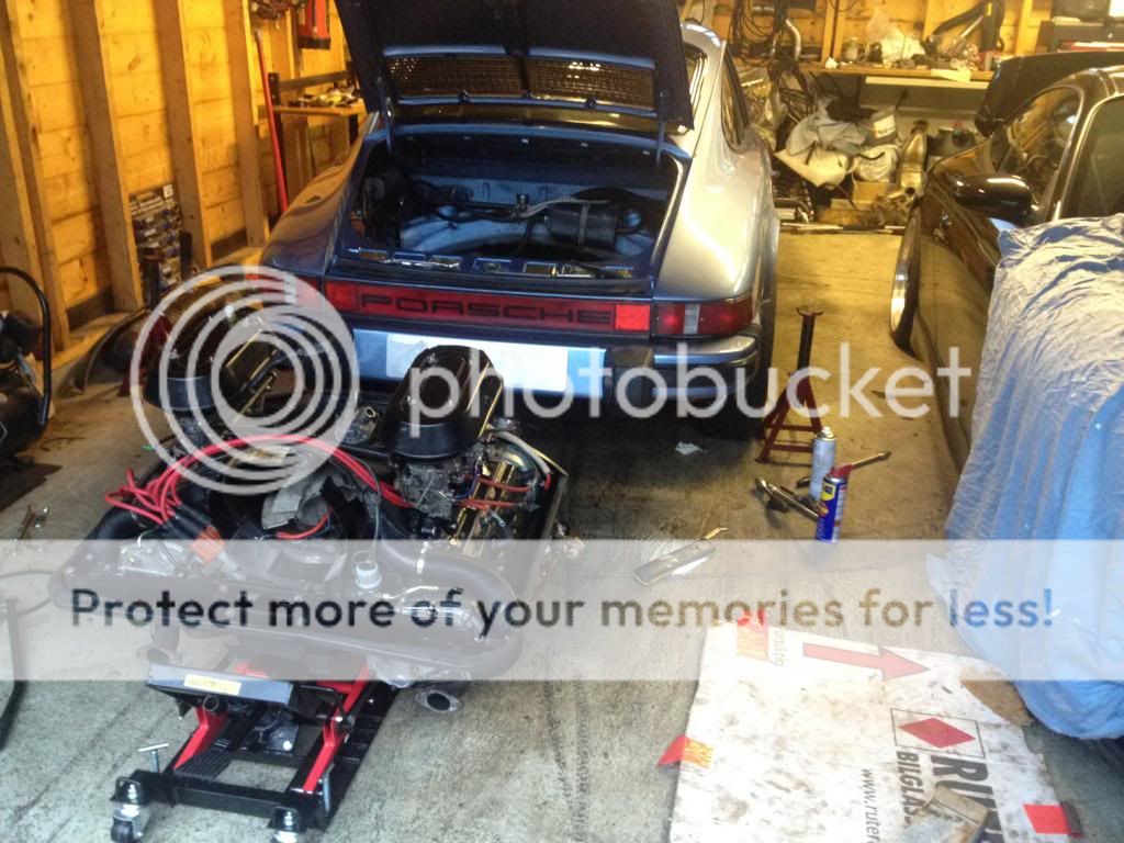

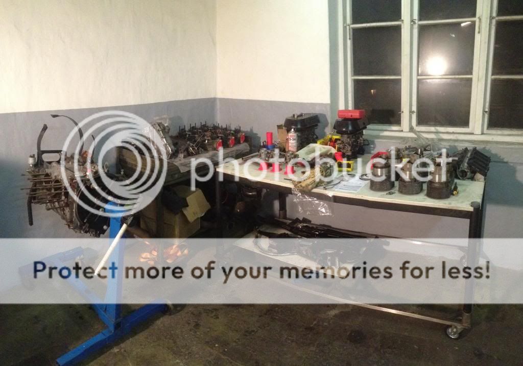

Engine out, took 3hours
Rear engined Audi

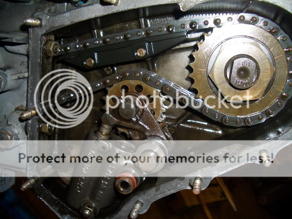

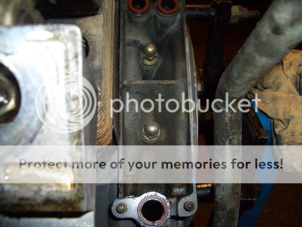

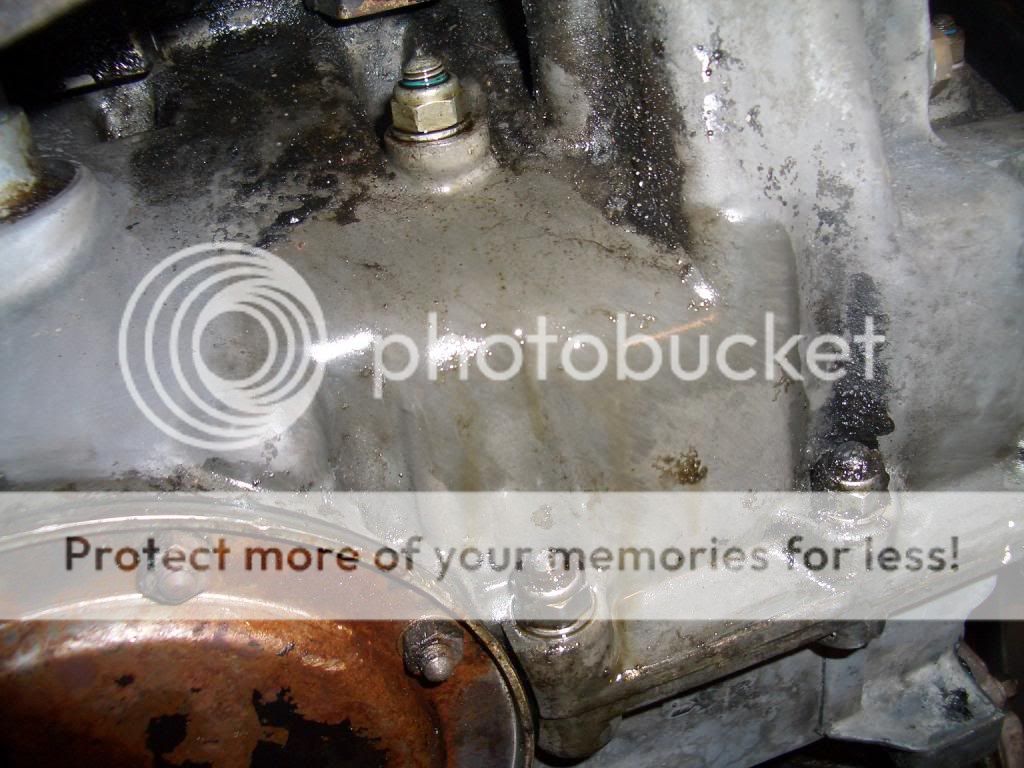

Before cleaning, the gaskets around the "triangle of death" was changed half a year ago, so its just old oil spill

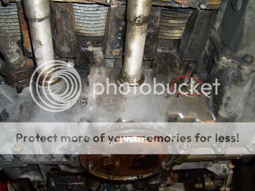

Appears to be leaking oil from this bolt?

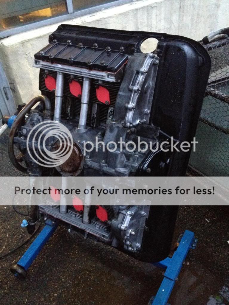

Cleaning engine before dissasembly

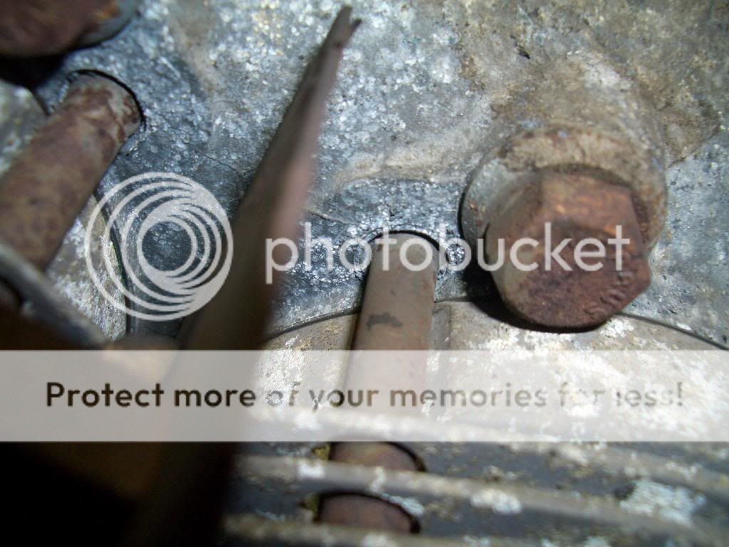

Steel bolts with timserts or casesavers?

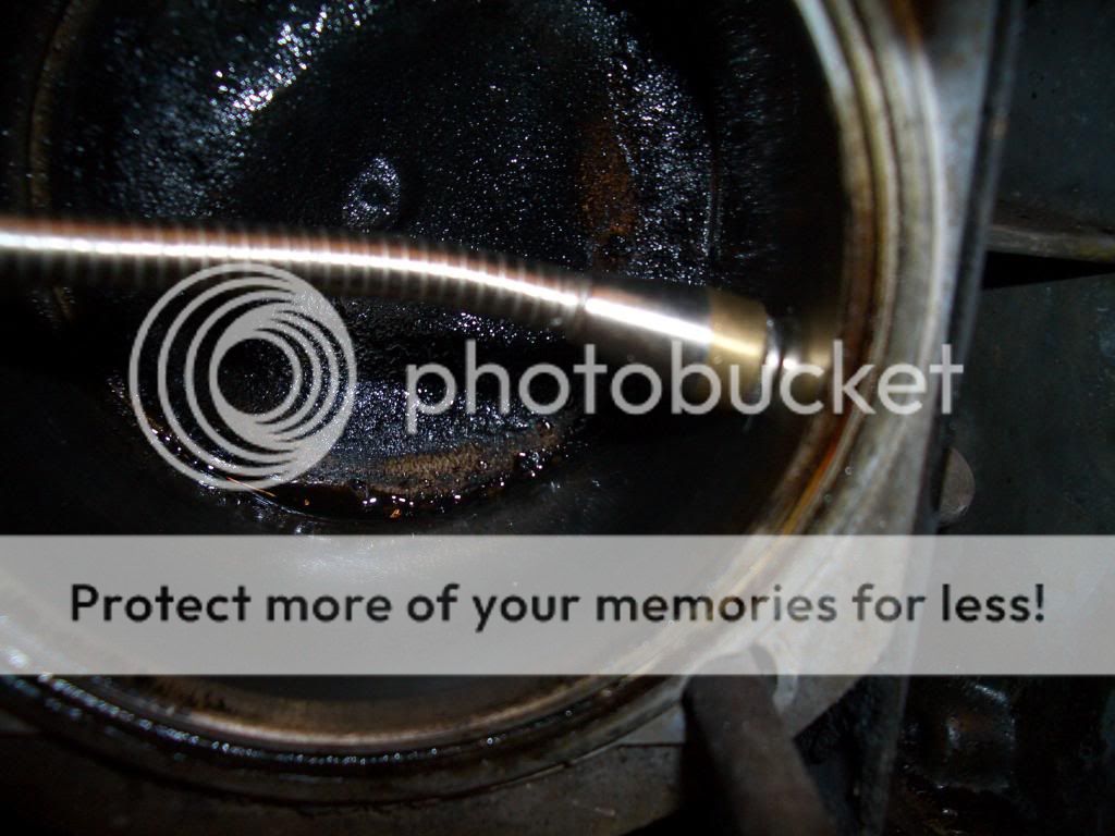

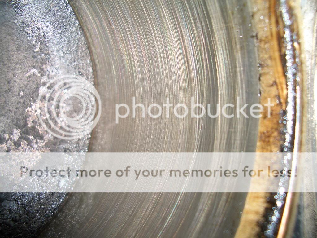

Woho, Nikasils right? magnetic!

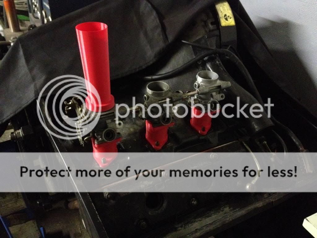

Just a quick test fit gsxr600 throttle bodys

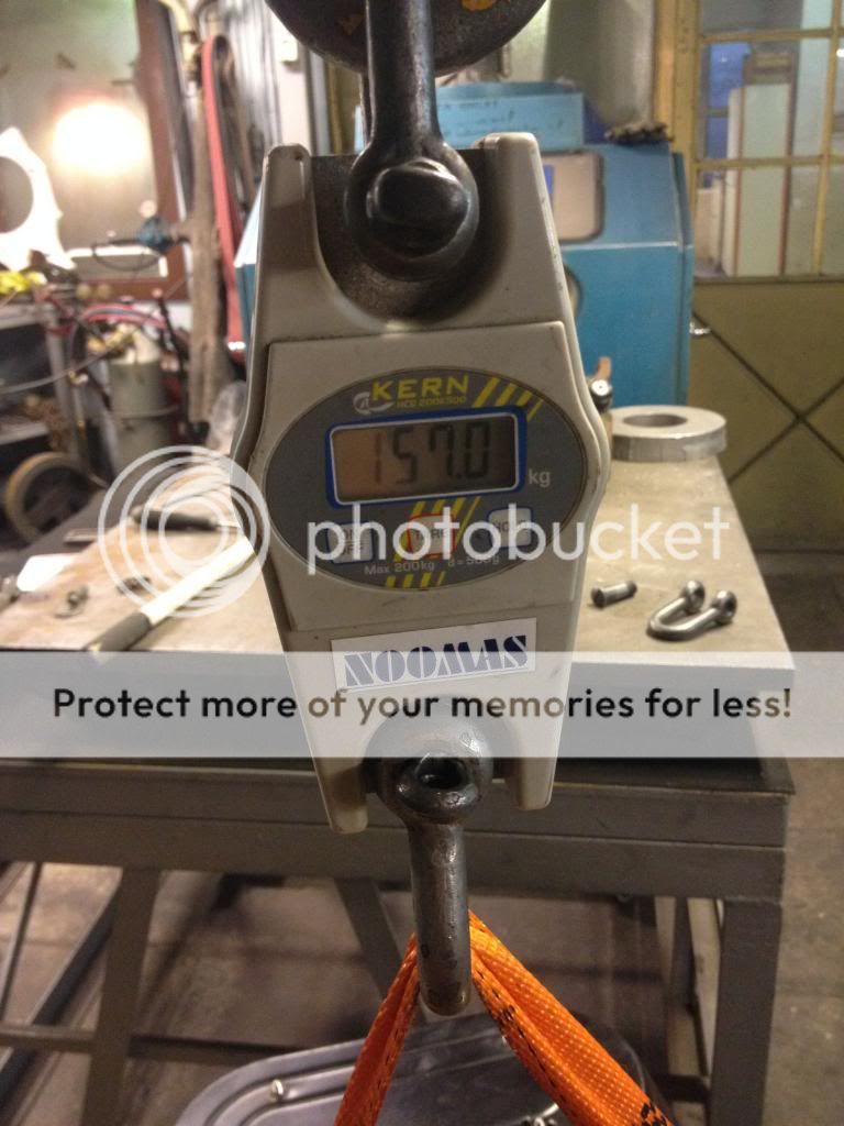

I also weighed the engine (kg)346lbs including heat exchangers, flywheel zeniths, and alternator/fan.
So basically complete engine minus muffler/cluth disc and pressure plate.
My car is 1020kg /2249lbs full tank and as delivered from factory with spare wheels etc. Nothing removed

Our 2.7 race engine is setup nice with stock 90mm cylinders but used the 9.5 J&E pistons and weber 40's along with the DC-40 cam Very nice setup for what we do on the track.
That bolt/stud thats leaking holds the IS is known to pull much like the head studs, make sure they put a 8mm case saver in there too.

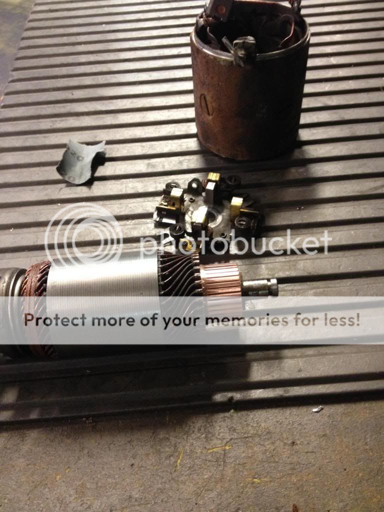

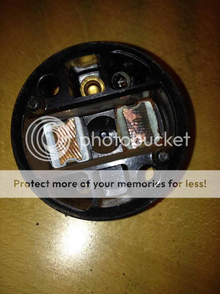

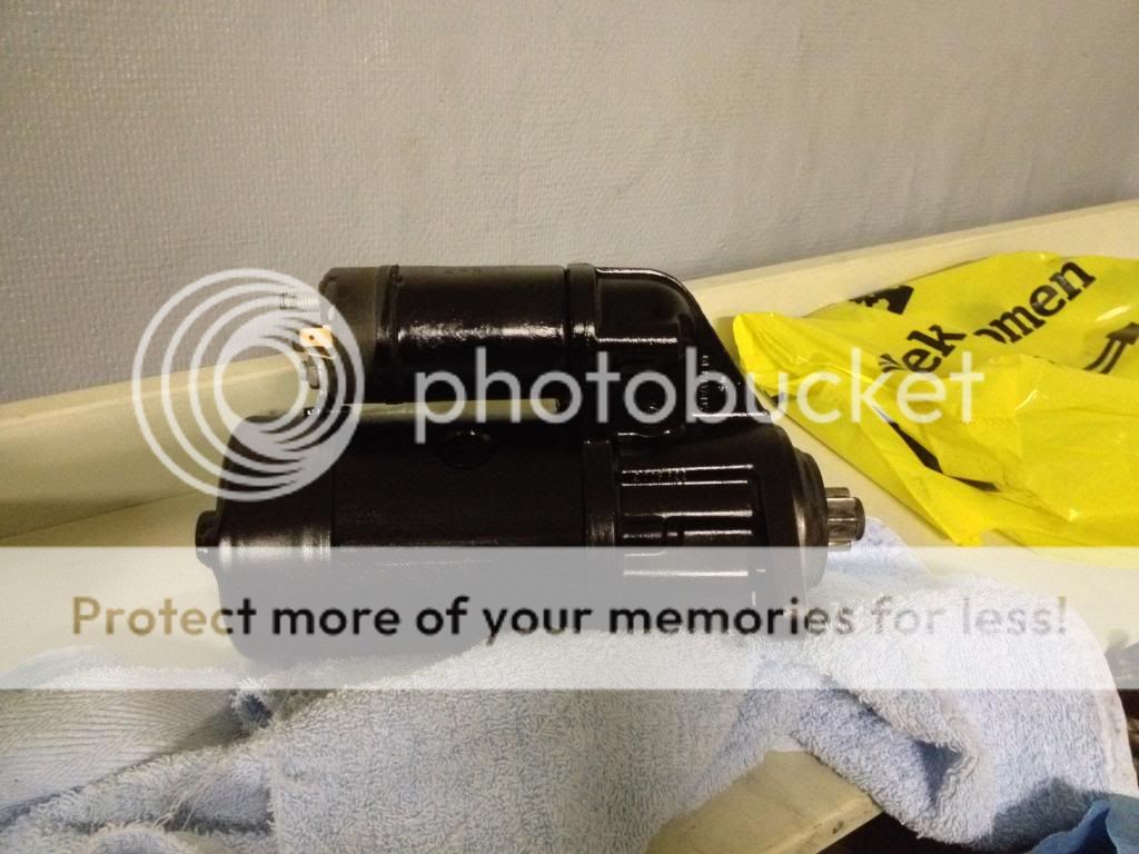

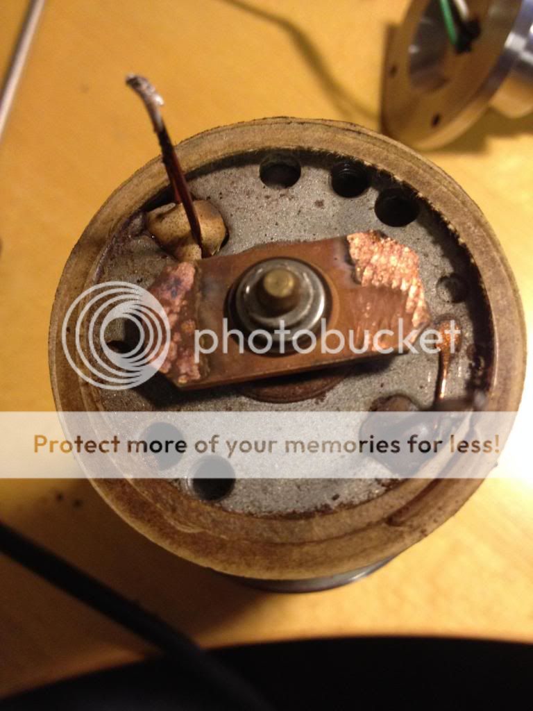

overhauled the starter, the solenoid did not kick in after a long hot drive, so i guess it's time to have a look at it.
think i found the problem with the solenoid
Old 01-18-2014, 12:28 PM
Join Date: Jan 2013
Posts: 148
Good as new, I hope

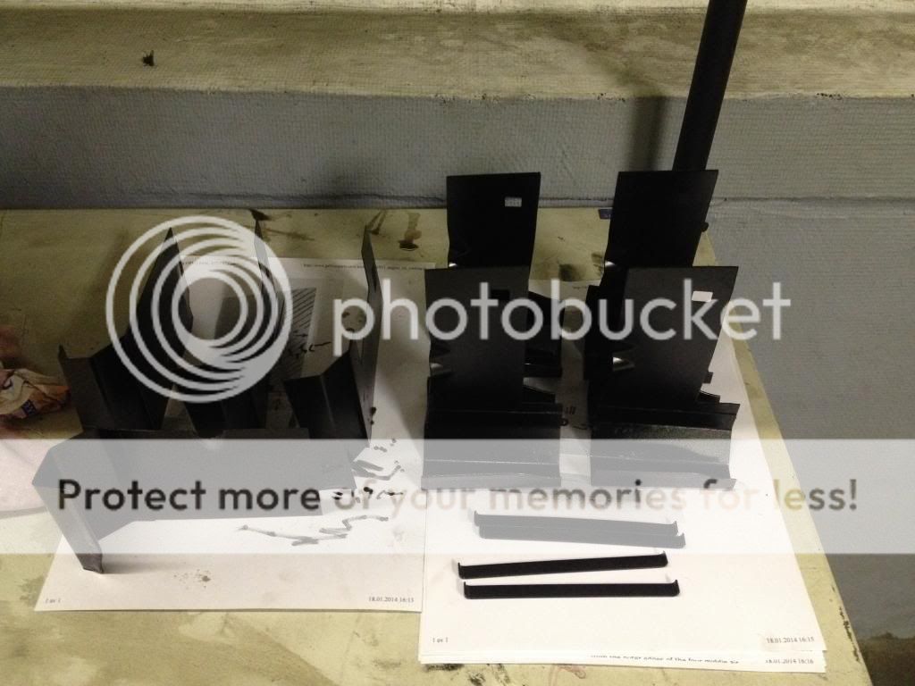

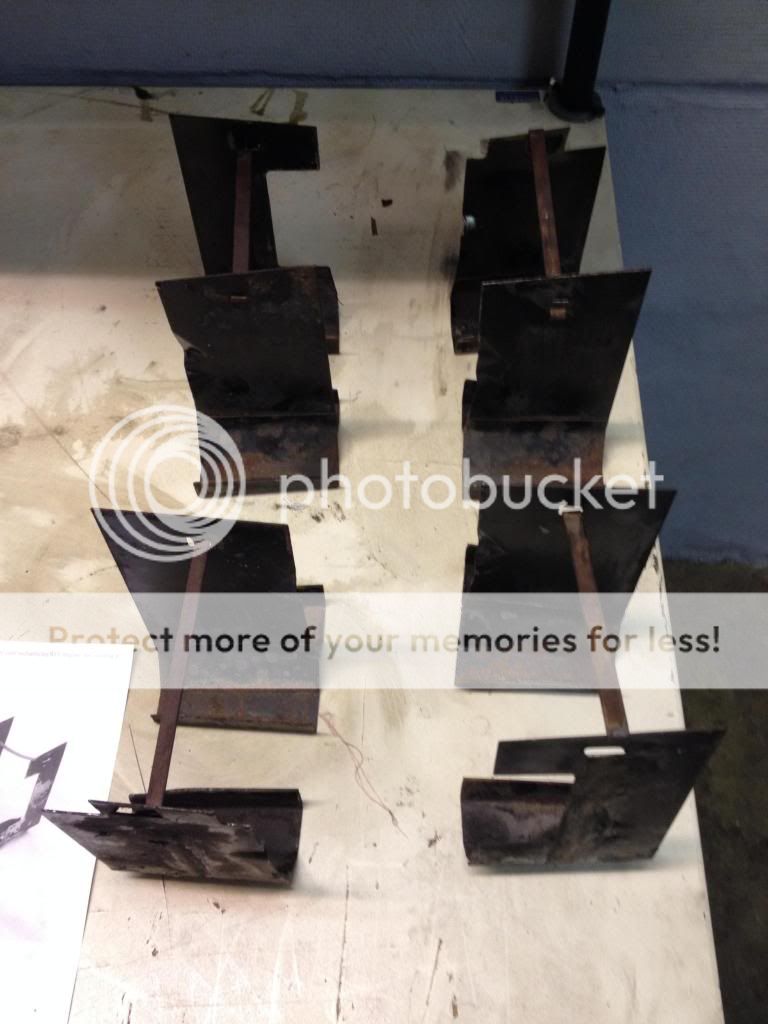

modifying the engine tin

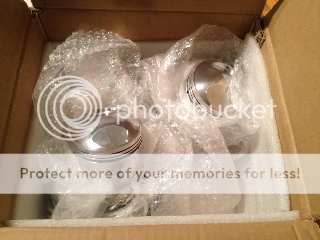

JE pistons arrive! 9.5:1

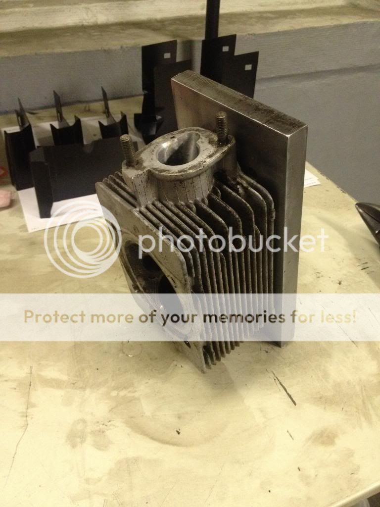

Today I made a jig to use in the mill for the cylinder heads that needs to be ported
I have I/E , 30/32mm
Thinking of going to 36/35?

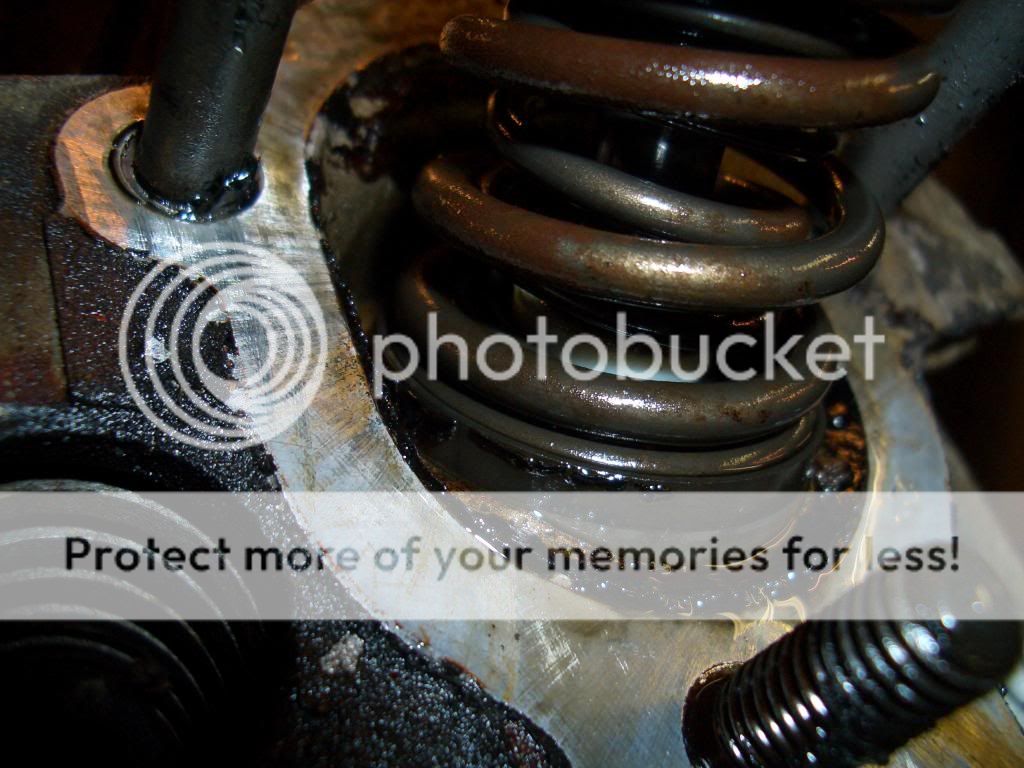

So the big question is, how deep to mill??
It's 35mm to where the valve guide starts to protrude.
After milling i will need to use hand tools to smooth the edges, I don't have a flow bench, so they will have to do without.
The port also appears to increase in diameter from the top surface going down towards the valve guide

Here is a 2.7 head cut to 37mm kind of gives you an idea?

Like your ITB' setup.
Where did you get the intake adapters and velocity stacks?
Trond R.

#cgarr

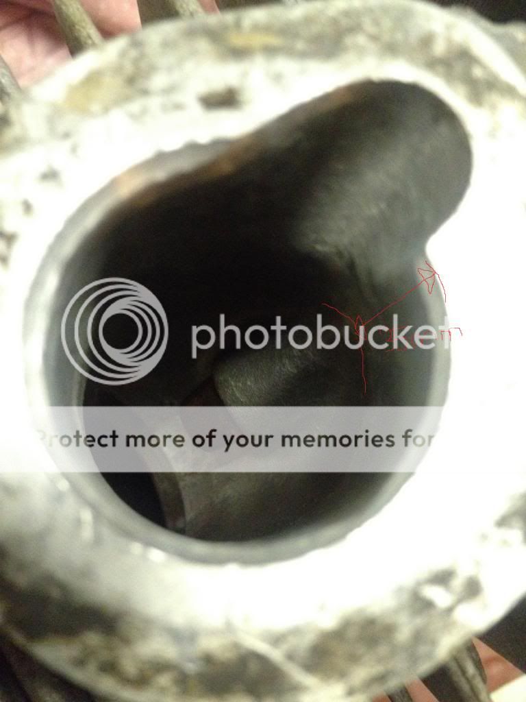

do you have a picture of the exhaust port as well?
#totle
I made them myself

Originally Posted by Neffets View Post
#cgarr
Here it is but did nothing with them just stock 35mm
