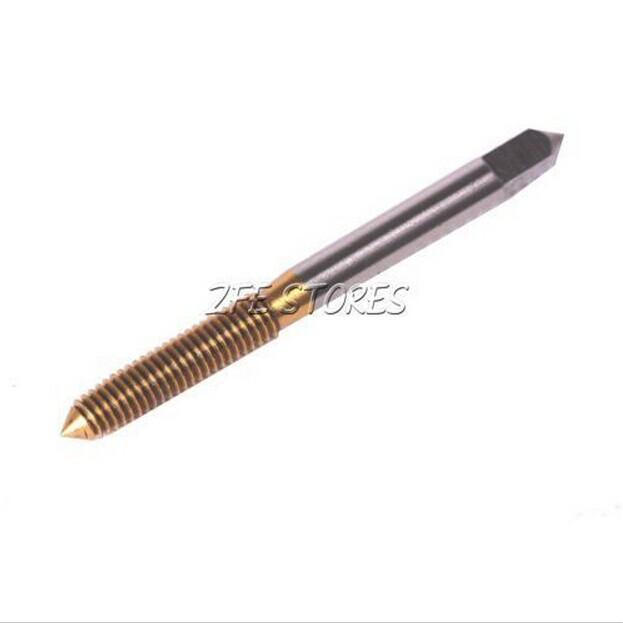

Generally after installation you need to clean the threads with a forming tap. This type of tap forms the threads to a more consistent dimension than the cutting tap that was originally used to manufacture the insert. Also quite often, the tool used to install the insert is not threaded into the insert completely and the threads end up inconsistent towards the bottom.
We offer the forming tap to any customer experiencing this type of issue.

I would like to obtain this forming tap. The issue you describe with the inconsistent threads at the bottom sounds exactly like what I have encountered. I will contact you separately.

I looked this up just to be able to know what Henry is referring to:
Thread forming taps are designed to displace material by pressure rather than cutting the material away. Also known as cold forming taps, they have a fluteless design which is well-suited for blind holes since there are no chips to evacuate. Tool life can be three to twenty times longer than traditional taps, and thread forming taps can be run at faster spindle speeds for higher production rates at less cost per hole. Suitable for use in ductile materials without chips, such as aluminum, brass, copper and zinc - generally, materials which provide a continuous chip when drilling work well with these cold forming taps. Available in standard and Metric models.

Neil. I did use Henry's thread shaper to extend good threads all the way through the case saver. They were still somewhat loose but tight after blue loctite set up. I am pretty comfortable with it due to the clamping force being what secures everything but time will tell ;-)
