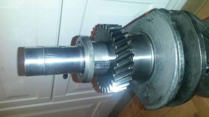

Old 04-01-2015, 11:06 AM
Join Date: Nov 2014
Posts: 24
Just starting the rebuild
Hey everybody!
Just starting to rebuild my crank after I collected the parts from the machinist the previous week. ( wife on trip this weekend - so no chance to get anything done with the "ninja kids" around).
I however started the rebuild this evening. Ended up in a "tie" with the score: pelle-1 / crank 1. I managed to get the drive gear in place. The crank however resisted when I was installing the spacer.
So I'll have to pull it off tomorrow - and see if I can win.
Question:
has anyone got an experience to shear with regards to which temp to heat the spacer up to? Mr Waynes book suggests 150°c - I went for 175°c - but still the spacer won. 225°c ok? Its of steel so should be no prob. The distrobutor gear is of a different material - looks like brass? Mr Eaynes book states 100°c. Would something go wrong with 225°c on that one As well?

The spacer just needs some more heat as you're pushing it down on the crank. As soon as you put the spacer on the crank, the colder crank "sucks" the heat out of the spacer and you lose the expansion effect. Use a heat gun to heat up the spacer and you can get it to move again.
The brass distributor drive gear is much easier to do because it doesn't have as much distance to travel on the crank. Heat it up and work quickly to push it down the crank. The brass will heat quickly and expand very easily. No reason to overheat it

I've always been curious what determines the orientation of the distributor drive gear. Because the gear is symmetric and the tooth cut remains the same regardless of orientation
The image below is from the '84-'88 spec book. Flip the image over and the angle of the gear teeth stays the same. I've looked at the gear in hand and see no glaring difference between either orientation of the gear

I understand what you're getting at. But if the gear pitch/angle is the same direction, regardless of orientation, then the gear is going to drive the distributor the same direction with the gear oriented either way.
Kevin L

Yessir! I'm with you! The threads are going the same way regardless of which side is up. (A right threaded screw will Not turn into a left threaded screw if turned upside down...)
Mr Waynes book argues that you will not be able to adjust the distributor if you got it wrong. It is to be fitted with the markings (part numer etc) facing toward the pulley - as youre attachement states.
Heated both spacer and distributor drive gear up to 225°c and hurra!
Plastigauge of the ground cournal:
Rods are now installed, and I'll pick up on the final cleaning of the case on friday hopefully.
Rods are tightened i.a.w this service bulletin:
Here is a closeup of the damaged radii and the new oversize bearing halve. As one can see the bearing stays well clear of the damaged area
