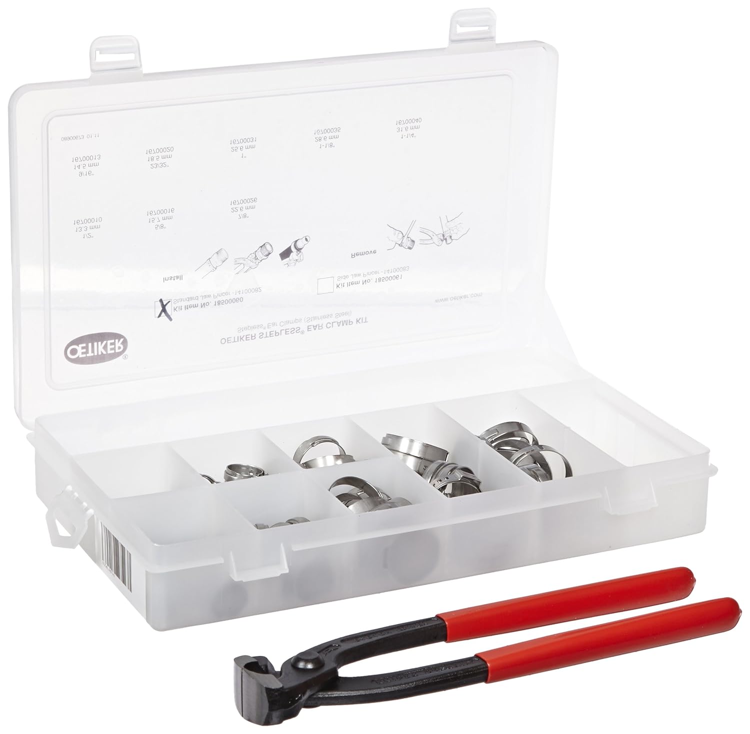

Len has not responded to my inquiries, so I'm on my own with the fuel lines. I think I'll get some Dayco fuel injection hose and Oetiker stepless clamps and do it myself. I should be able to do it for less than $60. Has anyone done this?

A buddy of mine here on the forums used new fuel injection pressure rated hose and Oetiker clamps. No complaints so far and he did it many years ago.

Oetiker clamps
Found the Oetiker Clamp Tool at Home Depot in the Plumbing section, about $65. They also have a small selection of the clamps, but I don't know if they are the right size.

I'm guessing that is the large one for PEX tubing. I see the small automotive/medical size for $25 to $35 dollars.

Here is my old one, I also used FI hose and made my own been fine since 05
BTW the tool is a Knipex 1099 you can get them for about 30 bux new. Mcmaster carr has all the clamps you could possibly need:

Amazon has a kit that has the sizes you need and the tool:
http://www.amazon.com/Oetiker-18500060-Stepless-stainless-standard/dp/B008L4874S/ref=sr_1_1?ie=UTF8&qid=1453397076&sr=8-1&keywords=oetiker
