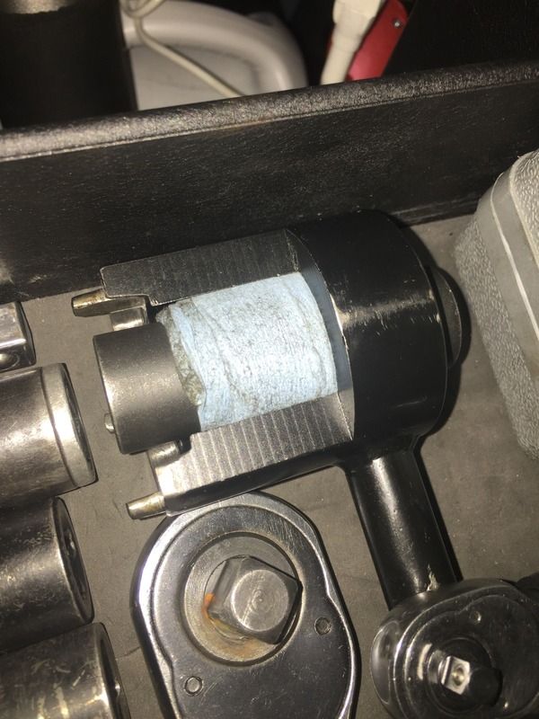

Thanks, next question is whether i need long handled cam holding tool from Pelican site or the Stomski cam sprocket bolt version...

Yes, you do either one will work. Just do not get the one from ebay or you will have to grind it down to make it work properly. Ask me how I know but sure was cheap, key word cheap no fit cheap.
Now, do you need the beautiful Stomski 19MM socket guide, No, just use paper towels, roll the paper on socket and fill the gap to keep it centered, not as purty but it works.

Northern Calvert county outside Dunkirk
I like the scott towel filler!

Got the Stomski tool and it seems very nice, but my cam sprockets are not the 4 hole style,
Will have to call them tomorrow to see what my options are, my engine is early 95 (really 94), maybe cam sprockets are same as 964???

I used the sprocket holding tool that I bought from Pelican.. like a few others that have mentioned, one of the pins which are D-sectioned, was not aligned correctly and I had to file it down a little to get all 3 pins into the sprocket.
But it still worked well.

Thanks to Steve Stomski for swapping the 993 tool I bought for the 964 tool I needed, ))
