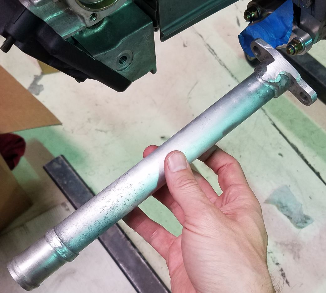

Oil inlet tube to AN-16 inlet adapter
I dont plan on making a complete AN line from my tank to the oil inlet on my case, but since I've added an extra filter console, I need to fabricate a tube with an AN fitting on one side and the clamp side on the other.
I've seen this piece in the wild, but I cannot seem to track it down.
Here is a piece I have that was hacked off an broken oil cooler. I plan to weld on a AN fitting to the bottom of this, but Im not a very skilled welder and would prefer to purchase a pre fabricated one.
Ideas on a new solution are welcome, or thoughts on where to get the part.

yeah that's the part I installed you can see in the pic under the blue tape. I need to route a line for the oil. and I'd prefer to use my S hose. so I need a tube with AN female already installed.

Not sure if I completely follow what you're trying to do, but if it involves having that oil feed tube essentially solid mounted via fittings to your engine, you should add a support or brace from the tube to the engine or I'd worry about it cracking from vibration. A custom oil line might be a better option.

Roland, that's exactly the piece that I saw on the other car here in my shop. I cannot seem to find this pre fabricated anywhere. Im either needing to make mine own with a mounting bracket, or go with the custom line approach.

Hey Mike, thanks for the offer to use your 964 inlet tube. I found the one Id seen here at the shop. Its the Smart Racing product that you posted the catalogue pic of. JWE has them in stock and they should also come with the mounting brackets as well. I'll update the post when I receive it!
