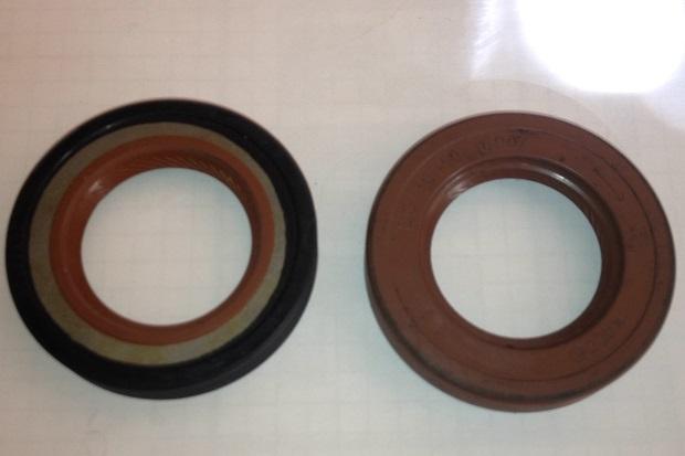

Hi Tori..my advice is not to use on your flywheel all brown seal ..they suck.Use only the one with black trim ...same goes for the front pulley seal no "Brown" only brown with black..
like these..
I could use the same words as Jim...ask me.h.....
The other thing is the oil press.switch i hate these new types...recently i have found some on ebay original factory so i bought my self 4 ....for the future..

Thanks Ivan, i'll shoot for the black and brown OEM seal then. The "genuine" OPS that our host sells looks just like this one. I may have to try my luck on that one.

Your Wrightwood Seals are just fine, key is how you put them in and how straight they are.

The best flywheel seals are made by Elring and happens to be in the Wrightwood Racing set..The V.R. brown will leak ..just my experience....

Turns out the Wrightwood Racing set, (at least the full set i bought) does not include the Rear Main Seal. The one i did buy is Corteco. Opinion on that one ?

there are two gasket sets, engine and upper gasket set , these seals are not included on the upper set..
Corteco looks ok....but do not know it ....maybe Jim will or others..i stick to what worked for me in the past....
