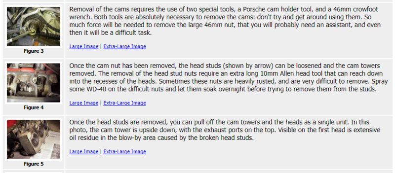

The reason I ask, is because of these pictures/process posted by our gracious host. The heads are removed as one assembly!

You don't need the crank to turn at all for the steps i told you. Follow what I wrote to the letter and it will work. I have done this dozens upon dozens of times.
Once you get both cam towers and heads off, remove the cylinders. If your crank was seized before, it won't be now.
Old 08-19-2017, 09:06 PM
Join Date: Apr 2016
Posts: 1,176
That is exactly what I wrote, with more steps than pelican had. Follow it.
