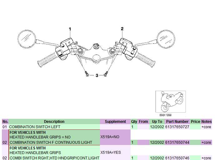

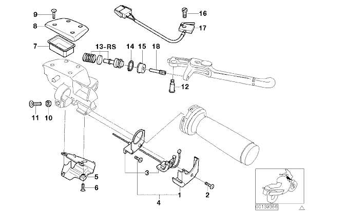

The first picture shows everything that is irrelevant to this discussion and stays on the bike.
This second picture shows the faulty part in question, the combo switch (#2 - containing the kill switch, the right turn signal switch and the turn signal cancel switch, NO heated grips switch) which can be separated from the master cylinder with the philips screw (#3) shown and one philips screw up from the bottom (#6 in the first picture). The wires attached to the switch go to a connector in the right relay box. After the two screws are removed and the wires disconnected, the combo switch is loose in your hands.

Originally Posted by pwillikers View Post
The Aussie to the rescue! Thanks.
Were I to separate the rear half of the right hand assembly that contains the switch components and send them to you, you'd send your working switch assy. to me? I'll post images when I get close to the .pdf to confirm that I know what we're talking about.
It is okay by me. And my bike doesn't have heated hand grips.
The pictures make it clear what you are talking about. I'll PM you with my home email address.

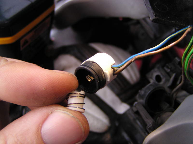

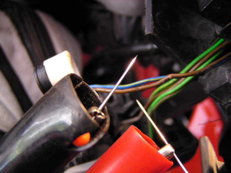

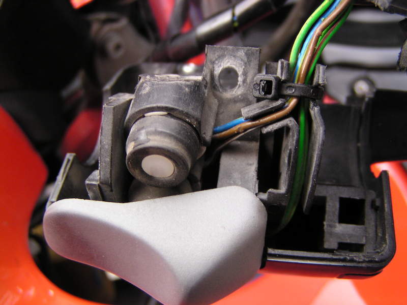

Fixed
Well, once again props to George and Billy who, of course, are correct. I pulled the switch off and pried the orange push button loose from it's pivots.
which allowed me to pull the switch out in my hand.
I pulled off the rubber boot and was able to get to the oxidized contacts inside.
A little emory cloth on the contacts, confirm operation with an ohm meter and some straight pins through the insulation, reassemble and back in business.
I be blinkin'!

Congrats on the courage to boldly go, where you have not been before Paul!
Great pics for others future use to BTW.
