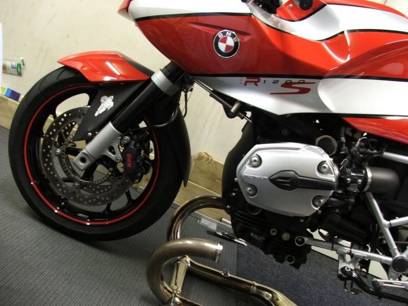

...shreddr ; as promised...
...a picture of the Dzus fasteners...
...I know ; my brackets looks different from yours, but I also got the stock Ilmberger mounting bracket, and I could use these fasteners on that one also...
bracket & fastener from the inside
and from the outside
(so ; no fiddling around with a nut and bolt)
...pan & pipes...
Have a nice day !
Ron.

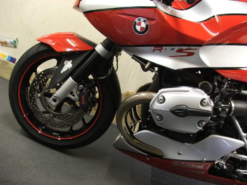

got it !!
one...
two...
three...
four...
and five...
...of course ; the pan will be (re)sprayed in silver and red...
...BTW ; I didn't use the original HP2 Sport brackets, which I posted before. I modified the stock Ilmberger bracket, in order to use the Dzus fasteners...
...gorgeous piece of carbon fibre !...
Have a nice day !
Ron.
R1200S + R1200RT

before...
...and after
Have a nice day !
Ron.
R1200S + R1200RT

Ron, what's the story with the pregnant midpipe. You say it doesn't have a cat, but mine doesn't either, and it doesn't look like yours. Is this the Euro stealth method of making a system look certified while being open? or did the previous owner perform a catalystectomy?
Old 11-14-2009, 03:40 PM
...elica rossa...
RoLoo's Avatar
Join Date: Feb 2005
Location: The Netherlands
Posts: 5,431
...'pregnant midpipe'...
…I kinda like it this way ; it has a stamped ‘E-keur’ in it, so indeed it looks certified…
...I must admit though, the straight non-cat-pipe you have got, give the it a cleaner look…
...see ; with a 'E-keur'... (the E1 + number thing)
…I had to attach those springs like this ; sadly the Laser pipe doesn’t come with those little hooks…
…and I had to use the springs, because the HPE and Laser don’t mix very well together…
…there is just a tiny bit too much play, to tighten the Laser properly by only using the exhaust clamp…
...that's also the reason why I had to use the centre mounting bracket...
...to give the whole system a bit more stability...
Have a nice day !
Ron.
R1200S + R1200RT

...BTW, Mr. shreddr, this is the modification to the Ilmberger front bracket in order to get those Dzus fasteners properly used...
...nothing more ; nothing less...
Have a nice day !
Ron.
R1200S + R1200RT
