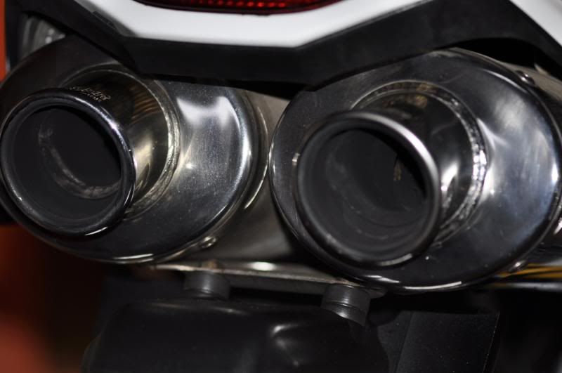

Just Kidding. I cant tell for sure if my Laser exhaust on my Boxer Cup Replica Still has the Db killers in. Can someone who has removed theirs take a look at my pic. Thanks, id hate to destroy something if it should not be removed.

i cant tell, but it looks like they either aren't in, or they have been cut way down.

They're still in there. You can tell by the little step just inside each opening and you can see they extend about 2 1/2 inches in with a smaller diameter. But the most tell-tale sign is there's no hole at the bottom of each tube where the spot weld would be drilled out.
To take them out use a 5/16 inch drill, find the spot weld, and drill it out. Then put some penetrating oil around the edge, not wd40, something good. Wait a while then stick a broom handle or dowel in there and work them side-to-side and up and down until they loosen and come out. Some come out easy, some don't. Mine didn't. By the time I got them out they were almost unrecognizable from the slide hammer treatment.

I see the spot welds now. Thanks a million

i just pulled the db killers out of the mufflers on my 05 bcr and didn't notice a whole lot of difference in the sound. The bike did start easier and idled a whole lot better though, I have to say that alone made it worth the effort to get those bastards out. It was kind of a pain in the ass(I too had to resort to a slide hammer)we'll see how it runs when I ride later in the week. Temps are supposed to be in the mid 40s and I can't wait to get out

Yep. But agree... you lose the almost 'fluffy' sound at idle/low revs. I'd recommend it but be patient as it could take an hour or so of coaxing to get them out without damaging anything (suggest you remove the mufflers from the system and do it in the garage & not on he bike, as you could damage the rear bodywork)

Greetings,
To Remove:
  • Drill out the 6pm spot weld completely
  • Insert broom handle and wiggle them out.
To reinstall use a small SS screw, lock washer and bolt.

There is one more way. I did this....it takes a little more time. I used a die grinder and milled the spot weld from the inside so I would not have a hole. As described above will be easyer and a little hole at 6 oclock is no big deal. After all that I still was not happy and bought staintune.....I`m happy.
