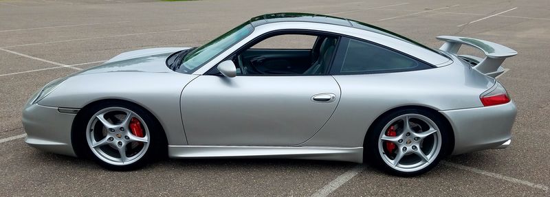

2003 Targa. Never driven a Boxster, I don't fit. I've put about 1500 miles since I purchased this April. 52K Miles, paid way more than 20K, but has X51, PSE, Aerokit, Full carbon Interior, two owner, yada yada yada.
345hp is plenty for me. Like my 85 Carrera, it likes it up over 4K rpm, but has way more torque. 65-100 is effortless.
Targa hatch is awesome. Excellent access to rear seat area for luggage, golf clubs etc. My 12 year old can ride in back for short distances, although she is quite short.
I had the IMS retrofit, clutch and AOS done at shop. I recently did motor mounts, oil pressure sender and removed front bumper to clean radiators, myself. Very easy. I plan lots of DIY stuff in the future.
