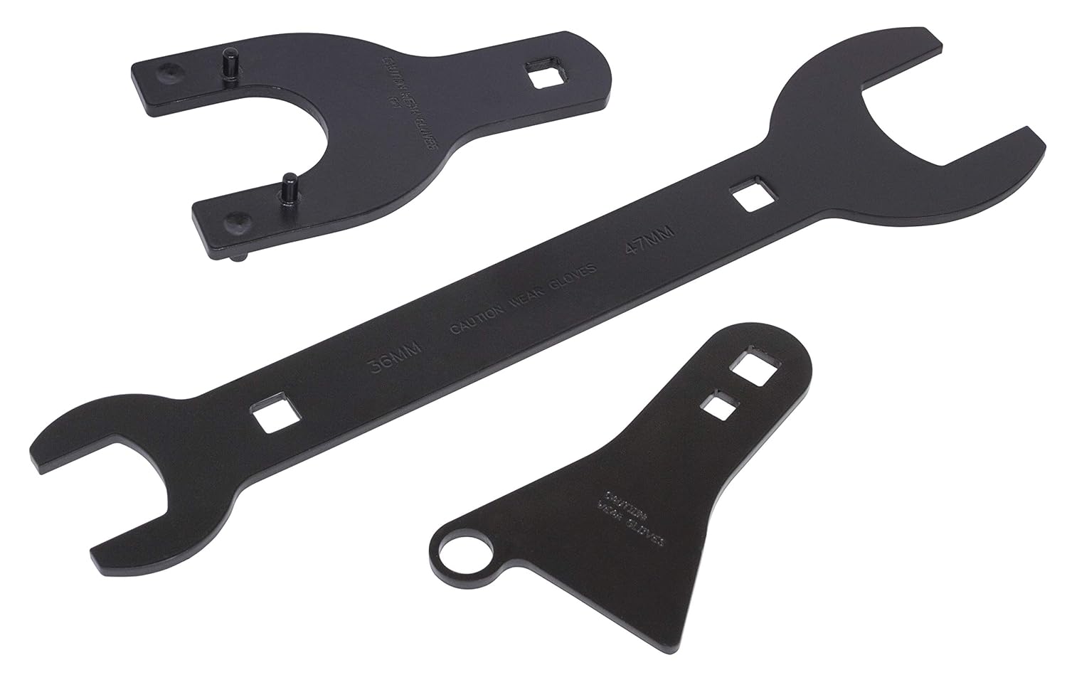

Her's where it goes off the rails, it's got the press on water pump cover that spins with the fan clutch so you need to immobilize it to break the fan clutch nut loose.
On the press on type they give you 4 threaded holes to put your own bolts so you can use your immobilizer.
Problem is I don't know the size and pitch and have dropped 4 bolts into the belly pan in my trial and error attempts at finding something in my bucket of extras that will work.

I went to bed early , sorry I missed this . Quick and dirty universal fan clutch tool is an air chisel with a long bit. Spins that fan nut off every time .

Uberd to the store this morning, found the tool, happily paid the $25.00 even though I'll likely never use it ever again, got home, whipped out the breaker bars and it came off like buttah.
Nothing like having the right tool for the job, worth every penny every time.
Top tool has the little studs in place of having to thread bolts.
