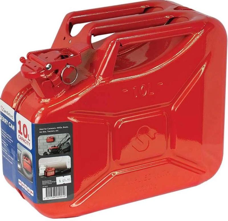

Something like this would be ideal.
- Peter
