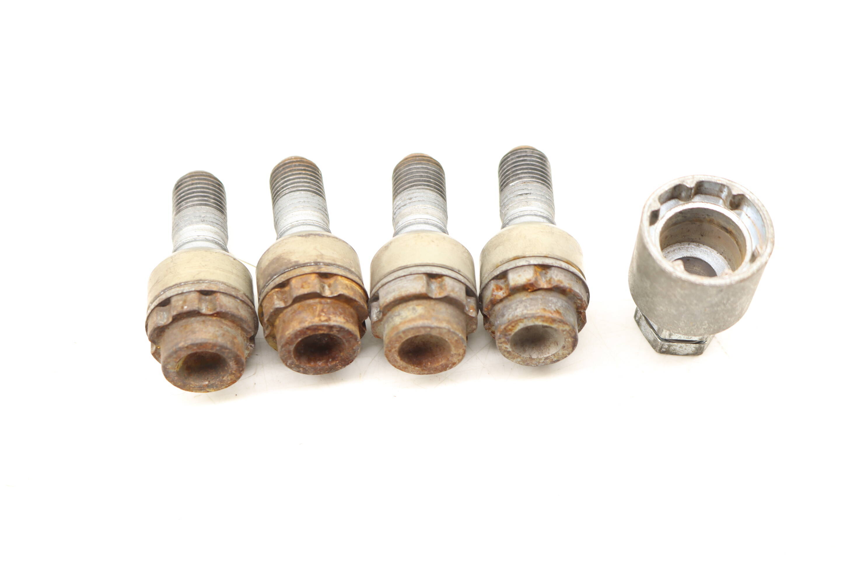

So what is the story on locking lug nuts.
I have 2 porsches, and the 996 has a flat tire.
So I bought a set of "porsche master key set" sockets to pull the locking lug nut.
this is what they look like. Full Splines all around.
which would work on my Cayman, as it has splined lug nuts too.
BUT HERE IS WHERE I MAY BE SCREWED. on my 996 C4S, with the blown out tire, this is what I'm looking at, with no key with the car.............
are all porsche locking lug nuts splined?, and am I looking at an aftermarket key lock?
I'm screwed if it's custom, I have factory rims!
please don't suggest pounding a socket upon them. I'm not a caveman.
How the frig do you get 4 of these off with no key?

I'm 99% certain that what you have on your 996 is factory.
When I was looking around the other day, I discovered what you did (wasn't there just a thread about this that you posted recently, a week or two ago?).
9x7 series use the splined style (my boxster has those too), but the 9x6 use a different style of "locks".
some photos on the net for 996/986 (and based on their part number, maybe 993?).

well crap, sounds like a tow to the dealer if I can't pull the wheel at home...........

I'm sure there's a way around that. A quick check on eBay and I came up on a set for $50. I didn't even go down the full list. What is the dealer going to charge to find the right one?
At the least I'd plug the tire and drive it.
Another thought is to trace the inner on paper of make a quick impression with clay or silicone.

Thanks Zeke, the 996 C4S has REALLy deep lug nut hole reaching too far for an imprint, but great idea.

A quick check on eBay and I came up on a set for $50..
Web link to a key set of what I need? I've spent hours on Amazon and Ebay, but can't find the fingered key that I need.............
And with a puncture in the middle of the tread, it should be possible (probably a PITA) to plug the hole with the wheel on the car. I've had/driven plenty of cars with the old style gooey rope plugs in them over the years, even sports cars. I've only ever had one issue where I had a slow leak through the plug itself (this was back in the 90s).

This is the set you need, but not $50!
