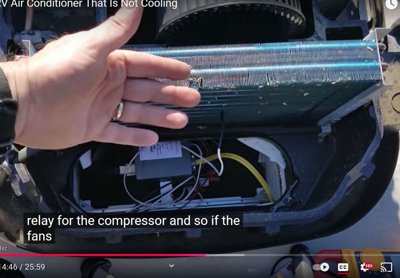

You should have a panel with circuit breakers and fuses. This uses 120V (gen or shore) to run the roof system and 12v (vehicle battery) to control it. Are you sure you have both 120AC and 12VDC at the terminal bock from the breaker and fuse respectively?
Old 09-14-2024, 11:22 AM
Join Date: Oct 2000
Location: Nearby
Posts: 79,755
Ok, and what should I be looking for when I find it? Remember, I'm getting nada power too the switch. Thanks again.
If you have checked input power, this is where the control box typically is (you can check the AC and DC here where it comes into the system):
From this video which shows basic troubleshooting of the unit.
https://youtu.be/3VckFAXg1CY?feature=shared

Best bet is to measure at the relay that is probably better accessed from the top. You should definitely have one to run the compressor and probably another to run the fan. They would most likely be controlled by 12v in (to turn them off and on) and pass 115 AC. Do you have either 12v or 115 at either of the switches/wires inside?
Before that, I would look for the 12v fuse that provides power (if there is no power at the switches). It should be with the other fuses (fuse block) ...assuming your system is typical.
