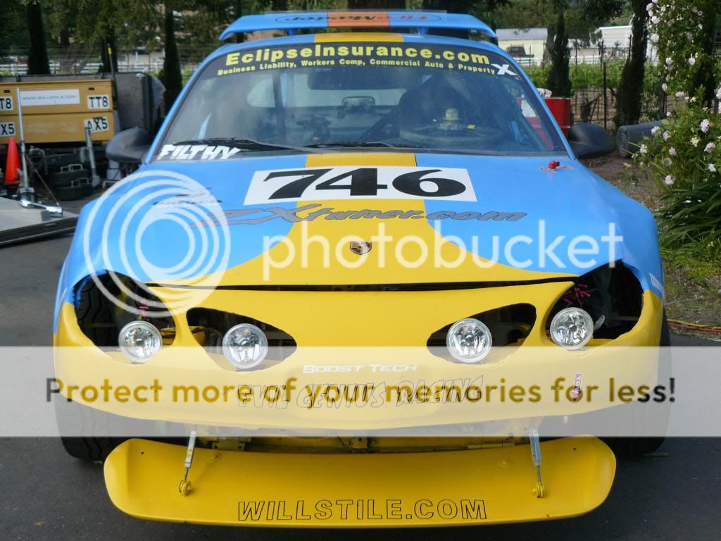

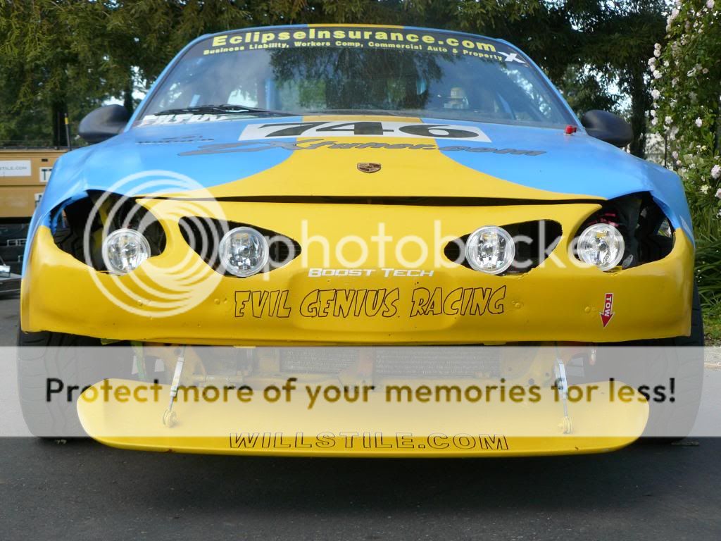

Adding two pairs of lights for our upcoming 24 hour race next weekend.
I want to use the factory wiring.
I removed the headlights from the car a while ago, but carefully reserved the wiring.
I want to wire the one set through the low beams and the other through the fog lights.
I can't get the wiring to power up.

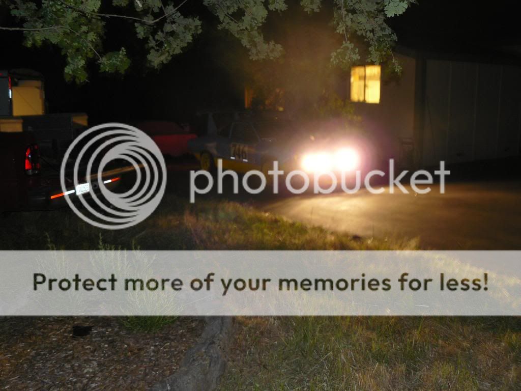

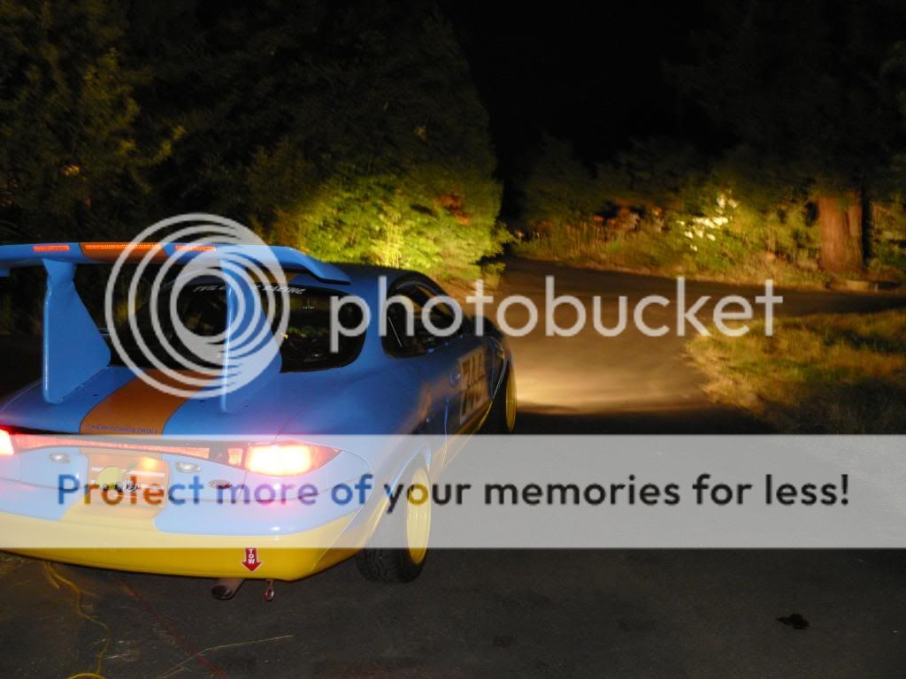

Todd suggested checking the headlight relay.
I had a spare.
That was it.
I'm all wired up and ran the car for about 45 minutes with all the lights on.
Even with the underdrive pulley, the alternator still produces 14.3 volts with 300+ watts of lights at idle.
