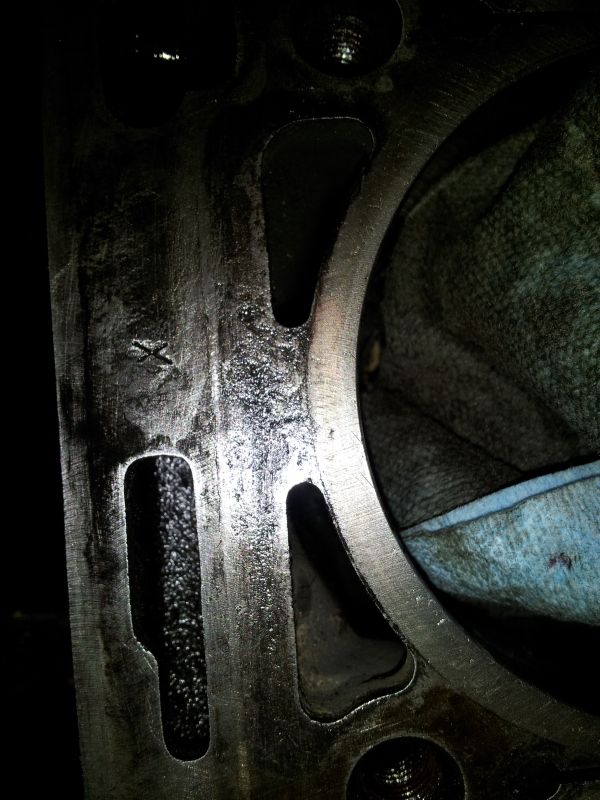

After cleaning my son's 190E block surface of all carbon deposits, I discovered these deep pot marks where the radiator inlets/outlets are:
So am I to assume it is shot?

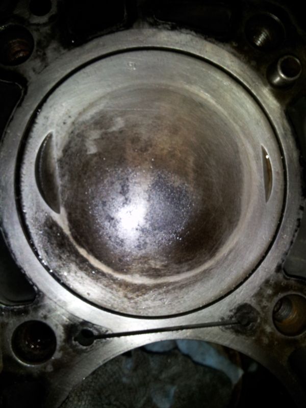

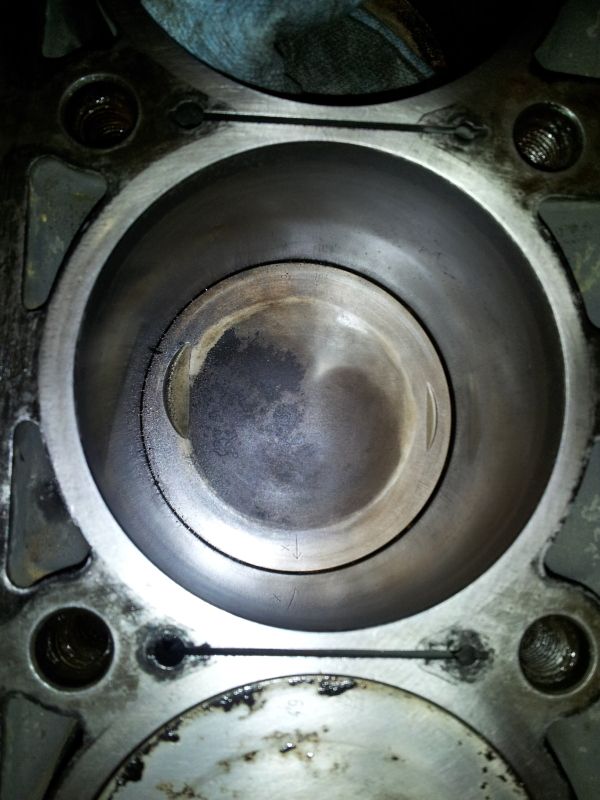

Here are the Cylinder surfaces, no pot marks, smooth and even:

Jim,
I would assume that it would be corrosion,although you wouldn't figure but if your head gaskets didn't leak before they won't leak next time around either !
I wouldn't worry too much my friend

Would it be too crazy to place some sealant there to take up the gap so the radiator fluid will not further corrod it? I have some engine case sealant from Toyota that could withstand the heat and pressure once dry or should I just let the OEM head gasket try to take up the gap on it's own?

Blue Hylomar from a spray can directly on the gasket. Thin and even.

If you can't find Threebond 1104, Go to the local Honda bike shop and get Hondabond. Same stuff just repackaged. Use a THIN coat.

sealant on the block side is not a bad idea, but it doesn't look too bad. The piston heads look good too (for that age), at least they don't look that bad if not too good.

Well, I spoke to Bill at Engine Machine Service, Inglewood.
Bill truly believes sealant is not needed if using OEM type head gasket but he will take a look at the pic and the gasket to make sure.
after ScotchBrite pink stuff is Kroil to keep it from rusting while I wait for the head.
He will be replacing the exhaust valves, resurface and valve work on my head next week No Crack, so relieved.

I would not use sealant either, I have done gazillions of head gaskets over the years, and see corrosion around ports like this frequently. I am quite sure a factory head gasket will seal that right up, and give you zero problems.

Bill is right. This (now that I see the whole thing) doesnt need any sealant. Looks fine to me.

you can trowel on some JB weld using a safety razor blade. jaguar recommends that FWIW. prep well, then block it smooth if needed.

I don't think you need to do the JB weld grout job on this. If you do decide to do it, in addition to degreasing the area, you'll also want to rough up the area to give the JB Weld good adhesion.
JB Weld is great stuff. I've used it to fix cracked radiators, mufflers, engine blocks..
