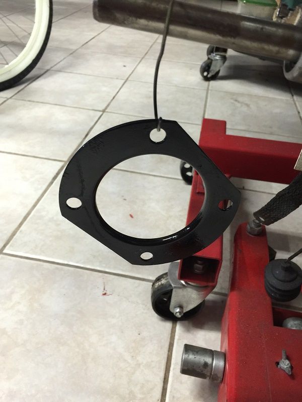

I knew one cover was completely corroded... I thought the passenger side was fine... nope, rusted as well... spare set that I had powder coated black will go in...

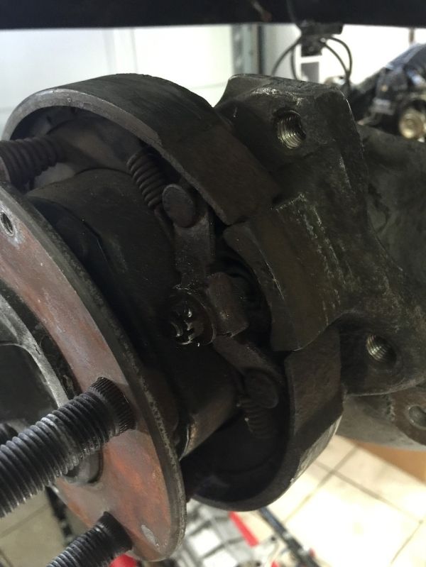

wachuko 02-08-2016 08:03 AM
As I removed the rear e-brake parts...not sure those will come out as nice as the ones in the 912 did... I might have to replace a few parts in there... I already have a new set of e-brake shoes... but thinking that I will need to get new springs, pins, etc... I will try cleaning the expanding bows, those I might save along with the adjuster... but the springs, concave washers, and those pins..have a lot of rust on them...
http://i151.photobucket.com/albums/s...psemp71eoi.jpg
http://i151.photobucket.com/albums/s...psqgp8ggbm.jpg
  • (4) 901-352-959-10 (superseded by 901-352-959-11) Roll pin
  • (4) 901-352-957-10 Compression Spring
  • (4) 901-352-955-10 Concave Washer
  • (2) 901-352-932-10 Return Spring Small
  • (2) 901-352-954-10 Return Spring Large
  • (4) 911-352-090-00 (superseded by 911-352-090-01) Expanding Bows
  • (2) 901-352-953-10 Compression Spring (goes between the bows)
EDIT: Used the discount coupon I got from Pelican for the Torsion bars... rear torsion bars are on their way.

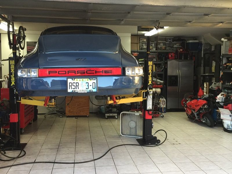

wachuko 02-08-2016 09:26 PM

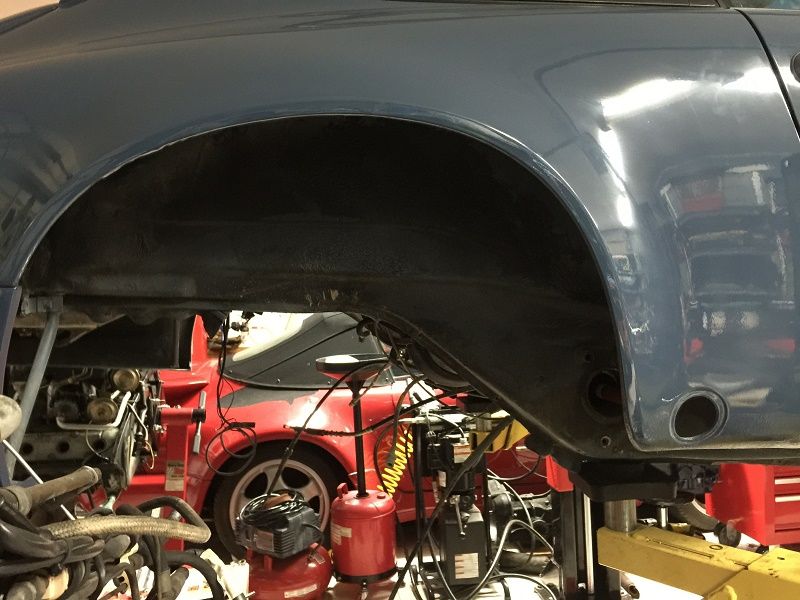

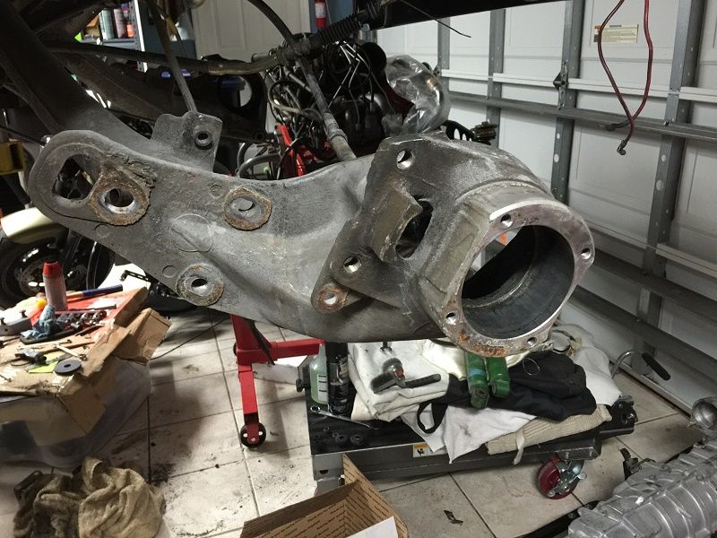

Removed the suspension on the driver's side...
This one was in really bad shape...
http://i151.photobucket.com/albums/s...psrgwuoybf.jpg
Bearing removed...
http://i151.photobucket.com/albums/s...ps72bpjk1p.jpg
Spring plate out...
http://i151.photobucket.com/albums/s...psh0evi2gs.jpg
http://i151.photobucket.com/albums/s...psew3k2weq.jpg

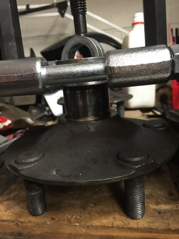

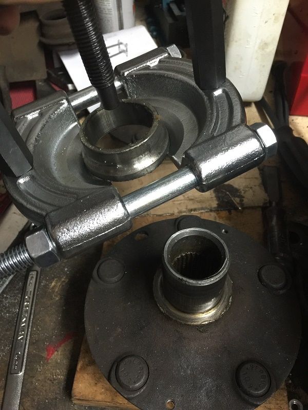

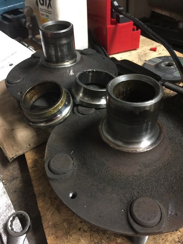

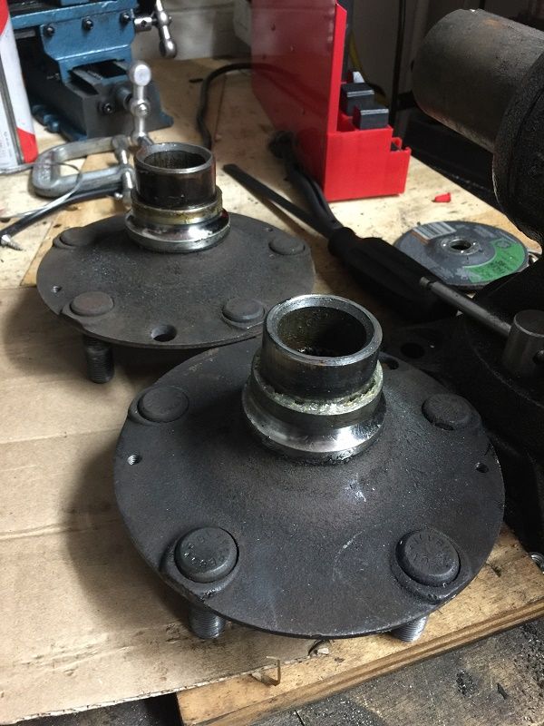

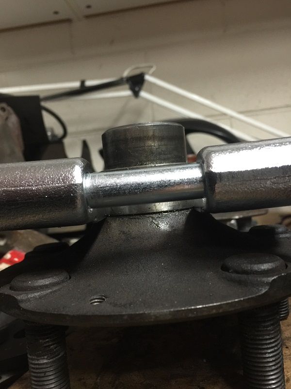

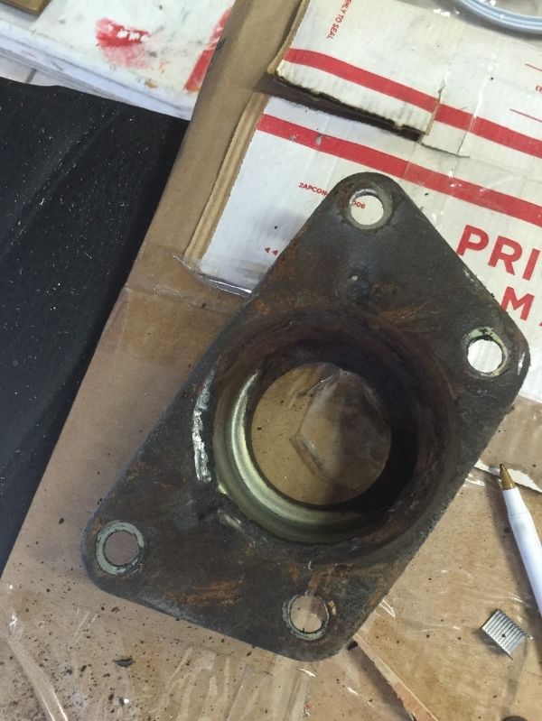

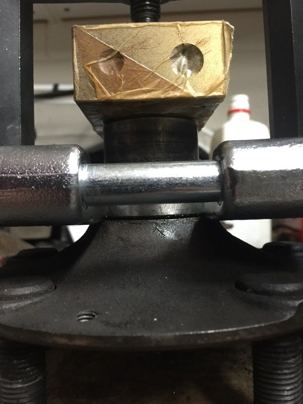

Hubs... need to remove the bearing race from them...
http://i151.photobucket.com/albums/s...ps5odgkijk.jpg
Will be using this for that...
http://i151.photobucket.com/albums/s...pshlzxwuha.jpg

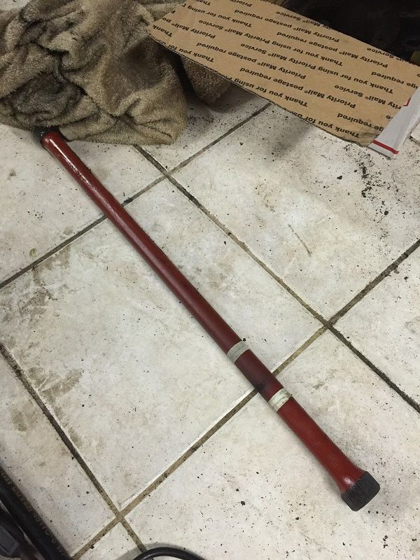

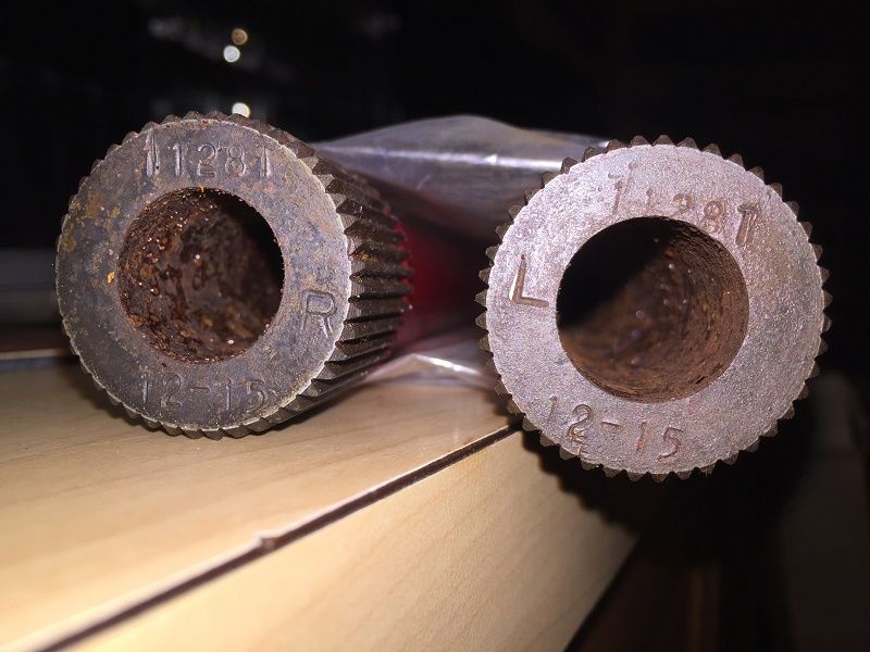

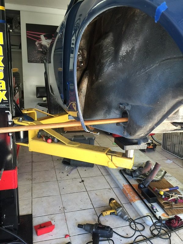

I was able to get one of the torsion bars out... the other one is giving me a fight :banghead: ...
http://i151.photobucket.com/albums/s...psxzrmu37n.jpg

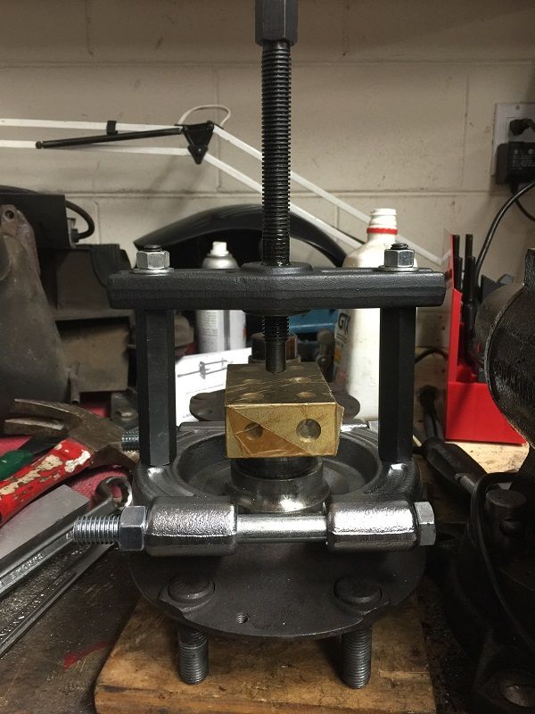

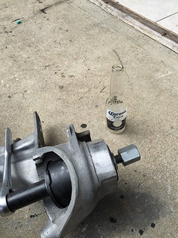

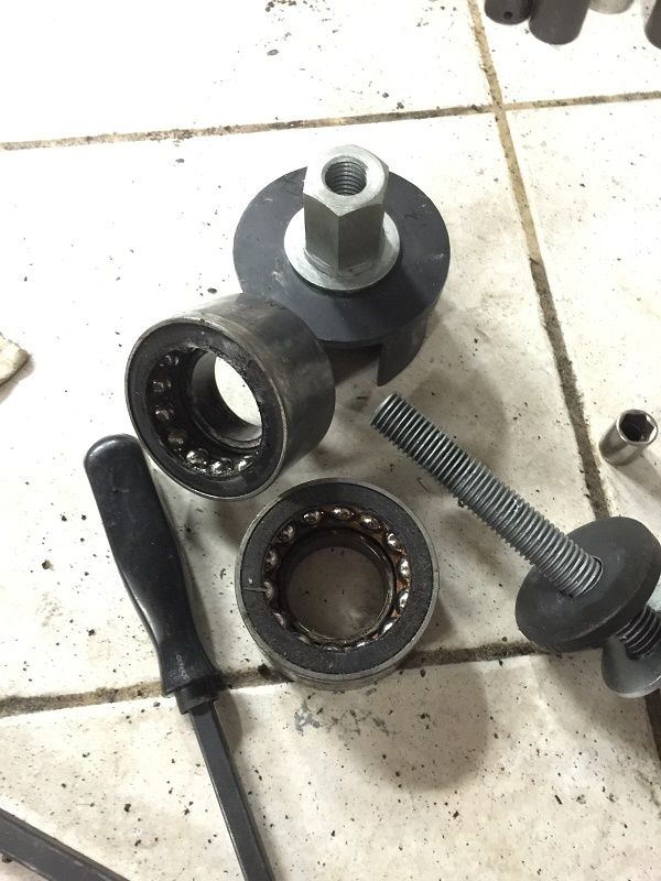

wachuko 02-10-2016 08:11 PM

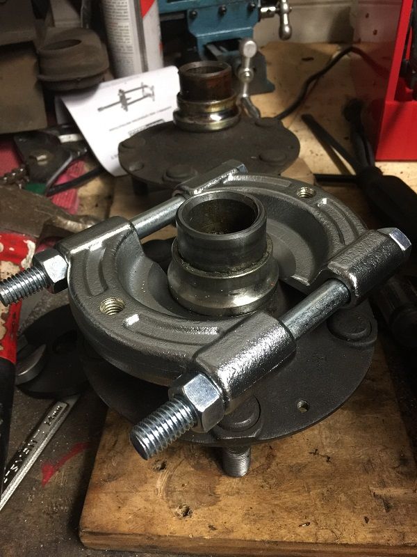

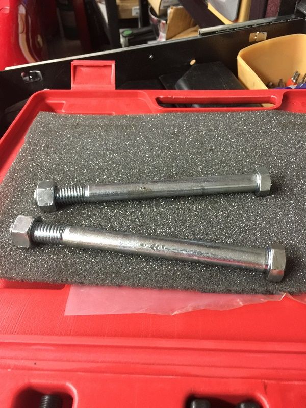

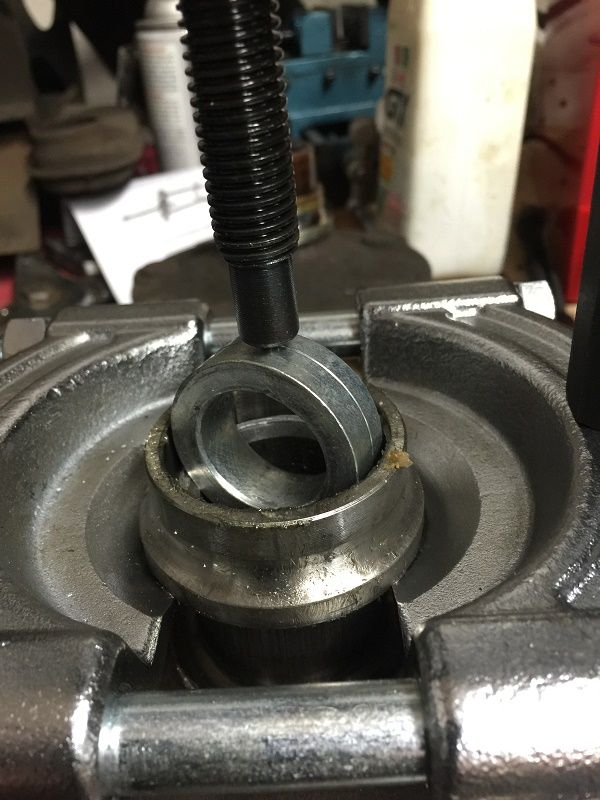

Well... got longer and stronger bolts...
http://i151.photobucket.com/albums/s...pssdavbuk6.jpg
And gave it a try again (yesterday night I could not remove the bearing races...)
http://i151.photobucket.com/albums/s...ps8thyx7iu.jpg
Look at that!
http://i151.photobucket.com/albums/s...psojoh7zfk.jpg

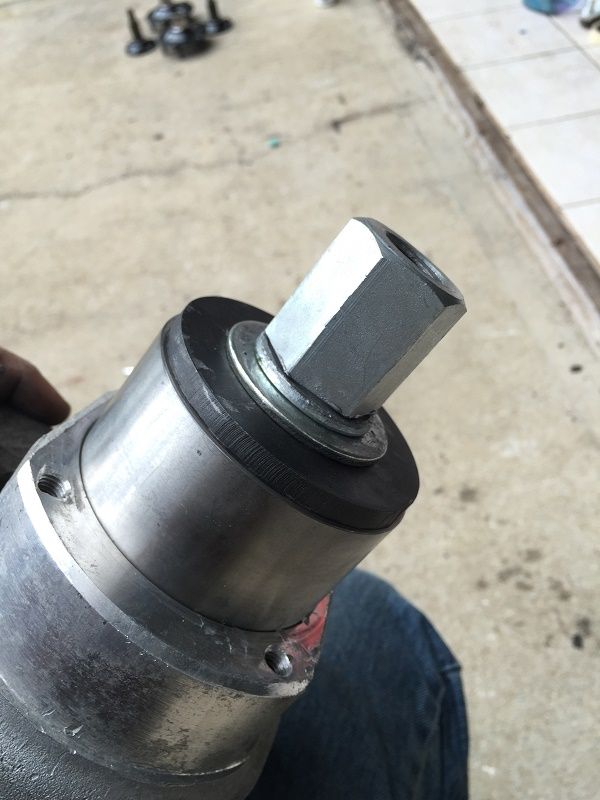

Let's use the puller now...
http://i151.photobucket.com/albums/s...psjvpz2qnb.jpg
It is coming out!!
http://i151.photobucket.com/albums/s...psosef3kkm.jpg
http://i151.photobucket.com/albums/s...psknkkil0x.jpg
Used a spacer from the bike for the rest of the travel... it was the perfect diameter
http://i151.photobucket.com/albums/s...psb2osbcha.jpg
http://i151.photobucket.com/albums/s...psyywvkg1j.jpg
http://i151.photobucket.com/albums/s...psbbsjprp5.jpg
Done!
http://i151.photobucket.com/albums/s...psfjbyzjh1.jpg

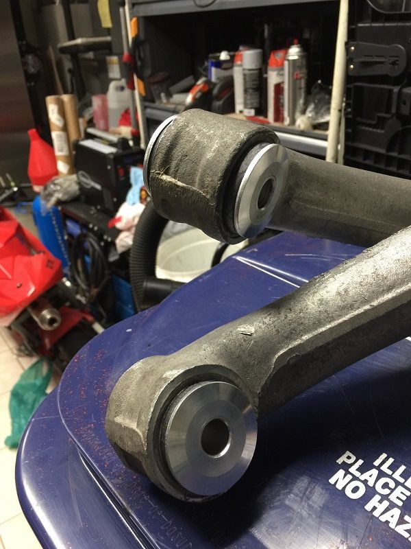

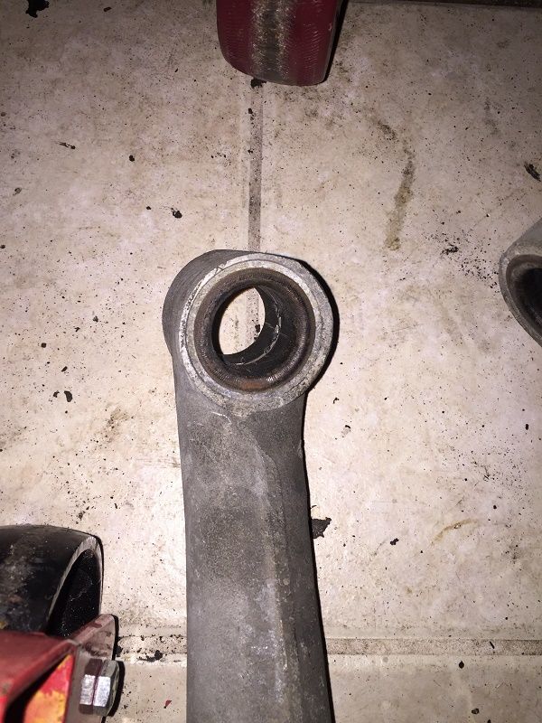

wachuko 02-11-2016 07:41 PM

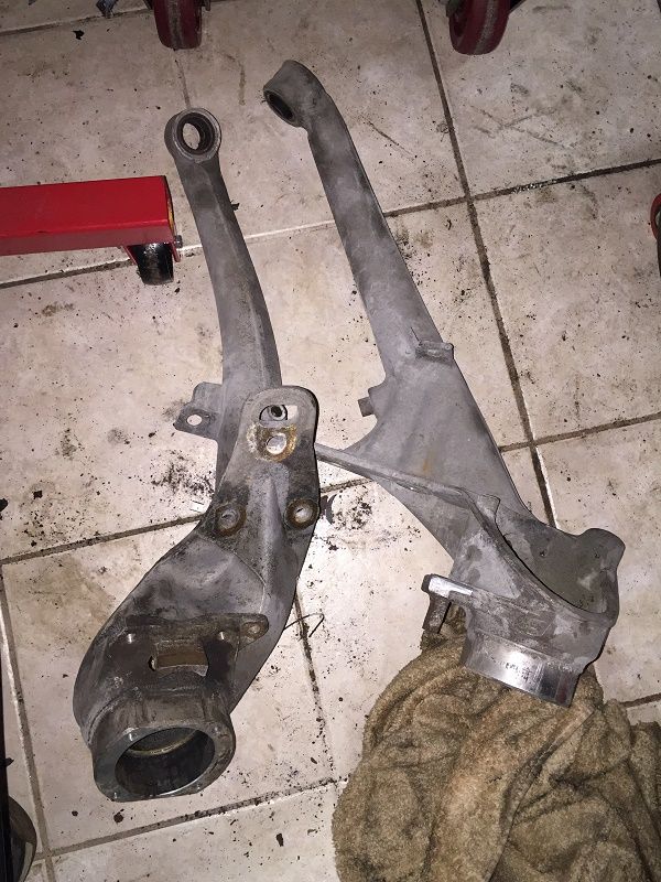

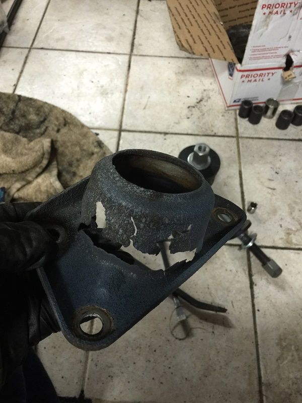

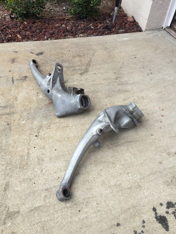

Rear-axle trailing arms removed.
http://i151.photobucket.com/albums/s...psp85f2jqm.jpg

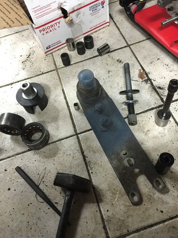

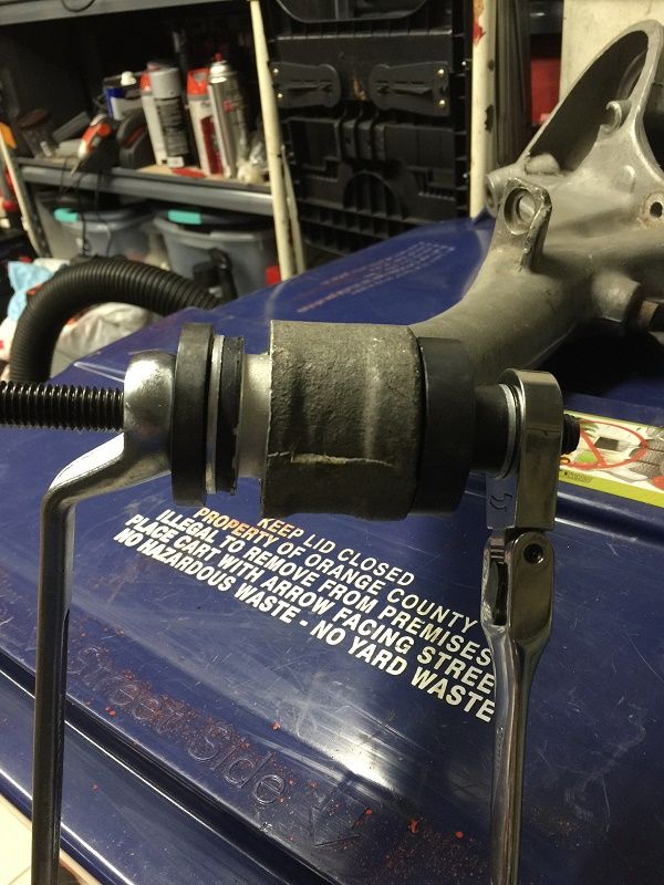

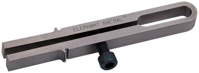

The inner pieces and rubber inserts were easy to remove... Now I need to press these out...
Elephant racing has a cool tool for removing the split bushings - Split Bushing Removal Tool but I don't feel like spending that kind of money (US$120.00)...
http://i151.photobucket.com/albums/s...psbs5no6n0.jpg
I can see that tool being great for somebody doing this often... I will go the chisel and BFH route...
http://i151.photobucket.com/albums/s...psrh7kptnq.jpg
Just got an email from Pelican that my order for the ER Bushings is delay because of some bolts that I added to the order....argghhh... those bolts I add just to take advantage of the order placed... and of course, I get the email at 10pm ET when they are gone and I can't tell them to take them out and ship... another day lost.... :(
http://i151.photobucket.com/albums/s...pscbius6zz.jpg

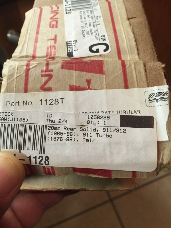

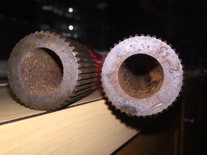

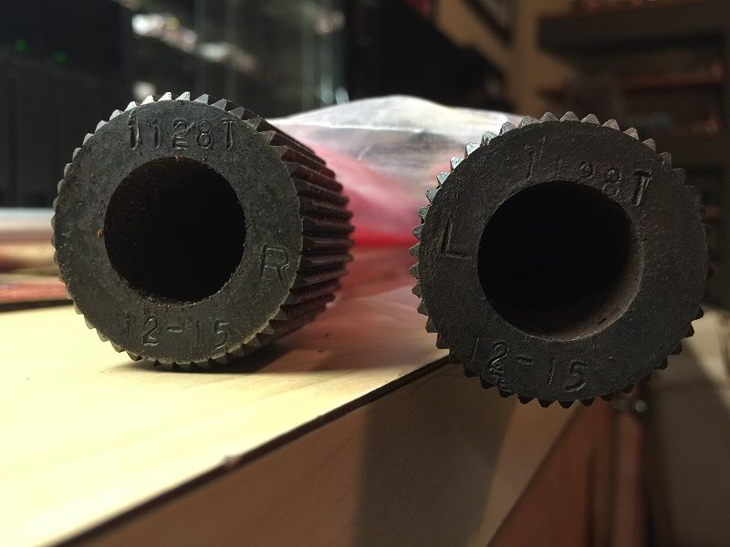

Well... this came in today... care to guess what is wrong with these photos?
http://i151.photobucket.com/albums/s...psw7ngsvws.jpg
http://i151.photobucket.com/albums/s...psrfgwiqew.jpg
http://i151.photobucket.com/albums/s...psqgdglyw9.jpg
http://i151.photobucket.com/albums/s...pshhhxvvbg.jpg
I know this is not Pelican's fault. These boxes are packaged at Sway-A-Way... but second order of products from Sway-A-Way (via Pelican) where I do not get what I ordered and the outside labels are correct, but the parts inside are not...
wachuko 02-13-2016 10:16 AM
Well... called Pelican, requested a return on the incorrect part and a credit... and ordered the Elephant Racing rear torsion bars from them as well. After reading several threads of bars breaking... I just could not trust those SAW bars long-term... front will stay as they are (Sway-A-Way bars in front). There is no logic to this madness...

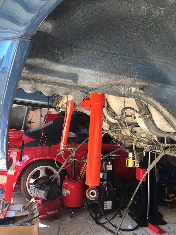

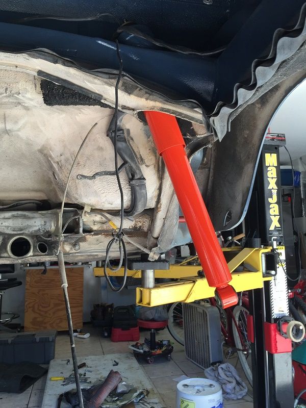

On other news... cleaning the floor of the garage again... but first, took the time to paint the rear shocks.
http://i151.photobucket.com/albums/s...psunrucwuh.jpg

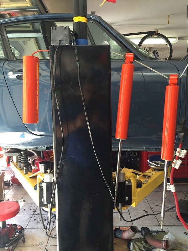

wachuko 02-13-2016 12:18 PM
One of the torsion bars would not come out... read somewhere to use a broom stick from the other side to get it out... worked like a charm!
http://i151.photobucket.com/albums/s...psusp4my3j.jpg
Installed the shocks...
http://i151.photobucket.com/albums/s...pscovriyro.jpg
http://i151.photobucket.com/albums/s...psgtzlwd5y.jpg

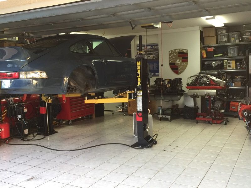

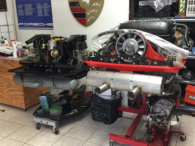

Cleaned and did a bit of more organizing to better accommodate the engines... so that I can walk around...
http://i151.photobucket.com/albums/s...ps0wuduhkw.jpg
http://i151.photobucket.com/albums/s...psuvcpwqef.jpg
These are ready and waiting!
http://i151.photobucket.com/albums/s...pshtprd55h.jpg

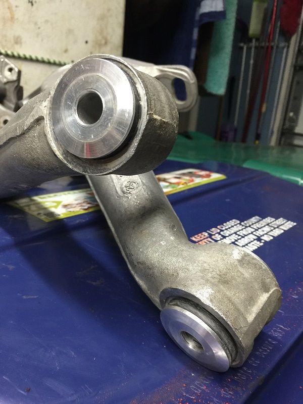

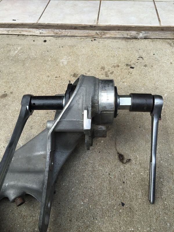

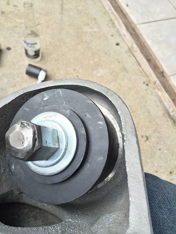

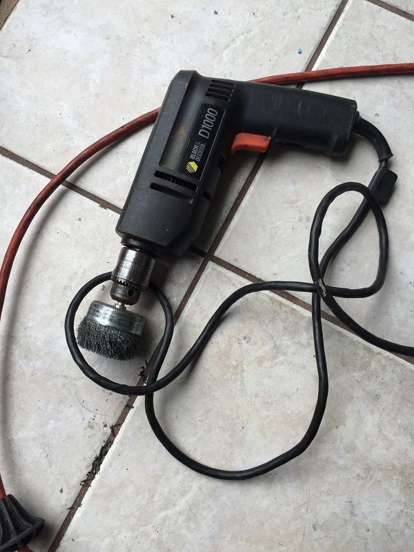

So I started to clean the trailing arms... tried this first...
http://i151.photobucket.com/albums/s...psb44owdht.jpg
That did not do much... so I went old school with a brush and some gasoline... voila! All nice and clean.
http://i151.photobucket.com/albums/s...psvazebll4.jpg
Then I removed the bushing inserts... now I am ready for when that order gets here (should be in Friday...)
http://i151.photobucket.com/albums/s...pswt66zjwf.jpg
Cleaned and painted these...
http://i151.photobucket.com/albums/s...psjlylr3ep.jpg
and these... Need to drop the other parts at Seminole Metal Finishing for the zinc plating...
http://i151.photobucket.com/albums/s...pshfn3u4ly.jpg

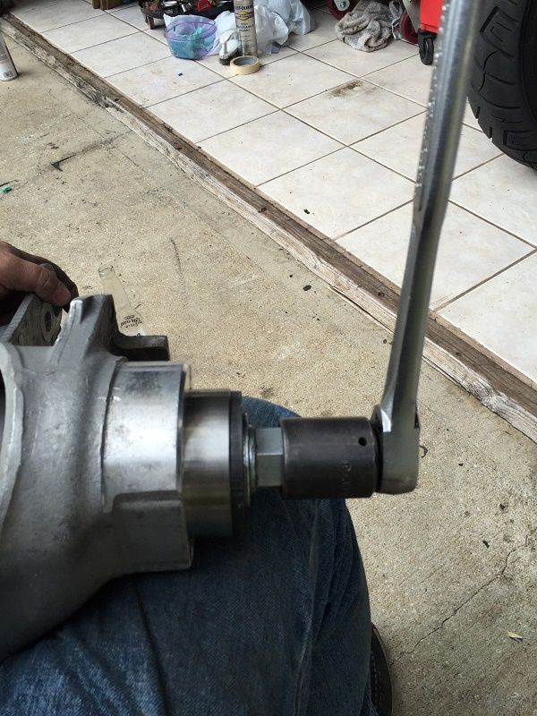

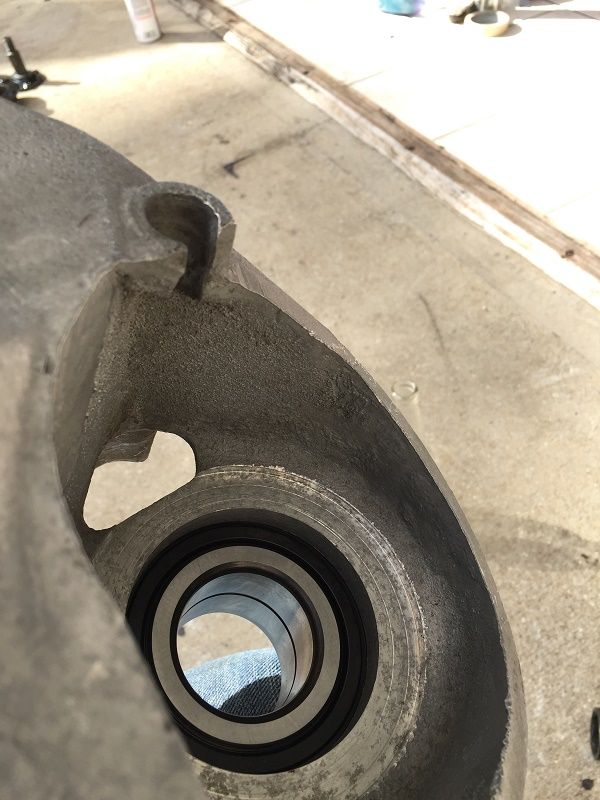

And installed the bearings...
http://i151.photobucket.com/albums/s...psry2u5ycm.jpg
Make sure that the top plate is centered on the bearing...
http://i151.photobucket.com/albums/s...psyejyulc0.jpg
No heating, no freezing of anything... just wrench away...
http://i151.photobucket.com/albums/s...psjqyk7p3e.jpg
http://i151.photobucket.com/albums/s...ps7jc69tyv.jpg
wachuko 02-14-2016 04:17 PM
With the tool... it is definitely a one beer job... but there are two bearings and then there is the staring at a job well done... so turned into a three beers job...
http://i151.photobucket.com/albums/s...psy8qnmtyw.jpg
http://i151.photobucket.com/albums/s...pszei0ndhc.jpg
http://i151.photobucket.com/albums/s...psil4ugobu.jpg

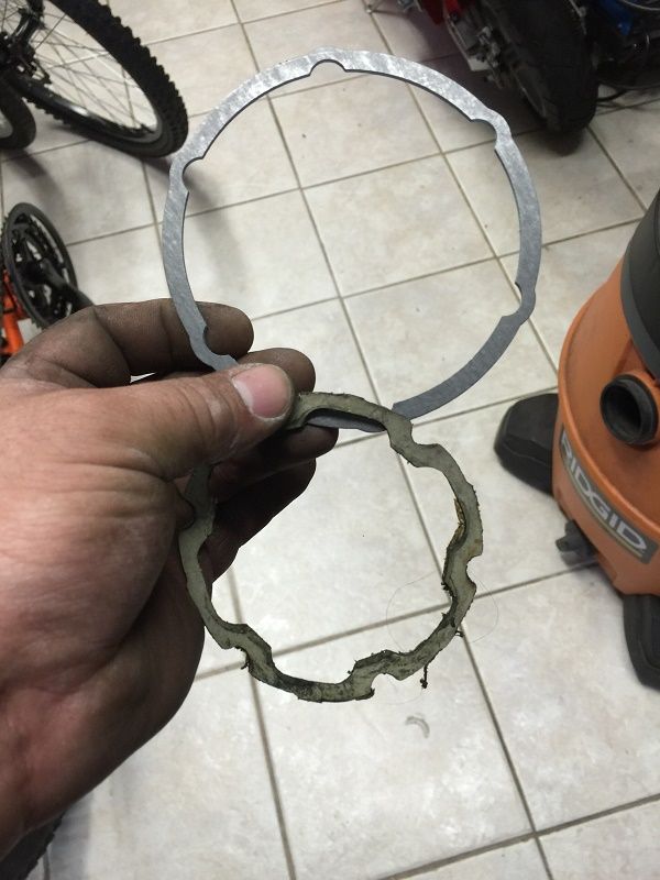

Looking at the parts for mounting everything back... noticed that I ordered the wrong gaskets for the drive shafts...
http://i151.photobucket.com/albums/s...psdearbcsl.jpg

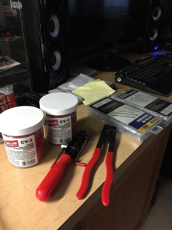

wachuko 02-14-2016 04:27 PM
Okay... gasket comes with the CVJ boots I ordered... we should be good there...
http://www.pelicanparts.com/catalog/...es/861094K.jpg
And not using the grease that comes in the kit... will be using Red Line 80401 CV-2 Synthetic Grease...

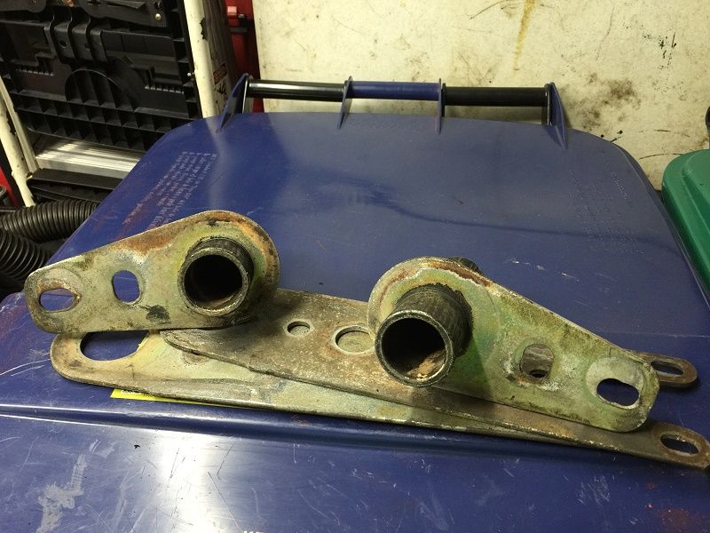

Last task for the day/night... removed rubber bushings from spring plates:
http://i151.photobucket.com/albums/s...ps1lpxnakx.jpg
These are going to get yellow zinc plated... need to decide if I install the black powder coated or these...

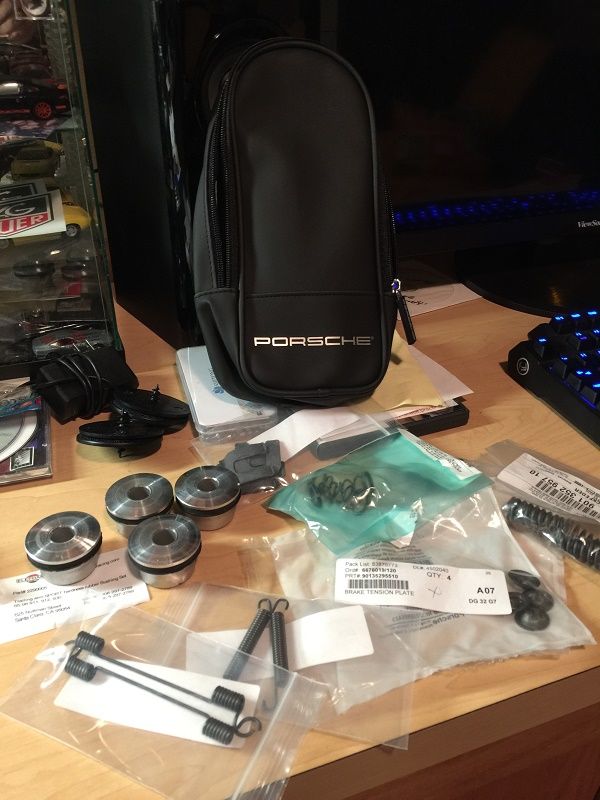

Under the weather fighting a cold... nothing done this week. But these came in for refreshing the CVJs:
http://i151.photobucket.com/albums/s...pskqyhuwpj.jpg
Trailing arm bushings should be here this afternoon as well... Rear torsion bars should not be too far behind...
Now...if this stupid cold would just move on...
wachuko 02-18-2016 05:48 PM
More parts came in... had to get that cool oil storage bag... have one in the 964 and in the X5... makes sense to do so in this car (so it does not feel left out).
http://i151.photobucket.com/albums/s...psupymeuqg.jpg

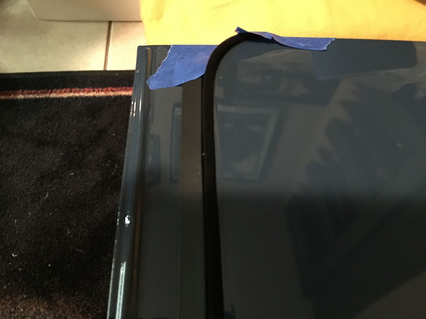

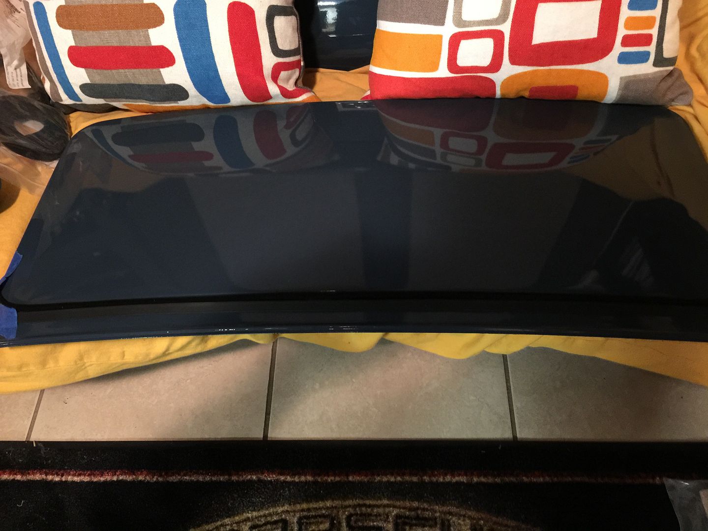

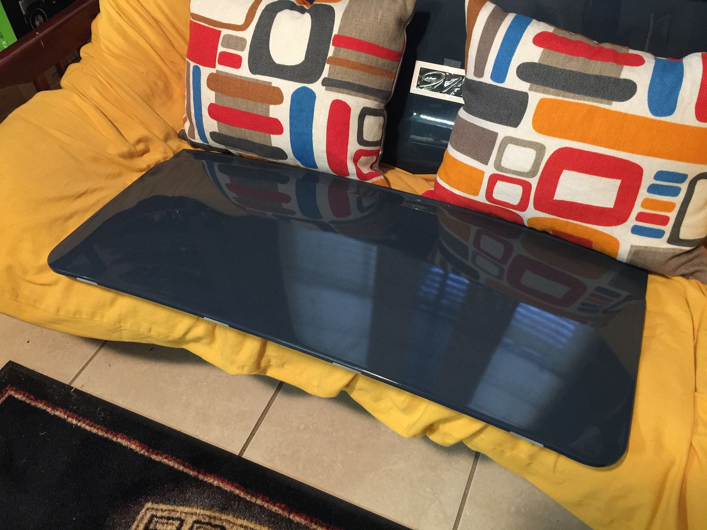

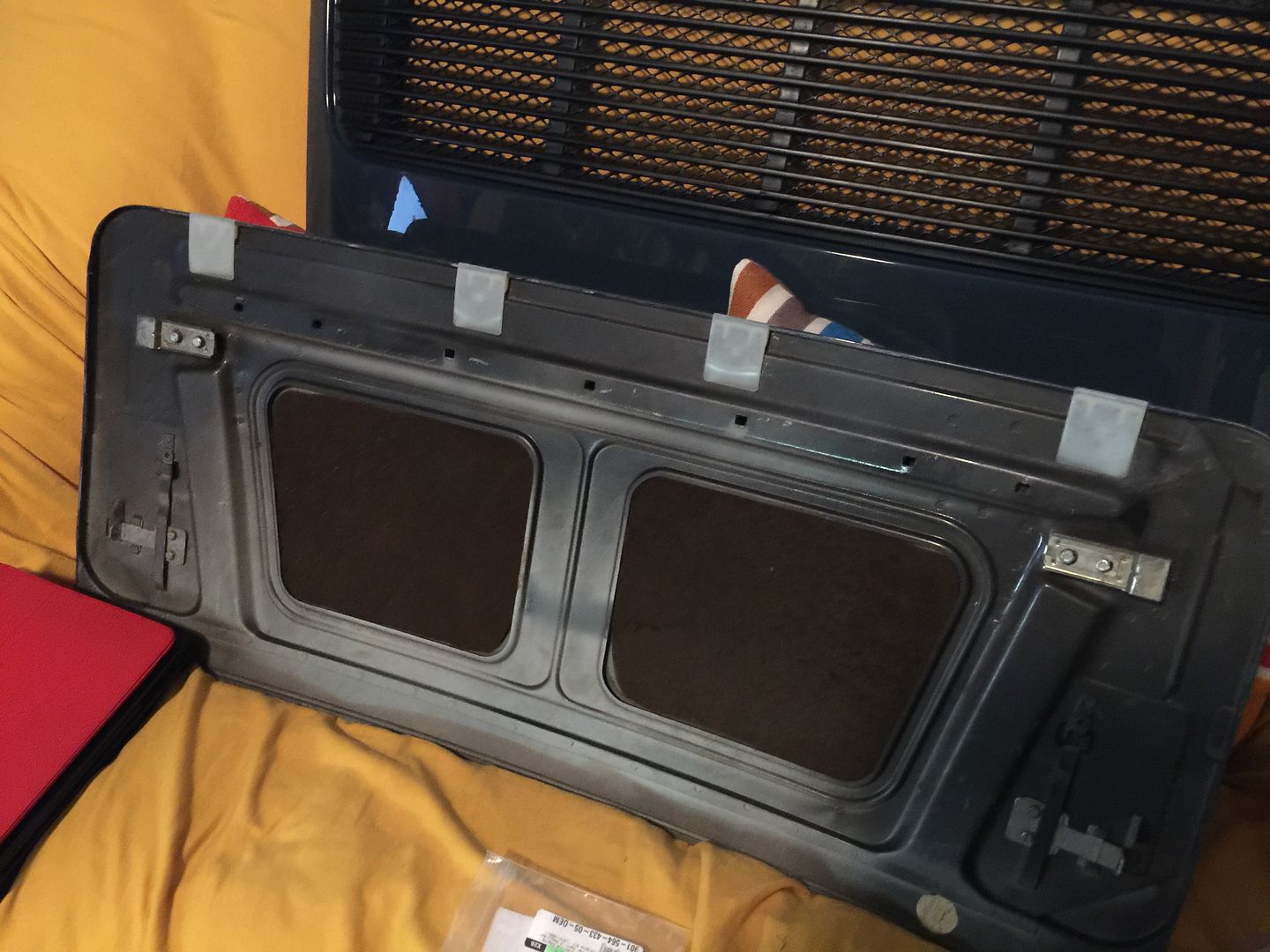

Sunroof... installing stuff back...
Plastic protective edging (901-564-433-05)
http://i151.photobucket.com/albums/s...sickyjivp.jpeg
http://i151.photobucket.com/albums/s...souenypmb.jpeg
http://i151.photobucket.com/albums/s...srmo2s1jn.jpeg

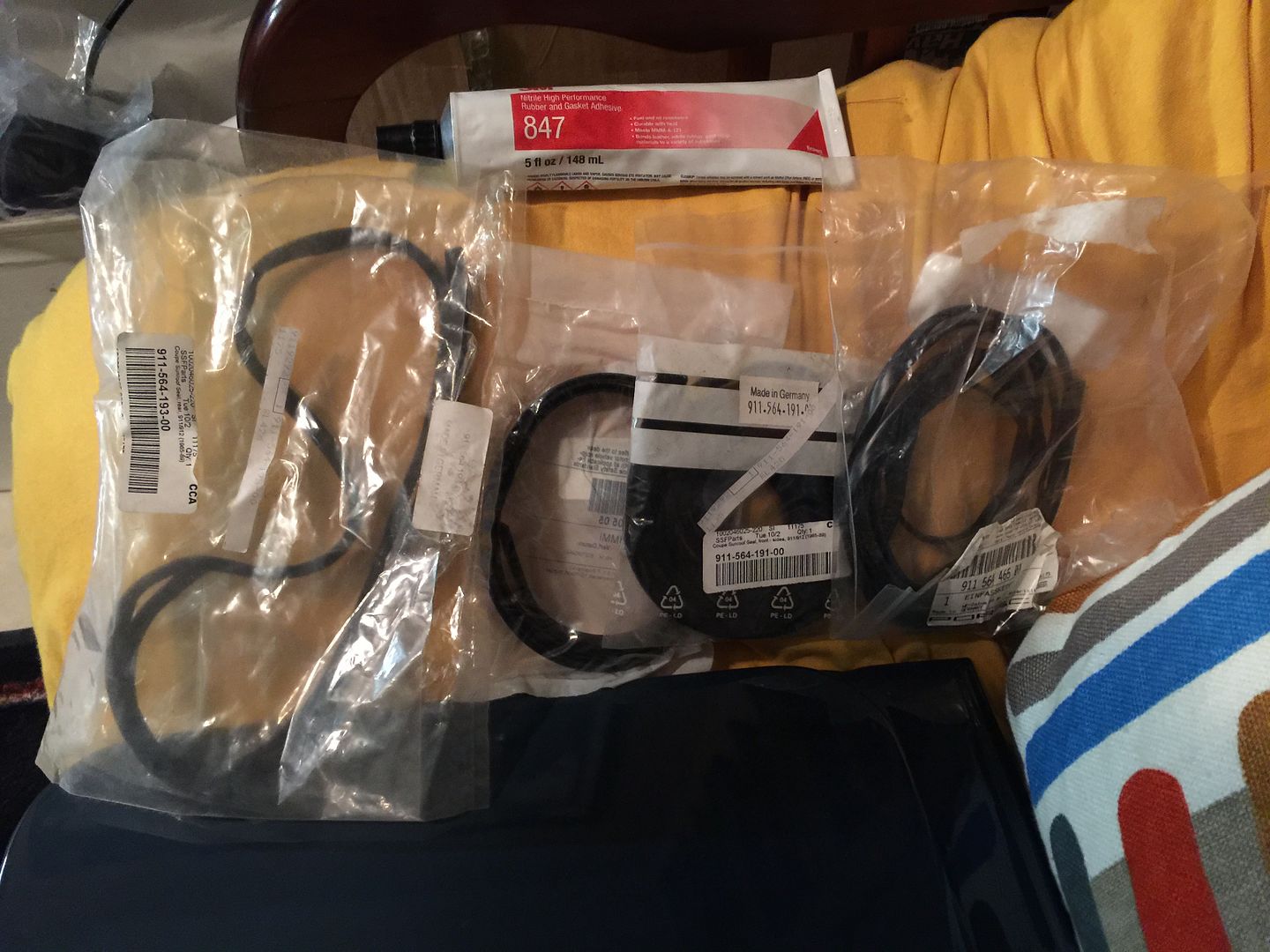

I have the clear 3M adhesive... was not aware that it came in black, found out searching for threads on installing the seals... (link)
http://i151.photobucket.com/albums/s...psotkldp8v.jpg
so ordered one and will be here in a few days... then I will install all the sunroof seals...
http://i151.photobucket.com/albums/s...s2jue5fq3.jpeg
Decided to tape them in place to get the memory out....
http://i151.photobucket.com/albums/s...sihx21hlv.jpeg
http://i151.photobucket.com/albums/s...szwwcr7ri.jpeg
