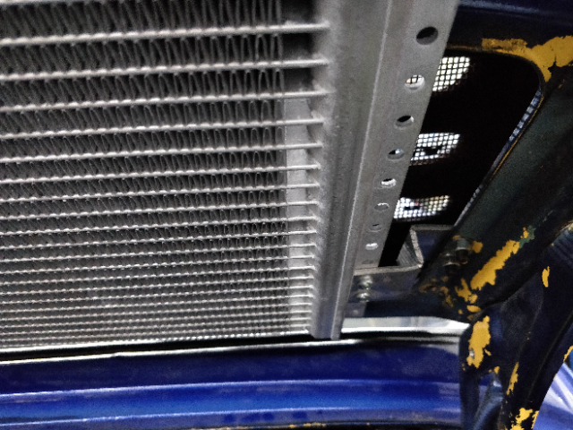

Docklid condenser clearance in a CIS engine
I spent the last 3 days trying to get the dick lid mounted A/C condenser to clear the CIS air box with no luck!, anyone here that has the rear condenser mounted successfuly on his CIS engine without any clearance issues??

I have one mounted in my SC without issue. It's tight though. I'll take some pictures of the mounting brackets and post them for you.
Lou
Old 08-19-2018, 05:29 AM
Join Date: Jul 2012
Location: MA.
Posts: 1,051
My photography skills are lacking...not sure any of these will help.
Lou

Here is the Retroair (now Classic Auto Air) rear condenser installed in my 87 Carrera. I used Griffiths hoses for this install.
Center Mount
Left Mount
Right Mount
When mounting the condenser check the grill T-bolts, 911-559-433-00, clearance. I needed to shorten the long ones to get enough clearance.
For the center mount I used high density foam weather stripping from the hardware store instead of the low density Porsche foam, 911-537-141-00. This has held up well over the last several years.

Thanks a million guys for the pics. It seems that I need to move the condenser much closer to the lid, I will try to fabricate a couple of Z shaped aluminum brackets to do the job, the L shaped brackets that came with the kit does not permit that.
Thanks again ISF911 and HaroldMHedge for the pics!

You should not have to make new brackets. Mine was a tight fit and I might have bent the condenser left and right mount for better alignment.
Before making new brackets try loosening the hinges slightly and then fit the condenser.

Just measured my rear condenser's thickness in the fin area. Lucky, I still have the factory one in storage. Measured with a cheap digital caliper.
Porsche 34 mm
Retroair 26 mm
So you gain about 8 mm additional clearance.

I managed to get it installed with about a millimeter to spare!, I fabricated two new brackets using a 1/8 in. thick aluminum sheet plate that I had laying around, here are a couple of pics of the final fitment :
Thanks again guys for the help!
