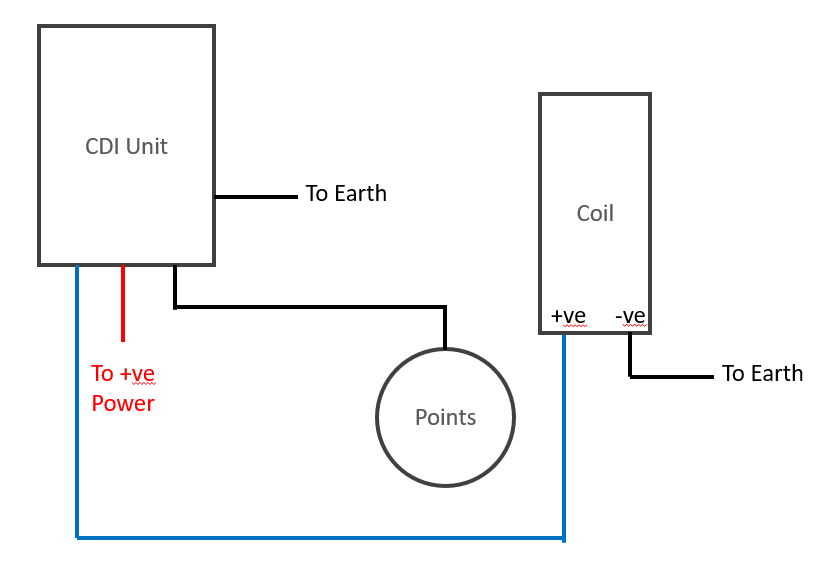

and im back
put everything back and no start again.
borrowed a new cdi box from a member... thank you
new cap and rotor and wires..
cdi box has the hum like it should.
with key on i get NOTHING to the dizzy or coil.. also when i move the points i get nothing at all

it runs!!!!!
reading this ....'75. No spark, no power to coil.
the interior gound wire going to the cdi was the issue. fired right up like weekend and bernies.
going to test the permatune now.

Wiring diagram for 3-pin
Thanks everyone for all the help. One addition I wanted to make was how to wire the CDI unit in. Like many of you, I was dealing with an old and brittle harness. What I thought was a CDI unit issue, was in fact a shorting issue in the harness. Many hours with my ammeter trying to figure it all out is what that cost me (oh yeah and needlessly buying a new Permatune unit $$$$$). Since you've all helped me, I wanted to share how to simply wire the CDI unit into you car, if like me you decide to start a new.
Good luck all.
