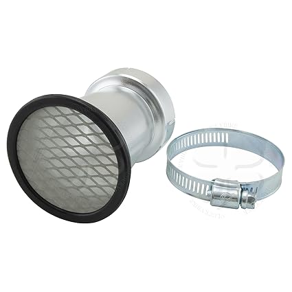

I've gone thru a few different setups with my triumph ITB setup.
At first I used some UNI foam filters without a velocity stack under them. This filtered the air but didn't handle lean pops very well - the foam ended up splitting near the flange on 4 of the 6.
Next up I tried these motorcycle v-stacks with metal mesh filter cap on top. Cheap junk. The caps with the mesh kept blowing off.
Moved on to the PMO rain hats and K&N with the weber style stacks. This worked great but the mounting required me to use these things:
If you look closely, they aren't round but oval and add another restriction point before the throttle plates. I can actually feel a difference between the motorcycle stacks (no filter) and the rain hats. Top end felt sluggish with the PMO setup. Disclaimer - the PMO kit is nice and probably doesn't have this issue when used with their carb or ITB kits.
So I'm ready to try something else and would ideally like a velocity stack that has a reliable mesh filter on top. I need the throat to be 52mm or 2". Prefer height to be 3"-6" but not too picky here. I'd also prefer the set of 6 to be somewhere under the $200 it i could.
Anyone got anything similar they could recommend?

Hi Nux. I'm looking for both. I think I found a solution combining Evan's plate and welding some 2" tubes to it that protrude enough upward to where i can use my clamp-on velocity stacks inside of the PMO filter/rain hats. The weber compatible stacks aren't exactly the same diameter as the triumph ITbs either so this will allow me to get rid of them too.
I'll try to post a pic here when I finish getting them made.

I tried my hand at drawing up my design in Tinkercad. Considering I've never messed with this sort of thing before, i found it pretty intuitive and easy to use. Plus, its free so win win.
The tubes are 3" long. Not sure how that will impact the "tune" of the stacks but i think longer is better right? I should be able to still close the engine lid with the rain hats on top.
I plan to use my cheapo velocity stacks on top and then rubber couplers to connect the plate to the throttle bodies.
I'm probably going to have to order a handful of these to reach the shop's minimum order qty so after i get them fitted i might have a few sets available to share. PM me if anyone would like one for cost plus shipping. I'm thinking around $175 for both sides. I'll know for sure once I place the order with the local machine shop.
