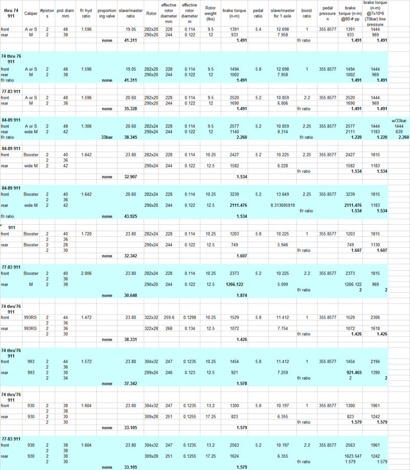

Continuing the Brake Upgrade Discussion with my thoughts and info.
Starting Point: 911SC, 2,900 lbs wet, est 215 rwhp, R888R Tires, Stock SC brakes & Hawk HT-10 pads, Motul-600 brake fluid
Problem: brakes are toast after every track day. Long pedal after cool down, Spongy and need to be flushed.
Also: frequently, I see the front bearing caps leak grease onto the wheels. Must be getting pretty hot to liquefy HT grease.
Pads look toasted too: Note the heavily checked surface, crumbling edges, and paint burnt off the back sides. (This happens after the first runs) HT-10s are very high temp pads by Hawk, not many more options except DT-60/70.
I read almost all of the Brake Upgrade threads. A lot of good info. Unfortunately, 930 brakes are no longer a cost effective option. The calipers, if for sale, are just not affordable in 2018.
Used Bill Verburg's data to see what I am getting into.
Researched the Stop Tech path, and concluded Level 1 (ST-42 caliper Front Only) really doesn't get much except a much wider front rotor. You have to jump to the Level 2, front and rear to make a real difference.
I am now thinking the Rebel Racing Boxster S/996 upgrade might just be the affordable upgrade.
The Boxster S/996 upgrade (front and rear) seems to offer a lot for about $2,400 investment: Gain 40% more pad area, 28mm wide front and 24mm wide rear rotors for heat dissipation. Need 930 master cylinder. Bias shifts forward, but can be compensated with higher friction pads in the rear.
A Hybrid configuration with Carrera rear Wide-M caliper gets the 24mm wide rotor, better bias, but you are stuck with the tiny brake pads
I color coded the parts by configuration, My SC = Yellow, etc.... And the pad area percents in yellow are the Boxster S/996 increase from stock SC area.

Mike, while I like the 996 front a full 996 setup ios still more front biased than I like to see. The main issue w/ that is it puts more of a load on the front and lets the rears loaf.
Stock SC has a torque bias of 1.491 which is right where you want it.
full 996 is 1.811
996 front w/ C3.2 rear is 1.743
930 is 1.579
Of these you stock are best except for the heat issue
to address heat
are you using A-arm scoops? Ducts tend to be too small to do much good unless they are really big.
are you using Castrol SRF?
what pads? I'm assuming you have track pads
changing fronts to the Carrera 3.2 calipers and rotors helps a little
993 can be adapted w/ not too much effort, they would use 930 rotors f & r, front caliper adapters are available and some slightly tricky but doable mods to the rear calipers bias is 1.572, you would want 16s for this

Mike, a couple of questions first, then some thoughts. That's what my pads used to look like 35 years ago when I was first tracking my '83 SC. Back then I was still just an intermediate driver and there wasn't a lot of products available to upgrade the brakes.
Questions- Please don't take this the wrong way, but what level of driver are you? And have you done any brake cooling yet?
The reasons I ask this is because all the guys (and ladies) who race in PCA Club Racing E-stock race class are running stock brakes on both SC's and Carreras. They race hard all weekend and don't tend to have brake issues. I've raced a friend's '88 Carrera for 40 minutes and never lost faith in the brakes. And I've raced and tracked my own SC's and Carreras with stock brakes and never had issues once they were properly set up. Granted I now have 996TT brakes but also a lot more engine and suspension, but ran with stock Carrera brakes for 30+ years.
Also, the longer one is on the brakes going into a turn, that's less time for the rotors to cool between turns. I've always found that novice and especially intermediate students of mine tend to brake earlier and carry the brakes longer than the hard core advance drivers and experienced racers. It's a skill that has to be learned over time, but that's why so many of my intermediate students have more brake issues than the more advanced. Again, not to insult your skills, I don't know what level driver you are, just offering 30+ years of instructing observation.
Here's what I did, and many E-stock racers.
First on an SC, just change to '85+ Carrera brakes. This allows you to run 24mm rotors in the front which are wider and a better heat sink, and the rear calipers increase from 38 to 42mm to move some of the bias rearward and take some of the load off the fronts.
You need to move lots of air at the front brakes. If you can't put ducts in your front valance, you need to grab the air from somewhere, typically with the scoops that hang under the front control arms and duct up to the eye of the rotor. Helps a LOT.
Not a fan of the HT-10 pad, not a great hard trackwork pad. I've run either Hawk DTC-60 or 50, or the corresponding Pagid pads. True race pads.
I have always run Motul 600, never boiled the fluid over the course of a weekend.
Those are all relatively inexpensive things you can do to improve the performance of your brakes before going to conver$ion$. As an example before I went to the big brakes on my current '86 Carrera, I ran stock Carrera calipers and rotors, had Ruf style front and rear bumpers so I ducted air from the inlets in the lower front valance directly to the eye of the front rotors, ran DTC-60 pads, Motul 600. Granted I was 2650# and ran 23/34 torsion bars with revalved shocks, but back in 2010 I ran VIR 6 full days on the old R888 tires and never touched the brakes until the end of the 5th day when my pads were just plain worn out. No fade, no spongy pedal. Same thing that year, ran 3 days at Mid Ohio back to back with 3 days at Blackhawk Farms, no brake issues. All in the instructor group.
Sorry for the lengthy response, hope it helps before you jump off the deep end and into the world of expensive upgrades. I went to 996TT brakes because they were given to me so for just the price of some Instant-g hardware I was done. But only because I had the 3.6 in my garage to build up for the car.

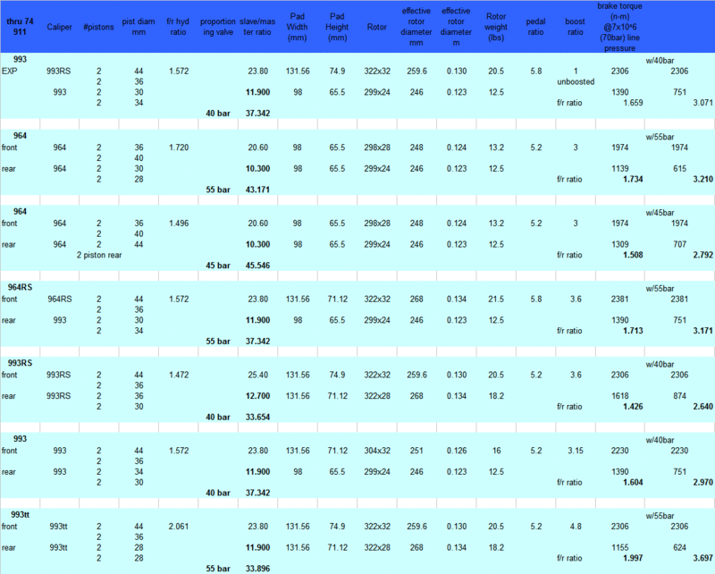

One other option to consider; 951 front brake calipers are a decent bias match with the stock Carrera rear calipers, both use the 24 mm Carrera rotors. I added a 930 M/C and use Raybestos ST-43 pads front & rear along with GS 610 brake fluid.
This combo allows me to run 35 minute sessions on the big track @ Fontana in the summertime on + 100 deg F days. Track temp, +160 deg F
That's essentially the same as 996 front but w/ smaller rotors bais is ~1.5 to 1.7 depending on some specifics
The full 996 front w the 318x28mm rotor would be really nice if you could get something in back to get bias down to ~1.5 +/- unfortunately all the Brembo mono blocks that are good candidates are 28/30 unless you can scrounge up a set of 997RSR 28/36 rear or modify 993RS 30/36 rear, neither will be easy or cheap.

If you use the 996 front w/ a 964 2 piston(44) rear on 3.2 rotors you get 1.588, if you use 930 rear rotors that goes to 1.544
As I said, nothing unsafe about a extra front. It's just not getting all that can be got from the back.
The heat issue is all at the front so anything that lightens the load whether its less mass to stop or more rear bias it all helps

I'm wildly outmatched in knowledge, but why not just 'upgrade' the brakes to early 964 C2 F&R?
Nearly identical to the f/r bias of SC, but aluminum calipers that will weigh less and shed heat more efficiently and larger rotors with more thermal capacity.
*this is totally my plan for my car. but for unsprung weight loss as opposed to a racing application*
Here are most 911 setups
most 964 & 993 setups
some 9111 common setups
dual masters
964 4/4 or better 4/2 on all 930 rotors is good, I used the 4/4 on 930 for years very successfully till I went to 993RS on both my cars, this is overkill on a 911 unless you have a 3.6 or better but these are real hand of god brakes w/o any heat issues.
Again the typical SC/Carrera has no need of these. The standard solution is all 930 because they fit under 15s but the 964 on 930 is close enough but you need 16s
Bill Verburg

Wouldn’t 964 4/4 bias be the same as 996 f/r at about 1.7?
Btw, I’m finding the carburetors paired with DC-40 cams are pushing the SC a little faster everywhere I go.
I’m only 16”. Phone Dials
while bias is important the real critical issue is thermal performance
using a stock 911 20mm front rotor as a base
3.2 has ~20% better thermal capacity
930 has ~86% better thermal capacity(actually more because of the better internal geometry but I can't quantify that)
996 has ~78% better thermal capacity(I need to look into the internal geometry)
Bill Verburg
