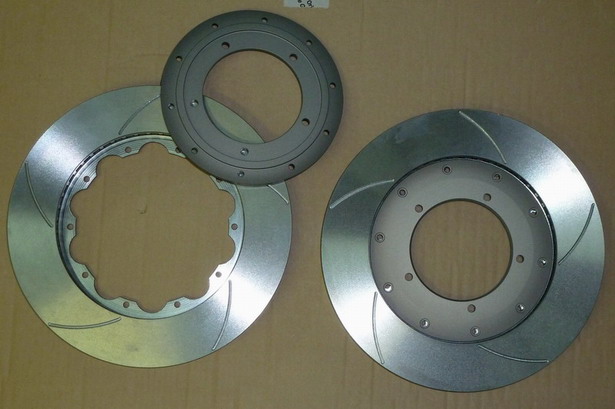

After a lot of thought...
First Step:
1) Wide-A calipers
2) 84-89 Carrera 24mm rotors
3) Pagid RSH-29 Pads
4) Keep brake cooling scoop and plumbing
5) delete the hub blocker plate (better hub cooling)
$200 for the used calipers, $148 for new rotors.
After this, if I still see fade, sponginess, venting brake fluid, and weeping bearing caps at Thompson Motor Speedway, then I will upgrade more.
In mid-July, when it hits +95F humidity, and after the second run, I'll know if this was enough.
I still think the StopTech Level 1 Front is a good option. The upgrade directly adds significant rotor cooling with a 28mm wide floating rotor, with much more efficient spiral cooling vanes. Plus it is a drop in, with no other mods.
Since shedding rotor heat is the solution, both Rebel Racing and StopTech offer 28mm wide floating rotors in the front. Both should be able to dump a lot of heat, with the Rebel rotor at 318mm vs 282mm being better.
The conversion to the Boxster S/996 caliper adds a lot of extra work; 930 master cylinder and 14mm front wheel spacers. (new studs) but also gains 24mm rear rotors.
The front 996 caliper spaced for the 318 rotor fits, but just barely on a 16x6 ET36 Fuchs with the 14mm spacer, and similarly just fits a 16x7 ET23.3 Phone Dial without a spacer.

I'd add brake fluid to the list, The best all around is Castrol SRF, there are others that have higher dry Bps but none w/ a better wet, The wet is the one to go by.
As for the other kits
the main issue is getting enough rear brake to balance the front and get the best utility from the system, the 996 aka Boxster s front is great, particularly so if the rotors have a floating annulus, the the Boxster S rears only give you a bias of 1.814, when you want more like 1.5 or possible a little less if the car is setup right. Better bis can be had if you use the Boxster S front w/ stock 3.2 Carrera rear, this is 1.544
Another option is to use 993 rear on the Carrera 3.2 rear rotors this gives 1.483, issue is I don't know how doable that is, I've used the 993 rear on 930 rear rotors but they are much larger than the 3.2 rears

here's another example of a brake up grade that is purely cosmetic,
The only issue w/ stock 911 brakes when used on the track is heat management, or rather the lack of adequate heat management. The heavier or more powerful the car the more the issue arises.
Heat management is centered primarily on the rotors and secondarily on convective processes that cool the rotors. To that end better thermal performance is obtained form larger and better designed rotors, the design comes from the geometry of the internal structure. Larger rotor is straight forward, but what's not so obvious is the internal structure. 911 rotors thru '89 have an older less efficient straight vane design, modern rotors will have curved vanes, these are chiral, ie there is a left and right structure and when installed on the correct side flow more air.
The calipers you link to are certainly cool looking but they use the same old stock 911 rotors, only now due to larger caliper pistons they are trying to force more heat through the rotors which were already deficient in that regard.

That’s the dilemma with the upgrades. All seem to mess up the bias, or cause issues with adapters and worse, cutting tangs off the rear swing arm. I’m not going to do that.
So that’s what brings me back to the stop tech front upgrade.
The large 28mm wide floating rotor is the direct path to shedding the heat. Except the 930 rotors, all others are the same 28mm wide.
I checked the piston size for the ST42 caliper and it is only minimally larger, so the bias is close.
The downside is the rear. But again all upgrades are 24mm wide with varying levels of complexity in the path, with the Wide-M as the most direct, with a rear bias increase.
I also appreciate the dialogue because it forces me to think it through from multiple perspectives. May or may not agree. But smarter for the effort.

If you use 300x30 rotors then it's an upgrade, otherwise not, you'd want them in back too
The weight is not a significant factor here. yes, it's nice to lower unsprung weight but that isn't a primary concern.
W/ most of these sort of kits the f/r bias also goes out the window, no way of knowing w/ more details, but from what I've seen of Stoptech and Brembo kits, the consensus is to provide overkill in front and let the rear slide, this is the safe way to do things but doesn't utilize the the braking assets to the fullest extent.
If you want to use them great, I wouldn't
