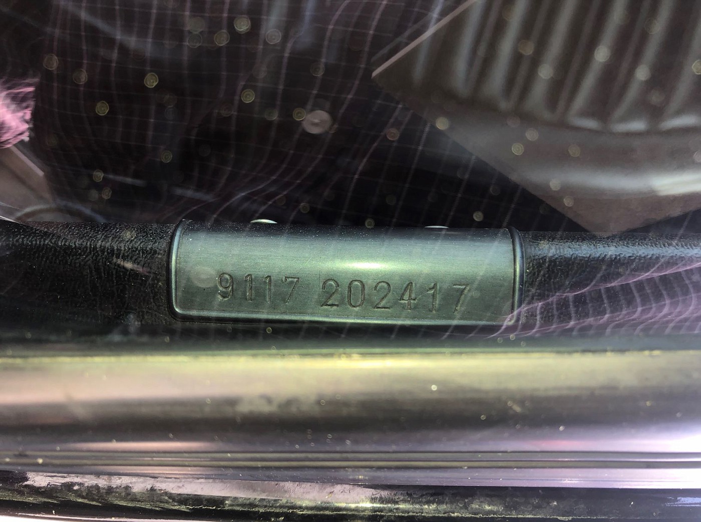

The VIN matches between the A Pillar and Frunk.

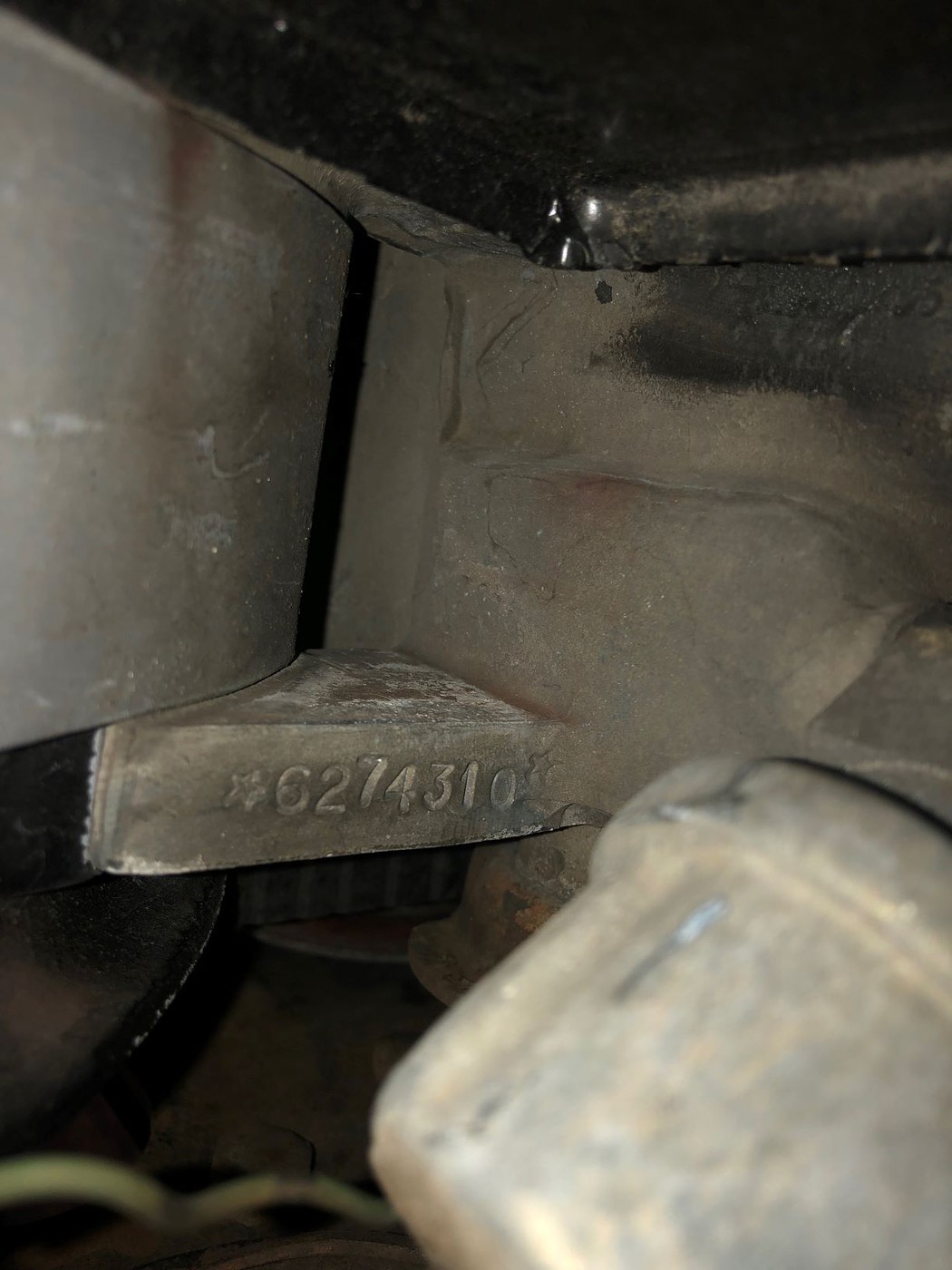

The car is a 1977 911S Coupe. I believe the engine code and engine type are fine.

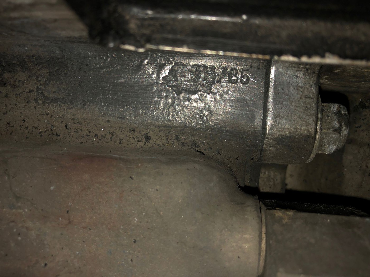

On the type code, I see 911/85 (or 35), but can't find reference to either...

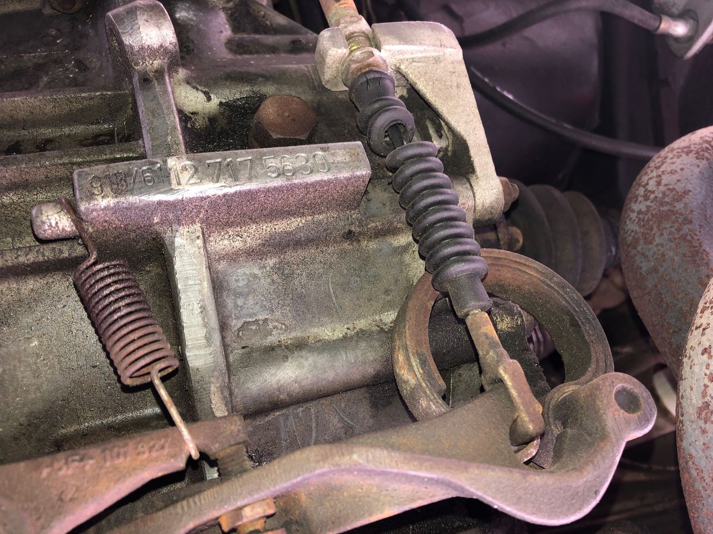

I can't find information on the Transmission Code - any help there?

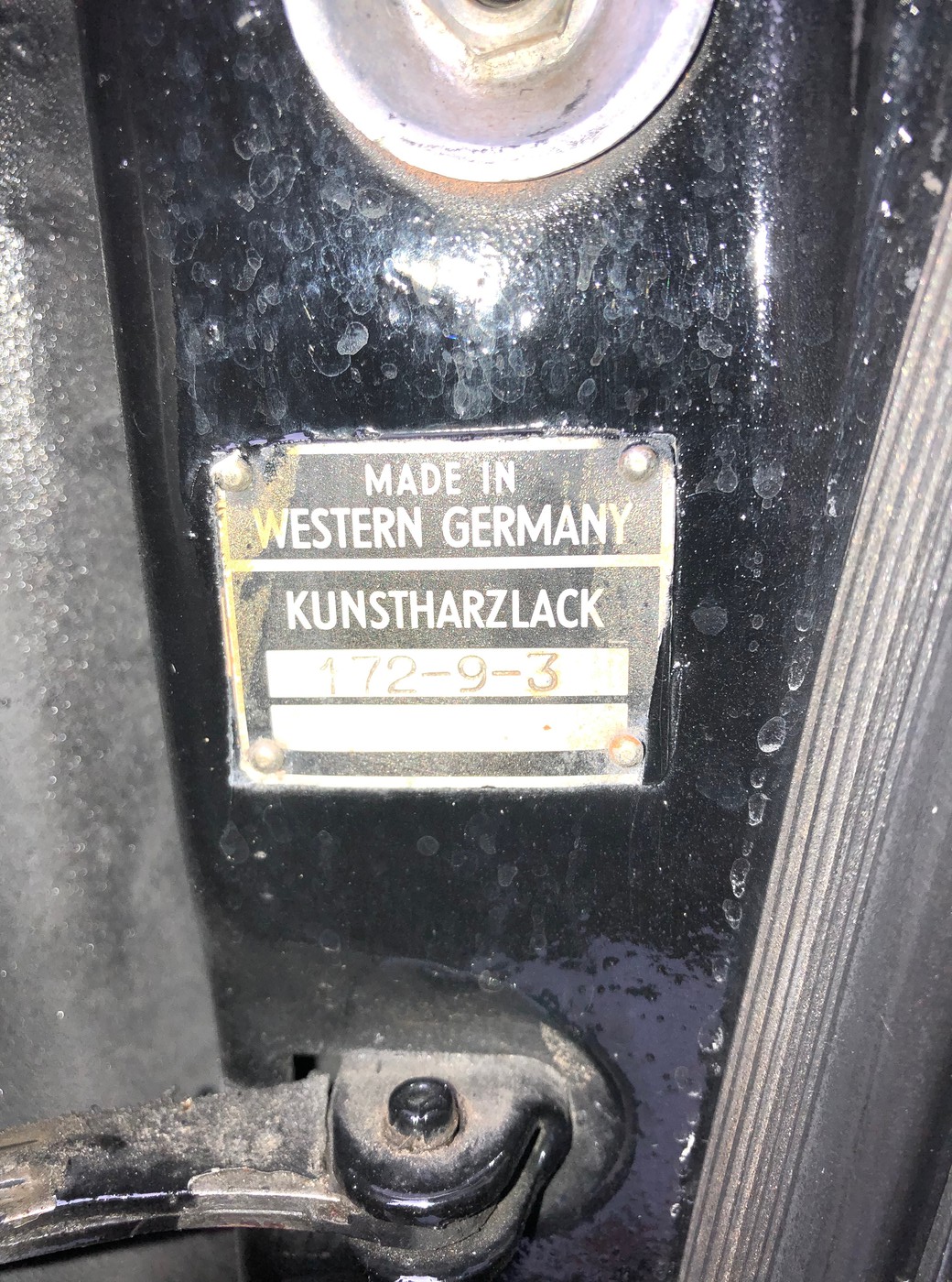

Finally, the paint code... I can NOT find any reference to the paint code that I see at the door jamb in front of the drivers door. Can't find color "172-9-3" anywhere I search... Lil' help?

You won't be able to tell if that engine and transmission were those delivered with the car without a Certificate of Authenticity (or whatever they call them now) from PCNA. What you can tell is that you have the correct types. Engine 911/85 and gearbox type 911/61 are correct for a USA 1977. And the engine serial number is in the right range.
Incidentally, the 12 after the gearbox type indicates it came from the factory with an LSD.
Only thing I can find regarding paint code 172 is Mercedes Anthracite Grey. What color is the car (although the paint overlap on the paint tag suggests a repaint)?

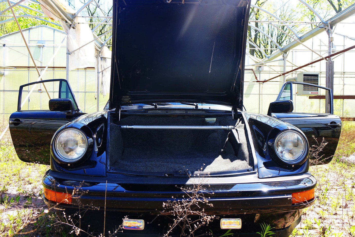

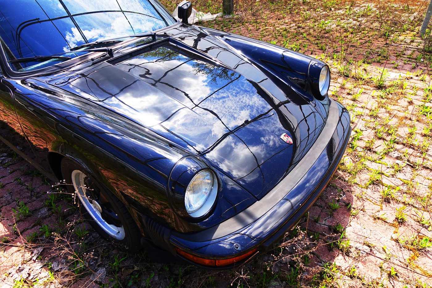

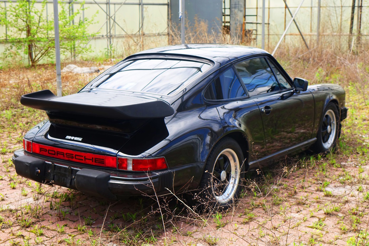

It is definitely a good quality respray on the car now:

"Numbers matching" on a 911 is totally different than old American iron. On old American cars the parts like the starter, brakes, alternator, water pump, and so on were also numbered and date code stamped.
All that really matters is does it have the correct engine and transmission, and does that really matter if they work as designed? Obviously the chassis numbers all need to be the same or the car was cut up in the past and that can be real bad. But if the VIN on the chassis parts match the title, the rest really don't really much matter.

Paint looks to be Copper Metallic originally.

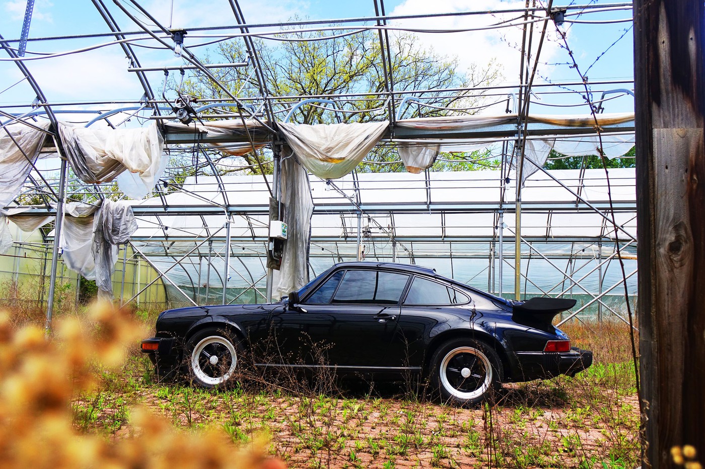

Am I the only one wondering why the heck you would you put your Porsche in a bunch of nasty weeds for the photo shoot? And why would you drive it under a rickety old green house?
Is this what an "artistic shot" looks like?

Value wise, non original paint is one problem. Original color was likely what can be seen above the trunk Vin stamp on the smugglers box cover, and in the door pillar above the paint tag, showing under the light switch. Tail also is questionable. Engine is in range. Type 911/85 would be correct for US 911S. By 1977 all 911's were S type. Trans would most likely have been a 915/61 type, LSD only can be verified with a CTC. Might have been added later and then stamped with the 12.

Clearly this is the new frontier- a genuine greenhouse find.
