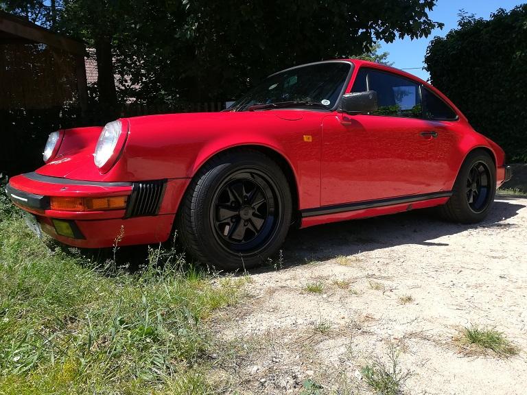

Hi guys,
Quick question, I have a 1985 3.2, chassis WP0ZZZ91ZFS**
Engine sais 930.101.104.5R
So I assume it's a ROW version with the higher compression?
But it's also an American imported car, with the American bumpers, taillights and head lights, so I was wondering if it's a 930/20 or 930/21 as I'm not sure how that works...
Any thoughts?

most likely it is Euro Model Picture will help.Look for the engine number on the right hand side under alternator...i have the same 911 on the end ...1032 and you?

Some things could have been changed from the RoW car when it was federalized into the US. The bumper shocks, headlights and tail lights are pretty easy to change to the US type. There are some things that likely were not changed, however, and they would have been somewhat difficult and/or costly to do.
Some things to check for:
- fender mounted repeater signal lights
- the VIN mounted to the dash near the driver A-pillar
- the type of VIN plate mounted in the trunk
Kevin

Things to check;
- ROW does not have a catalytic converter
- ROW does not have a lambdasonde
- ROW does have a rear fog light (switch)
- ROW has amber rear light, US red
- ROW does not have side lights in the front bumper and rear light clusters
- ROW does have side repeaters
- ROW does not have the metal plate with the VIN in the A-pilar
- ROW does have an aluminium plate with the VIN number near the color code sticker
- ROW has 930-20 engine (high CR and 231 HP) US has the 930-21 engine (lower CR and 217 HP)
- ROW has KM/H speedo US has MP/H speedo
- US has shift up light in tacho
- Most US cars have AC and most ROW specs cars of that age do not
You should be able to determine if yours is a ROW or US spec now :-)

good info ..as the OP has written the win number is only for the rest of the world it cannot be us market car with..... ZZZ... in it...

Wpo zzz is a rest of world car. Proporsche is correct

Do the 911s carry both VINs like a US 928? On the 928 the chassis is stamped with WP0ZZZ while the A-pillar and door sticker will have the US designation WP0JB0 or similar. I guess I can look at my 911 when I get home to confirm if no one knows off hand.

Yes. All 911 bodies have the zzz near smugglers box and ‘true’ vin on a pillar and door sticker.

So the question is what did the OP mean when they specified "Chassis" number ZZZ. if they were getting this from the smugglers box area it doesn't indicate that it is or isn't a ROW car.

it has MPH speedo, it has a cat with lambda, it has US bumpers (rear was replaced, so that's why it's not US), it has the US rear lights. Front lights were also replaced so not sure what those were
On the other hand... it has a ROW vin, it has side markers...
So what is it?

a grey market 911 that was updated to be us-legal? see https://en.wikipedia.org/wiki/Grey_import_vehicle

..i`d say read above ...your is ROW imported to USA and it went through the inspection process to be legalized ....so it is ROW and legal in the states..what else would you like to know?
BTW you clutch cable is twisted and the Omega spring would love to see some -WD40 the least;-)

That VIN plate behind the windshield is not an original item. Looks like someone made that and put it there. Definitely a ROW car that was Federalized.

all the imports have this home made windshield plate..i had one too but got rid of it the 1st day i got mine 911;-)

Tranny oil cooler seals the deal. Euro 3.2, but changed other stuff so it could be imported to US (changed in US).
