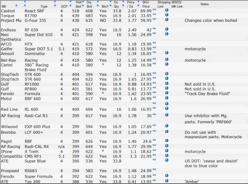

Wow ATE Typ200 (used to be able to get in blue also for easy bleeding) is 536°/388° and also wouldn't make that list.
Quick question, do these hyper fluids have decent life or do you have to change / re-bleed often?
As a few answers have said...it kinda depends. but here is some real world usage and what we and our customers experience.
If you're going to go on the track, use a quality DOT4 fluid. SRF, Motul, ATE, AP, Willwood, etc. All are good.
A Higher wet boiling point (WBP) allows you to not have to FLUSH the system very often - just a quick bleed after a weekend or two. As the post from the Wilwood info indicates, all fluids will get some moisture in them over time. Sure, you can flush the system every time just before a track weekend and you'll be fine, but there's no need. Higher wbp means that even though some moisture has gotten into the fluid, the fluid can handle it for longer and at higher temps. Many (most) PCA racers I know that use SRF only flush the system once a year. Quick bleed before each race weekend is it.
So while SRF is certainly more expensive...it effectively lasts longer so it may actually be cheaper in the long run.
Again, this is going from what many of us do in PCA racing, and what I see in BMW and SCCA racing.
If you actually WANT to flush the fluid out more often, go with the highest DRY boiling point, since the fluid will never really have time to get much moisture in it.
Answer is, It depends on the thermal stress levels seen in use. Back in the '70s before miracle pads, & brake fluid iused to go through a set of pads and need to flush the brakes after a single day at LRP, the car was a Carrera 3.0 so similar to what VFR has, these brakes are stressed especially so when the driver is ham footed about using them. Flash forward to The 21st century, track car is a well set up 993, I can use ATE200 all season w/o a flush or bleed at any track I've been to, w/ a single exception, the group was black flagged at WGI after ~40min in an hour session on a 95F day, sitting on pit road waiting to go back out w/ foot lightly on the brakes to prevent rolling, the fluid boiled and I had a very soft pedal to the end of the session, reason was the pads were worn way below where I usually change them out. I switched to Motul 600 as a precaution.
So for me the first column in the table I posted which is wet boiling point, is the more important one, for those that flush and bleed regularly the next column dry boiling pt might be more important, the thing to remember is that all the b/fss here aggressively pull water from atmosphere and a week or 2 after a flush wet is the state of the fluid, especially so during eastern summers where humidity is high.
Each car and driver and use is going to be different and will require a solution that may be different from others. If A/x is your thing I'd be surprised if you needed any exotic b/f the brakes just don't need to process the thermal loads seen at at a track in a long session.

Thanks for the chart/list Bill.
Where does ATE fit into this mix?
(Says on the can boiling point is 500 deg F, (wet - 329 deg F)
Have I been using an inferior fluid for the last 30 years in my street and track cars?
Bill K
Never mind - I see the answer above. Makes sense.

Why no Brembo HTC64T on the list?
It's wet/dry numbers of 536/635 put it at the top of the list....
