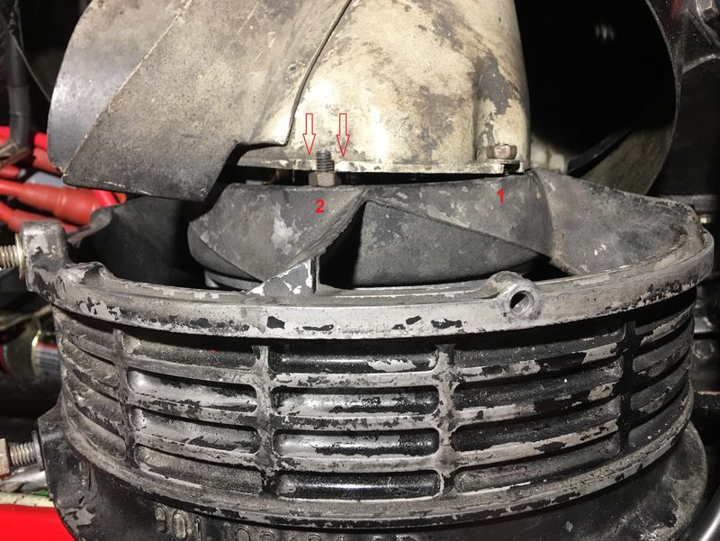

Porsche Crest
Hi guys,
I've a question, and just to clarify the way to mount air cone. It looks to me that #1 way is what was mounted before, but this way with plastic cone in between, I will not be able to put some torques on the 6 nuts around the alternator.
So, my thought is to do it as on #2 - to cut out the plastic around each nut as shown by 2 arrows so it fit around the nut, then put set of another nuts with larger washers to hold plastic cone in place.
Here on Pelican “Figure 2” shows air cone connected as #1 on my picture https://www.pelicanparts.com/techarticles/101_Projects_Porsche_911/20-Alternator_Replacement/20-Alternator_Replacement.htm
Please let me know your thoughts...

The nut (and a washer)should be on top of, not under, the plastic.
If I remember rightly, the long thin bolts screw into the aluminum housing, and don't rely on nuts to keep the alternator snug and in place. They are made longer so you can put a washer and nut on what sticks out to hold that air deflector piece on. So you don't need to tighten the nut a whole lot.
