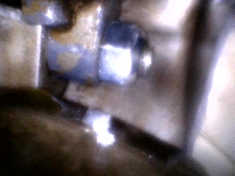

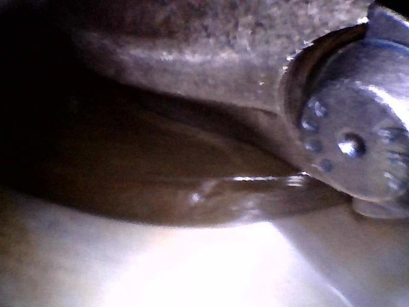

When I heard the rhythmic tapping sound at the right rear of the engine, I shut it down and started panicking over the possibility that I’d just found my lost woodruff key!
As you suggested, I dropped the sump and started exploring with my just-purchased bore-scope. Exploring the crankcase, what I can see of the timing chain, and running the scope into the accessible oil return tubes – I haven’t found my woodruff key, or any obvious damage.
I’ve attached some photos taken with the Endo-scope, but they’re not very good, mostly because I don’t know what I’m doing! I don’t know whether to take the valve covers off and continue exploring with the scope – or should I call it a day, regarding my lost woodruff key??!!

Hi Tony,
I'm still learning! I'm most familiar with the tests in the Bentley book, which are done with the engine running. The hand-held vacuum test that Pmax suggested is in the Porsche/Bosch Workshop Manual that I downloaded from Rennlist, just last week. I didn't know about it before that.
I'm going down to the shop to do that test now.
Any comments on my lousy photos or whether I should start the engine again?
