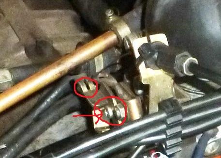

Another possibility is the cruise control going haywire. I have mine ziptied where it connects to the housing.

all above or.....if you do have a cruise control..a lot of time the problem is...right here with those 2 Phillips head screws -has to be two washers...one regular and on spring washer.If not the screw will hit the throttle housing and stay open...
Ivan

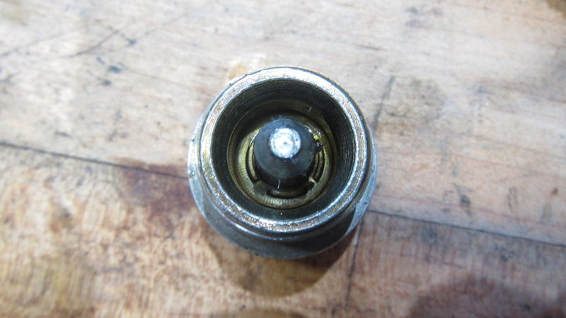

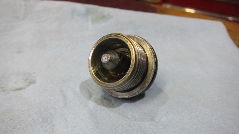

Oil drained. A few strands of metal filings, thickness of a human hair, less than 1/2 millimeter in length. No chunks came out of the crankcase and the oil is clean.
What's the crankcase capacity? I put about 13 liters in the engine, but didn't get much out of the crankcase, maybe 2 or 3 liters. Engine's cold, of course.

Sump plate screen........
Robert,
Your sump plate should have a screen. Please confirm. If the errant woodruff was lodged between moving parts inside your motor, you won’t be able to do the cam timing after all. The warm crankcase oil is usually be between 3-4 liters. Fill oil tank with oil and this is a trick I use to check cold oil. If you have oil on the tip of the dip stick (motor not running) you have sufficient oil. After you run the motor to operating temperature, check the oil level while the motor is idling on a level ground. The oil mark will be between the two markers. Good luck.
