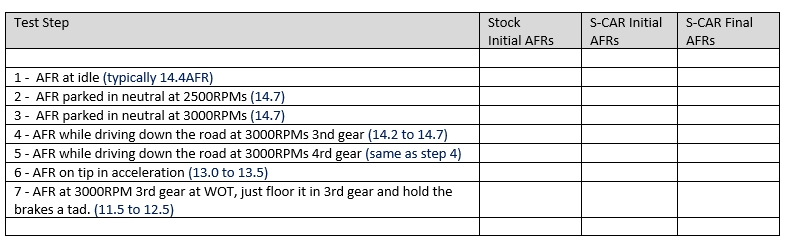

With the stock O2 sensor disconnected you should be at around 14.0AFR at warm idle. You should not be at 14.7AFR, that's to lean for idle in open-loop. Get the motor fully warm and set base mixture at idle to 14.0 +/-0.2 you will need to turn the CO screw in a bit (clockwise) possibly 2 full turns. At 14.7AFR these motors tend to lean mis-fire at idle.
The pictures of the plugs you pulled look like it's running to lean, they should not be that white, they should be toasty brown.
Then do a WOT pull as follows and watch the AFR, 4th gear 3000RPMs go for WOT and then ride the brakes slightly for a few seconds to hold the RPM near 3000, just do this for no more than 5 seconds and quickly make note of the AFR. A stock chip will be in the hi 11s to low 12s but an aftermarket should be in the hi 12s and never any leaner than 13.2AFR at WOT.
I sent you a data sheet with 7 testcases I have come up with from years of observing the 3.2L engines. Gather those 7 test cases and report back.
In Summary: you are still to lean from the above recent posts, turn that CO screw in a bit.

Wayne 962 06-05-2020 05:53 PM
Thanks Sal, I'm going to put the plugs back in and then record your test procedure.
I might not be able to get the rpms exactly correct with #4 and #5, and this is a 901-based gearbox installed in this car (not a 915 or G50), so the ratios may be a bit different.
-Wayne

cabmandone 06-05-2020 06:33 PM
-Wayne
http://forums.pelicanparts.com/uploa...1591404715.JPG
You are ultimately trying to do what you did on that uphill run you mentioned previously. You are looking for a WOT run under some load.

Wayne 962 06-07-2020 01:05 AM
Sal's questionaire:
http://forums.pelicanparts.com/uploa...1591517680.JPG
-Wayne

scarceller 06-08-2020 07:03 AM
Wayne, replace the spark plugs with W7DC non resistance plugs, it may help the idle issue. You already have resistance ignition wires you do not need resistance plugs.
scarceller 06-08-2020 07:07 AM
These results are really good, test case 2 & 3 you don't need to worry about much. The rest of the test cases are in range and good, if anything you can richen it just a tad more to hit idle AFR of 14.0 to 14.2, that may help the idle stability a bit. Just turn the CO screw in one full turn see what that does, then maybe turn it another turn for 2 full turns.
And as per prior post, replace those plugs with W7DC plugs!
