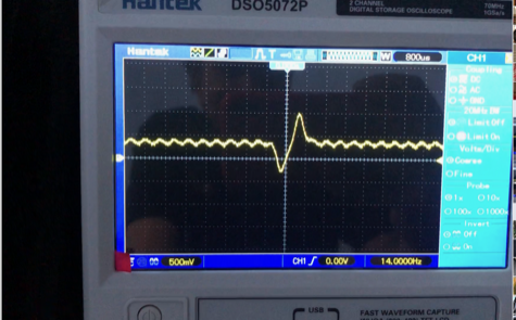

This shows the inductive sensor (got it with the Innovate tool) that you stick on the spark plug wires to check for consistent spark. Looks pretty good to me. You can also do this check with a simple timing light.
I tested the air flow meter with the oscilliscope. Basically set it up for a slow trace and then pushed the flapper open and closed. No issues seen here:
This was the signal from the rpm / speed sensor. I wasn't too sure about this one, I will take a closer look at what I think it's supposed to look like tomorrow. This and the top-dead-sensor readouts looked okay to me, but I want to double-check them:
This is the TDC output:

All your signals look Ok by the way. I haven't tested my inductive probe yet. How/where do you use it exactly ?

I kinda 'made my own' breakout box from a Volvo 940 ABS unit (same connectors). I included some leds to show the switched and see if the idle switch and WOT switch do connect to ground (pull the pin low).
First scope img : speed sensor, amplitude should be >2V
Second scope img : 2 channels of the ICV valve pulsing
1985 Carrera 3.2

- Jumper pins B&C on the test port and test / check mixture and misfire.
START / WARM-UP:
- Check the cylinder head temperature switch (use the breakout box to map this on the oscilloscope). I'm going to hook up my laptop to the scope to record the data in real time to review it later on (this scope is pretty awesome for $200 - Chinese made, but it has a *ton* of features).
- Check the proper operation of the O2 sensor (both the heater, and map the voltage valves against the readings on the LM-1 meter). I'll probably need to take a video of this, as I don't have the LM-1 setup to dump data to the computer right now (that would take a bunch of time to do).
- Unplug the O2 sensor to see if forcing the car into open-loop mode will improve things
POST RUNNING:
- Check temp control switch / Thermo valve (this is plugged off - may be leaking when warm?). What I'll do is take the car and perform my measurements until it's hot, and then I'll bring it back into the garage and put the smoke machine on it and see if we have any leaks at temperature.
- Analyze results and post back on the forums!
