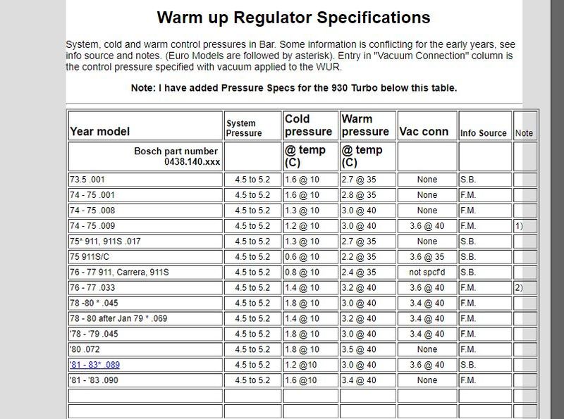

So what would the highest pressure be? Bob has pressure at the fuel pump at 100PSI, anything operate higher? Looking to have fuel lines made and want to make sure the lines can handle the CIS pressure.

I went back through my docs and found this, which show max pressure for.....what i have noted as the 979 pump. As you can see...at what appears to be no flow, the pressure is 11 bar. (154psi).

Thank you for the info Al. This is very helpful. Is this the 979 pump you are referring to? So when operating it operates at 5bar but increases to 11 at idle?

No, I believe that the way to interpret that is it will be at highest pressure, when the flow is completely blocked..........
