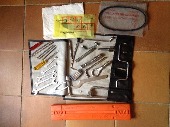

David, tool kit for 1985 looks like this
i do have the axtra crank and tips in it....

or my other tool kit with extras;-)

David.to work on your 911 get different tools..the tool kit you can get together with time .Buy piece by piece....i took me 3 years for this one then i sold it for 650 euros.....

Ivan your kit shows a couple of things the PET does not show for the 78SC and that my kit does not have. I would think the one for the battery with the rubber gripper came later no ?
Im also not sure what that short bar is between the lug nut wrench and pulley wrench in your pic .

that thing on my tool kit post #5 is a tube which is actually for the battery bracket allen wrench to turn..you can see it in Gerrys tool kit next to the alt belt on the right side..
btw your open wrenches are not correct from what i see..as you have mentioned..i do have some extra open wrenches,pliers and e.t.c. ..i make some pics after the weekend..i might even have the original alt belt goodyear.....
