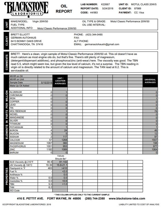

I find this oil report from Blackstone laboratories. If anyone want it to compare.

I hope everyone understands that ZDDP levels are the main point of oil controversy and that the Zinc and Phosphorus levels in both the Motul and VR1 tests shown here are marginal
conventional standard for ZDDP from back in the day are for Z & P ~1100 to 1300ppm
That's for API oil circa 1993 and earlier, SG & previous
