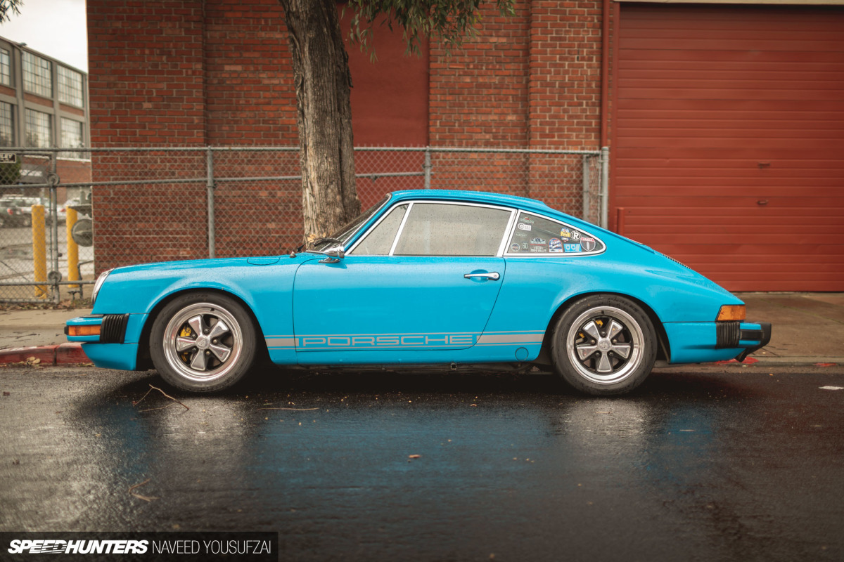

Looks like the same car. Is he a member here?

Join Date: Aug 2015
Posts: 2,752
300 Members, 300 Porsches: The Family Behind RGruppe - Speedhunters
Wheels are different. Mirrors are the same though.

Posts: 53,989
Lower profile summer tires below 50 degrees are rubbish.
Even kids know to put a hockey puck in the freezer so they can play hockey in the streets in the summer.
The mediocrity of All-Season tires keeps me safe year round, because they force you to drive slower.
EDIT:
Yep, same car different wheels.
