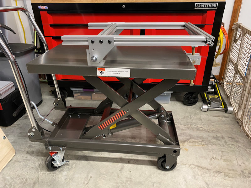

Yet another engine lift table, but with tilt.
After reading quite a few threads about the merits of using a lift table or a transmission jack for engine removal, I decided that a lift table might work best for my 4-post lift setup. I did however like the fact that some of the trans jacks allowed for tilt.
After stealing a few ideas from this thread, and then dug around in my scrap parts stash and found enough aluminum extrusion and brackets to graft something onto the table.
https://forums.pelicanparts.com/porsche-911-technical-forum/681825-transmission-jack-engine-removal.html

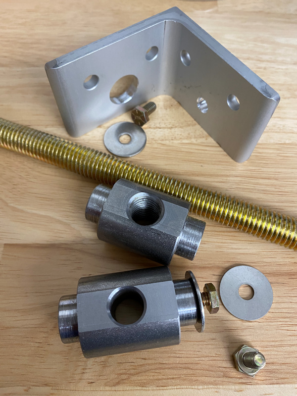

A piece of 5/8 UNC threaded rod, and some trunnions I knocked up on the lathe...
Built a small frame from 1.5" aluminum extrusion, and scabbed some brackets for a pivot...

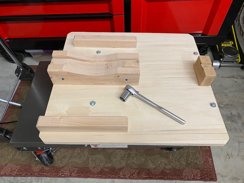

Here's a closeup of the tilt adjuster...
Hated using this nice piece of plywood, but it's scrap from a cabinet job...
Just need to add some blocks to support the heat exchangers and trans now.

Thanks. This is something I could put together relatively easily and I really like the tilt feature. 80/20 is wonderful stuff.

Looks great. One thing that would make it work a tiny bit better is a knob handle from MSC Direct or Grainger for the all thread. In the heat of the moment, a knob is more convenient than grabbing a wrench or socket and ratchet.

Some questions:
  • Which way does the drivetrain sit on the table? Rear of engine closer to lift table handle?
  • Will you use this for both engine only and engine with transmission removal?
  • Have you taken into account the location of the center of gravity? There's a lot of weight concentrated at one end of your mechanism - is all the hardware up to the task. Is it strong enough laterally to avoid buckling?
  • Guiding the transmission shift rod into the chassis opening requires quite a bit of tilt. How much vertical travel do you have? It takes a lot.
I'm loathe to display my crude handiwork next to yours, but it illustrates some considerations:
  • The center of gravity of the engine with transmission is between the sump plate and flywheel, so nearly the entire weight of the drive train is on one set of supports. I used a pair of jackstands to be sure the supports are strong enough and stable enough, especially laterally.
  • I use the lift extensions on my MaxJax to get the tail up for more clearance, but this means the drivetrain is slightly nose down when aligned with the rear mounts. I run out of travel with the small bottle jack that supports the rear of the engine and have to reposition it for the final alignment.
  • The lift table handle is behind the rear bumper when installing the engine. This makes it more accessible when maneuvering and jacking.
  • I use ratchet straps to secure the drivetrain to the platform and to limit travel.
  • The engine is tall at the fan (and CIS), the bumper hangs down a long way, the lift table has limited travel and the MaxJax has limited travel. All this conspires to make it difficult to clear the rear bumper with the fan and still get the mounts up to the chassis. I ended up adding another set of safety bar holes to the MaxJax columns so I could lower the chassis slightly at the end when mating up the mounting points.
Again, nice work on the lift. Be sure it is strong enough and stable enough to deal with all the loads it will endure.

Great post with lots of things to think about...
* My handle is the same orientation as your setup, however, I've modded it to lay down so as not to foul the bumper or the rear crossbar of my 4-post.
* I've tried to place the pivot point such that there is always a downward load on the jack screw, even when I separate the transmission once it's out.
* As far as how much tilt, it goes quite a ways. How many degrees do you estimate it takes with your setup?

I use a small bottle jack with 6" of travel to elevate the back end of the platform. That is not enough tilt, so I relocate it mid-process to bear on a 4" block (see photo of underside). Consequently, I get about 10" of travel acting over a 16-21" base (moving to the block shortens the distance from the jack to the pivoting crossbar supported by jackstands).
Supports
One thing I especially like about your design is that all the support points (frame pivots and elevating screw) control motion both up and down. Mine provides upward support only, so I have to be very careful about tilting, especially laterally because there's nothing to hold the other side down. (The Pyramids have held together just fine relying only on gravity, but then they're not being tilted and jostled to align with an easily cross-threaded transmission mount. ) Your design will resist twisting, but then you're relying on the strength of the 80/20 joints.
Originally I intended to use a jackscrew similar to yours, but I can't machine parts like the trunions you made (very nice). I use ratchet straps to limit movement, but I'm going to steal some of you design elements for more positive control.
Stability
We're both using three points of support, so the key is keeping the center of gravity (CG) inside the triangle. The CG is where the 500# of drivetrain acts on the platform. I went with a wide base near the CG to control lateral movement; your design puts the CG closer to the lift screw. My concern/question is how close does that bring the CG to the edges of the support triangle? Where the drivetrain sits relative to the supports is key. I visualize this as standing on/near the seat of a tricycle versus standing on/near the handlebars; the chance of tipping sideways is less near the wheels.
This diagram is not to scale, but illustrates my point:
IMO the ideal would be a broad, nearly equilateral triangle with the CG safely centered, as in the middle diagram.

I'm getting about 15 degrees from horizontal, do you think that will be enough? If not, I can tweak things a bit to get a little more.
Had a few minutes to finish up the top today...
