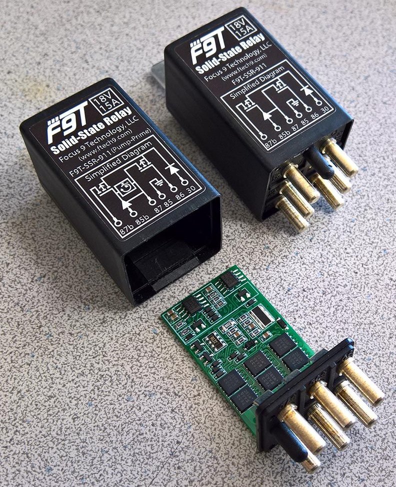

So I've read through several threads about this and most don't seem to apply to my situation. The quick rundown: 1988 backdated 3.2. The car is new to me and I'm a new Porsche owner. Car ran great when I purchased it, drove it home 350 miles with no issues. I changed the oil cooler flexible lines, did a valve adjustment, changed the oil, filter, spark plugs and fuel filter, air filter, DME replacement (focus9 upgrade). The car has SSI exhaust and I found the O2 sensor unplugged when I was poking around so I plugged it back in. Shortly after doing the above maintenance the car seems to bog down or not have full power at times. The idle seems rougher to me too. While driving along at a constant speed the car will suddenly increase increase speed and run much better. To me it feels like a fuel supply or spark problem but, again, I'm a new owner.

350 mile trip and no issues. You service and issues develop. You mention you replaced the DME, I'm assuming you mean the DME relay to focus9 solid state relay and not the DME itself? Anything that you changed (short of plugs and oil obviously) I'd back out and go back to what was in the car when it was running fine. As Ivan said, unplug the o2 sensor. If the DME was chipped it might not need the o2 sensor. Also check electrical connections. You might have bumped something loose while changing plugs. I bumped my cylinder head temp sensor connection loose while doing some work in the engine bay once. Not saying that's the issue but worth looking to make sure anything you might have bumped while changing plugs is still tight.

Solid state DME Relay conversion ?
Solid-State DME Relay 84-89 911
https://rennlist.com/forums/911-forum/947925-solid-state-dme-relay-84-89-911-a.html
Just tossing this out there, mismatched rotor as in using a resistor type when you need an non-resistor type because of aftermarket upgrade (MSD) is a common mistake.
Also not replacing the distributor cap and be a mistake, hairline cracks can form out of nowhere.
I don't know squat about this relay, but going back to what was in the car before sounds like a solid approach.

Thanks all for the replies. Yes, I meant the DME relay...my original one died so I "upgraded" to the FT9 solid state one. I'm going to hope that is not the problem because I don't have another to swap in there. Good thought on the dizzy cap, I will get one of those and swap that our as well as the plug wires. Before doing those I'll unplug the O2 sensor. Also, I unhooked the battery last night as I read somewhere that might reset/recalibrate the computer. I'll report back once I go through these fixes. Ivan, what do you mean by the C/O level...carbon monoxide out the exhaust? Thx.

DME relay isn't the problem. Unplug your o2 sensor.
