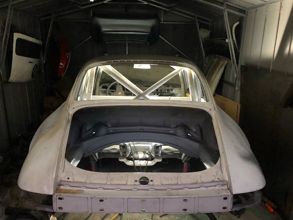

Glad to see builds like this still happening. Backyard shed. Home made jigs.
I am sure you had loads of fun climbing around the cage to cut rear seat pans out.
Next you will be slotting the heel panel to fully circumference weld that torsion tube. Fun part is laying upside down for the underside.
Don't forget to tie the tunnel and torsion tube for bonus points.

It’s almost like you have done this before!
I don’t have high confidence in my welding……. so I went a bit overboard on the reinforcement. Fitting with the rest of the car at this point I guess.

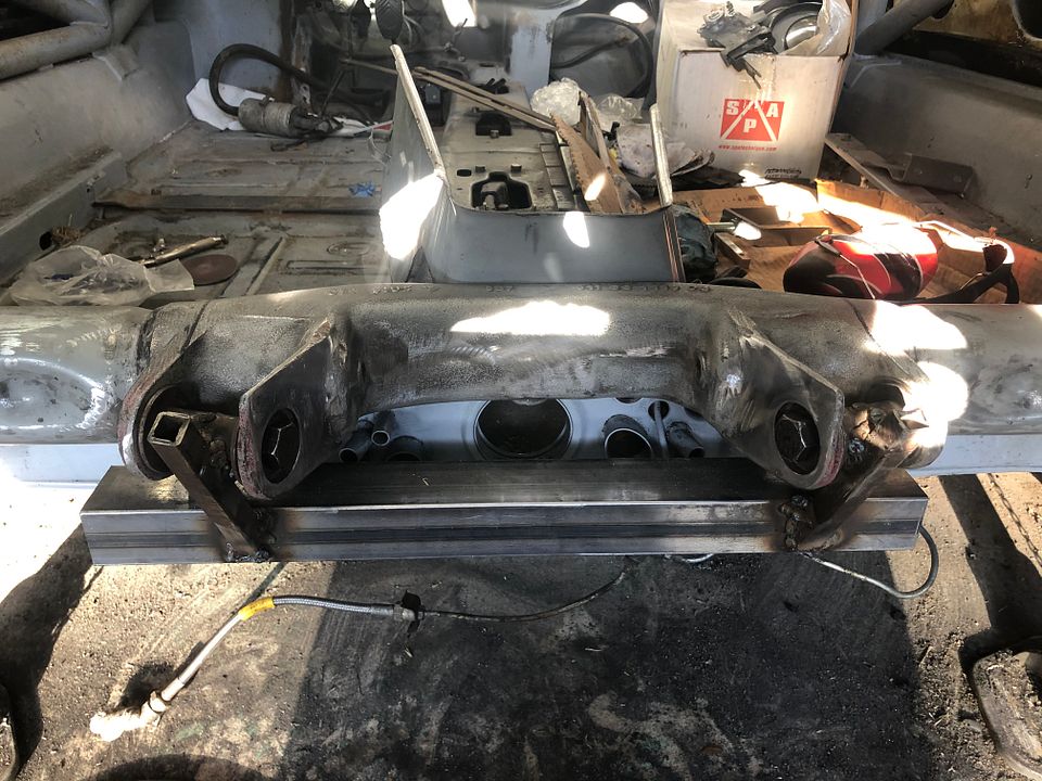

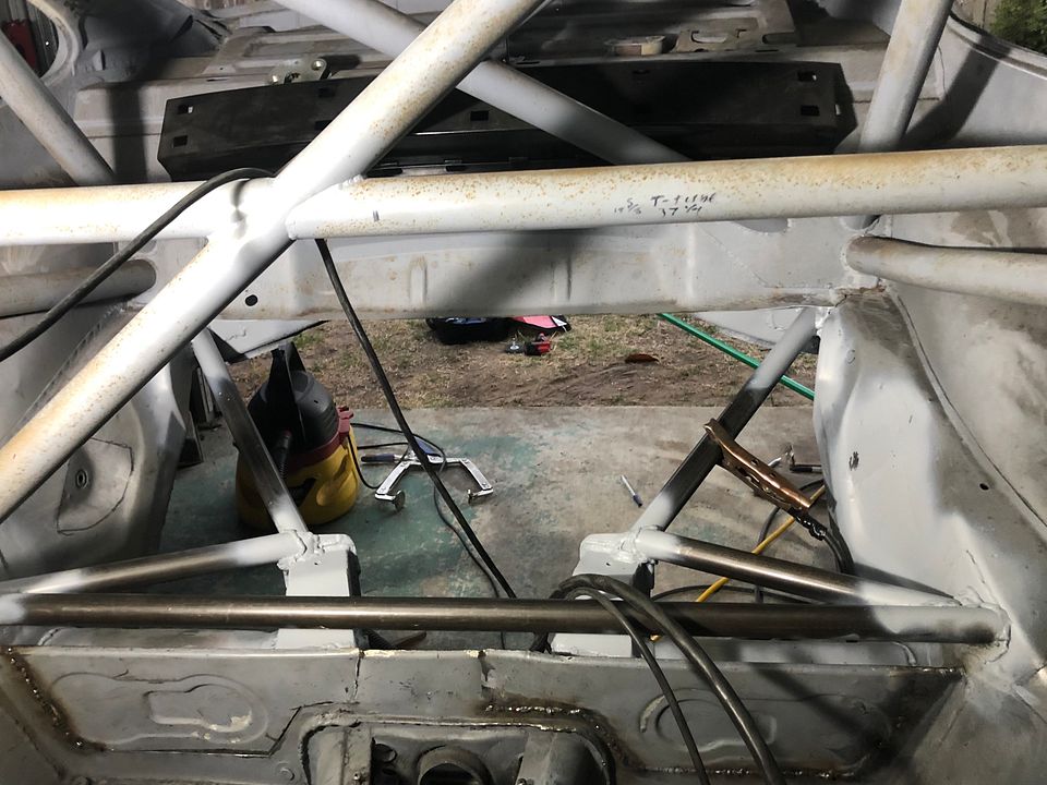

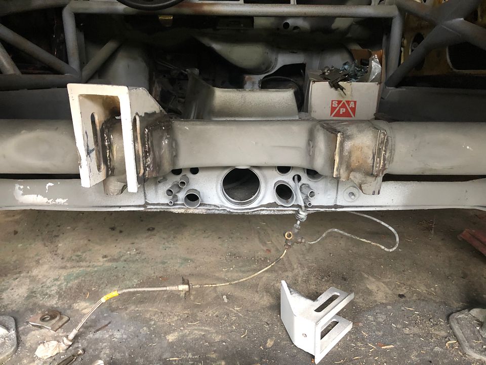

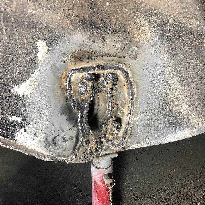

After welding in the G50 torque tube with plug welds to my inner sleeves and a butt weld to the stub of the old tube in the car it was time to mock up the wheel again and see if things still fit.
D1B69711-9A1B-449C-A3A6-9DAD88F0ABA7
9BC0F4FE-01AD-428F-B8D2-154264D5B6A7
With the wheel fitting about how it did before and feeling confident, I figured that meant I needed another chance to screw it up!
Step 10, enter fixture number 2!
36BE0982-DCFF-42CA-B2F3-368A4B669F2A
Step 11, mocking up my rough cuts. I kinda guesstimated on the angles but I laid the slider back slightly so that as the pivot point moves up, it moves back a little to maintain the same wheel base.
3562A987-F997-4142-911D-FC4BE2DDDF88
and cutting off some perfectly good mounting points. No going back now!
816B4ECB-6500-4D5D-ADB1-E53632E1AADB
One down!
BC3265EB-B52A-4B5D-A133-09CBDAB2FC73
And the other side!
9A17BE8C-CBFD-4791-B25E-0342625FF4CF

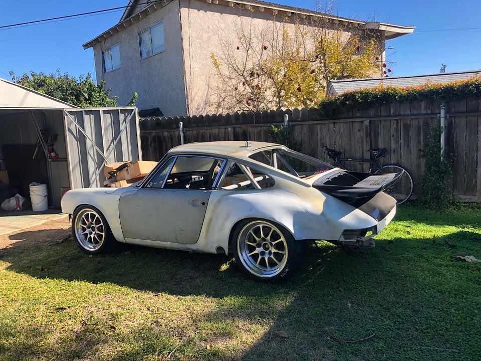

Not quite up to real time Chris but I am getting there.

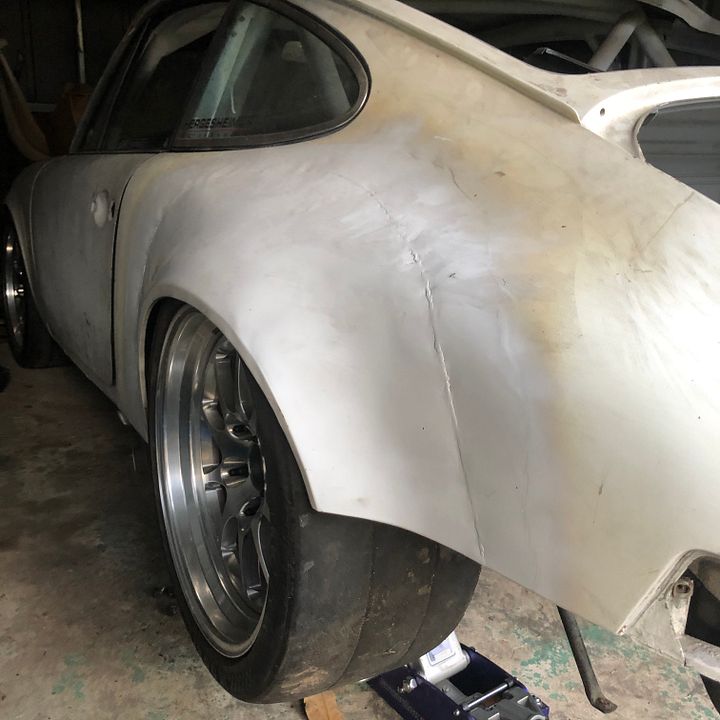

I am pretty jealous of you guys with garages. Building this thing in a shed with no lights and needing to run a 50ft extension cord every time I need a power tool that isn't cordless relegates me to being a daylight hours weekend warrior...... well that and an at time demanding work schedule.
This unscheduled optional build step to have exploratory surgery to remove a metal splinter that needed 20 stitches also slowed me down for a few weeks. Note to all those watching, sweep up the wire wheel bits off the ground before rolling around under the car again. After all these years one of those finally disappeared in deep enough I couldn't get it out.

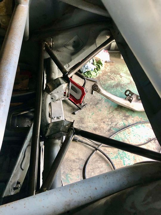

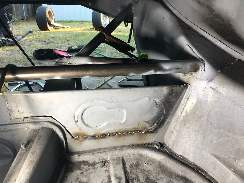

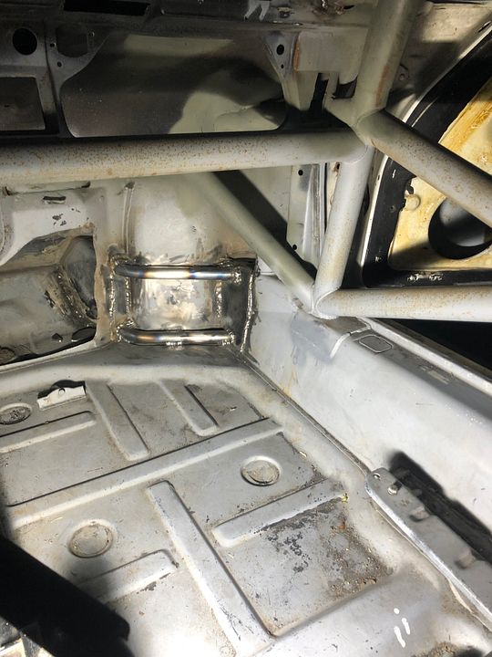

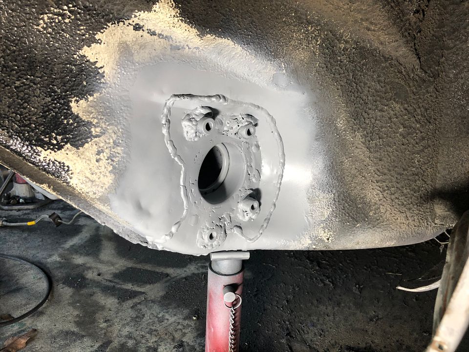

Back at project overkill, I needed a radius for the back seat sheet metal to make the turn from the vertical to sloped up to the firewall, why not use some 1 1/4" .065 tube. I also added a partial torque tube sleeve to the outside...... because I had some tubing the right size. It will make a nice jack stand pad.
12819CE1-A8AE-42A0-973B-50C57AFE47E9
.....and I added some landing pads to the camber boxes/roll center correction for tubes to drop down from the shock towers.
50FFAC54-3CDC-4FDB-B3DB-B8CA6B169849
.....and of course the tubes I wanted to add fouled the heater ducts so those had to go.
A82142B0-4AE7-4155-AB32-E38114CEB774
So this bar could go in.
CFE1F5D4-A6E6-4669-B213-A84FC5135CA5
Lots of fun coping tubes with an angle grinder.
71CEF2F5-DA41-48BD-8F2F-7F03ED32C165

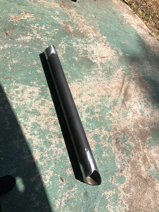

And....... for the complete overkill factor maximum triangle creation achieved. The welding could be better but I'm pretty confident nothing is going to fall off now. I'm still blaming PTSD of my 914 and e36 BMW both of which I cracked all the rear suspension mounting points on.
1486362F-5026-4D5B-8180-073182488D11

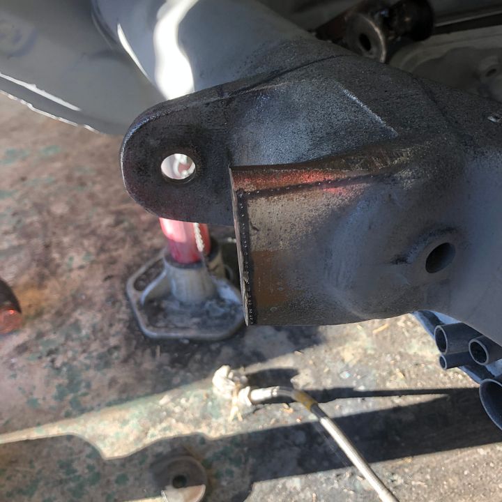

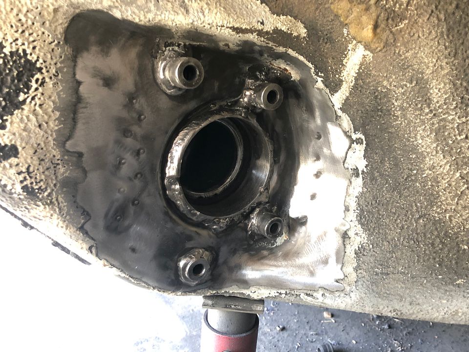

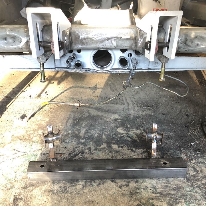

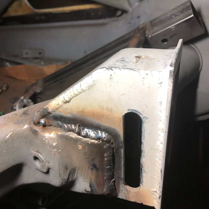

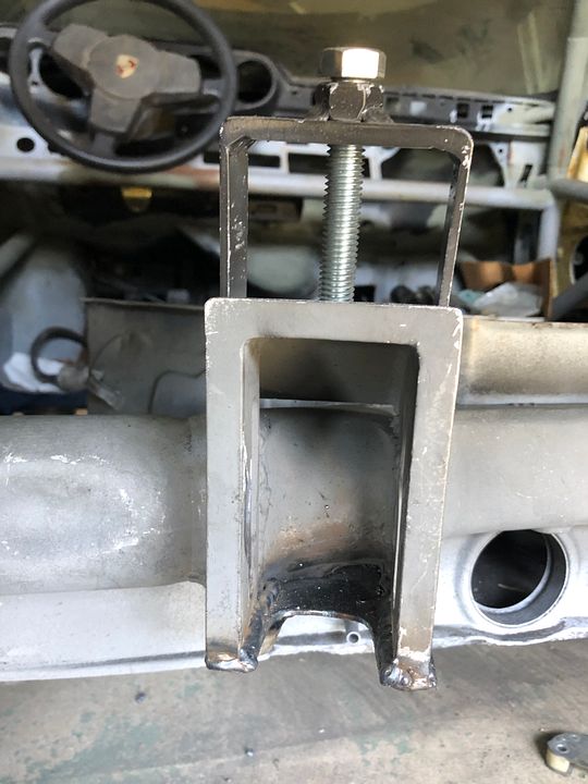

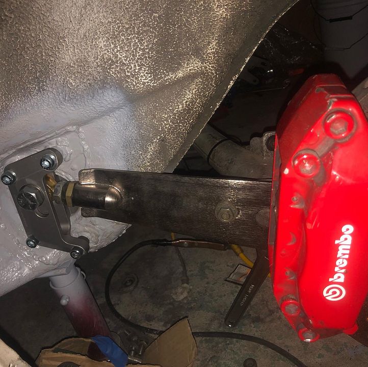

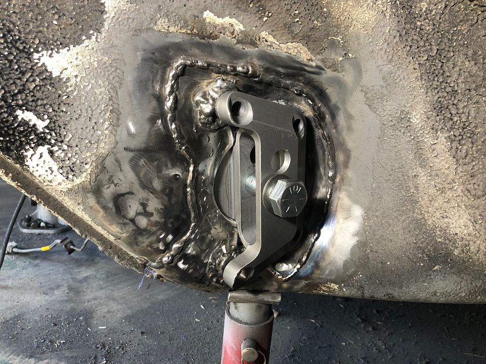

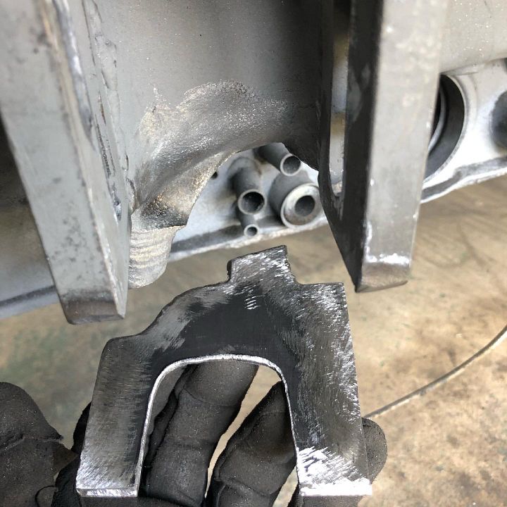

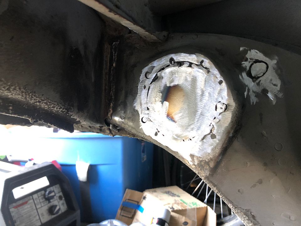

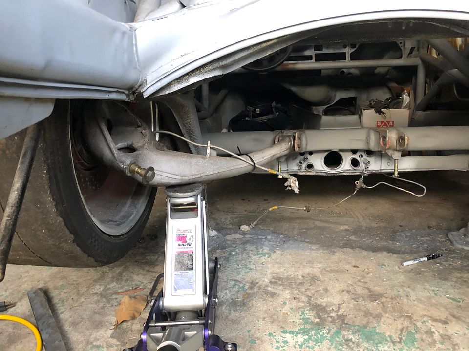

With the trailing arm mounts sorta done, it was time to turn my attention to fitting the ERP 935 spring plates to match.
I should know by now that "bolt on" parts on cars does not imply that they fit, only the attachment method....... and so I now have 30 more hours of grinding, cutting, welding, and stripping under my belt.
Yea for no hidden chassis cracks I guess.
A2BB8BEB-6718-4EAD-A165-0DBE7FFFA537
but the round part of the torque tube sticks out too far for the bracket to sit flat on the threaded studs. So several hours of grinding got me here to where it would fit.
7DC7A5F7-7DD0-400A-AE17-56D16BBB50CE
But the weld to the central tube had been ground through so I need to grind that back more and weld the end of the tube back to the car.... and the "while you are in there's" set in.
8438D5F0-40FD-48C2-B530-9716537D78D9
It got ugly........ things got warped, lessons were learned, not the least of which is I need to start wearing a real breather when welding on weld thru primer.
AB53A4D2-A5C0-442F-85B8-6A2073CEF057
But lots more grinding and a little paint later..... it's not looking soooo bad and things fit!
729740B7-DE59-483A-9AC5-B8E0FF43F5E5
A little undercoating back on there will hide the ugly. Now just repeat on the other side!
EE72FE7D-AD13-40F8-9143-58EA06C4548F

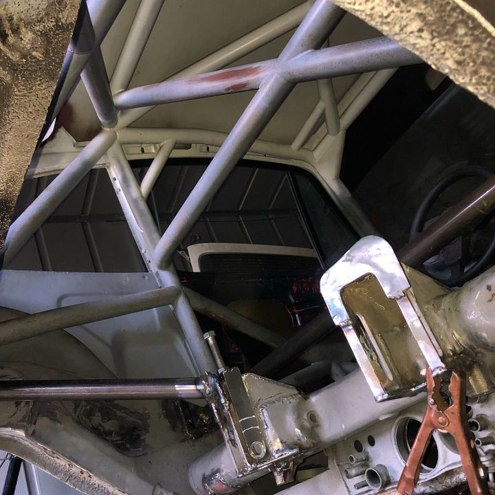

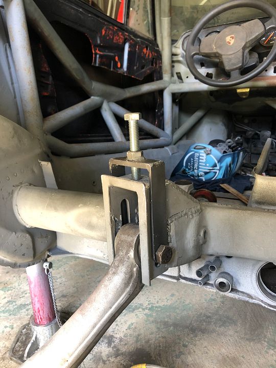

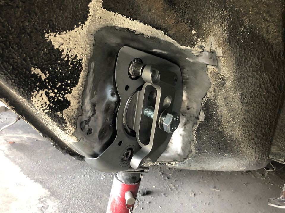

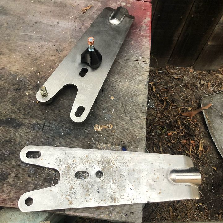

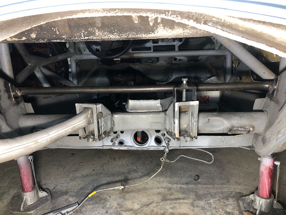

I must have 4 solid weekends getting these ERP spring plates fitted. Once finally getting everything to bolt on, I had to dent the chassis quite to bit to get clearance for the toe adjuster nuts to spin freely...... what a pain. I sure hope the raised roll centers help noticeably with squat and roll oversteer because they have added a TON of work.
649770F4-F166-4DE5-9292-9E8B3652BAB7
Now that they fit, off they came again for drilling the old toe adjuster hole for the JWE swaybar.
5E576AFF-301A-4ECE-B678-0FF4E40AF425

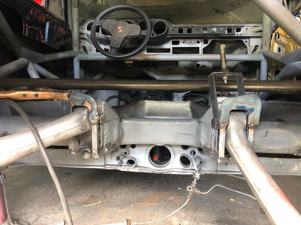

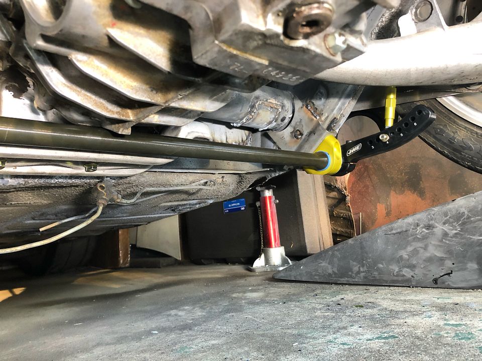

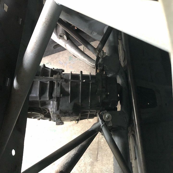

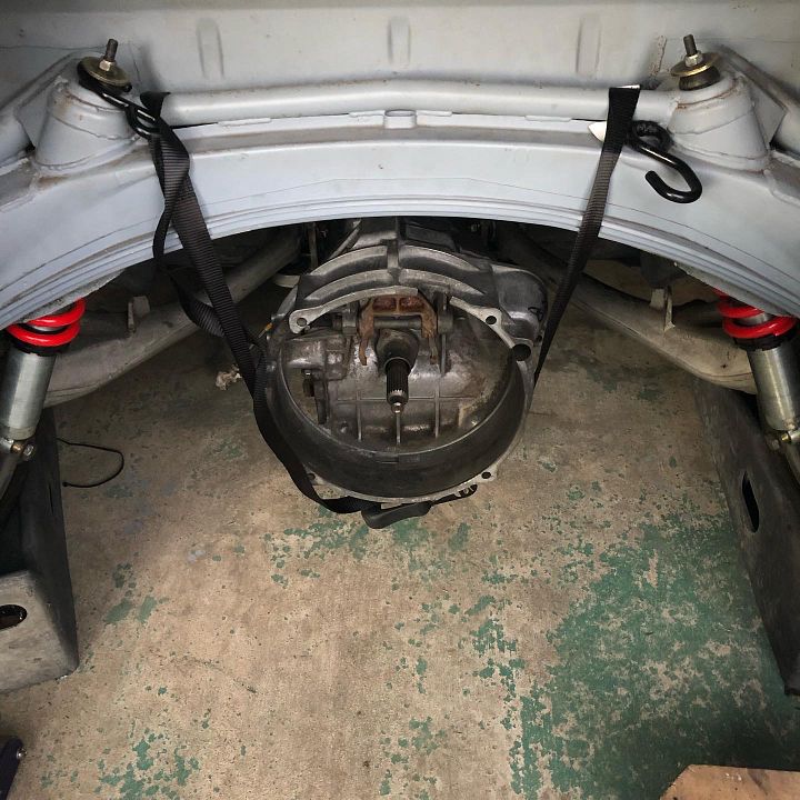

In order to fit the new swaybar mounts, I mocked up the gearbox and after all this work, I am happy the G50/01 also fits! Knowing what I know now, I don't know as I would do a torque tube swap again. There is a reason SBH G50s are a thing but I wanted to be able to use all GT3 clutch and flywheel parts and I think I have achieved that other then come to find out modifications to the bell housing will be required to fit the late model starter..... more on that to come.
334842B5-BC97-4B08-A34B-E8FAB8EF6AD6
4D518625-570C-4797-9599-8A0AB49B4025

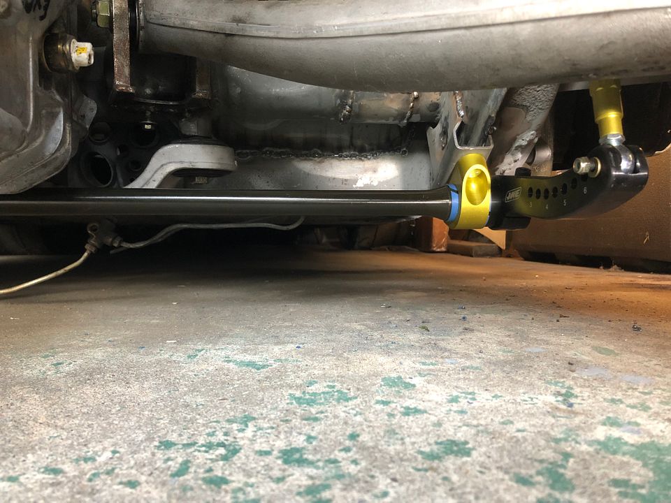

Using the JWE high clearance swaybar mounts I tucked everything up as high as I could with the 20mm bar. If I end up going bigger later, I can shim up the gearbox or down the swaybar. Clearance is tight but it is tucked up behind the trans crossmember.
6FBFFD35-AF0A-4FBA-BBD4-7FEBF2DA9284
6600CA6C-F9F6-4D79-BED5-547A075476A6
With that job done...... the trans will go off to Tyson of ProMotorsports for a checkover and LSD instal. I don't think I want that aggressive of a lockup as I would like the car to still work at Autocross. We will have to see what option Matt at Guard has, maybe some 993 ramp angles?

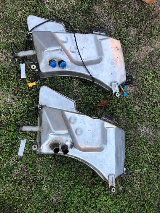

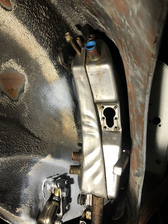

And now onto my next daft plan because I seem to like to make everything difficult. My headers like to occupy the same space as the factory S oil line and I need to do what I can to offset the beastly weight of the G50 so enter the 993 oil tank.... or rather 2 of them. One for me to play with and one that is out with a local fabricator to braze on AN-16 bungs on as many outlets as he can. A bit of an experiment to see how that goes.
E109F06D-8489-4927-A642-23B4A859ADD4
The 993 tank fits in an early car well...... the pipe routing just becomes an issue. I think I have a good plan that involves a 993 tank with a 964 oil filter console, a 911 thermostat, custom hardline on the passenger floor, and modifying the oil tank to fill though the passenger door jam... but we will see. LOT more fabrication to come I am sure.
ED5035E6-7713-4511-A3F1-90B0E4CE015A

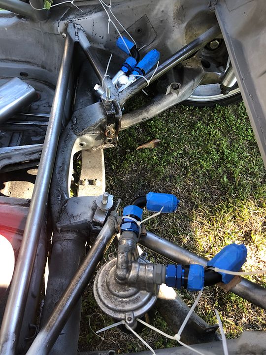

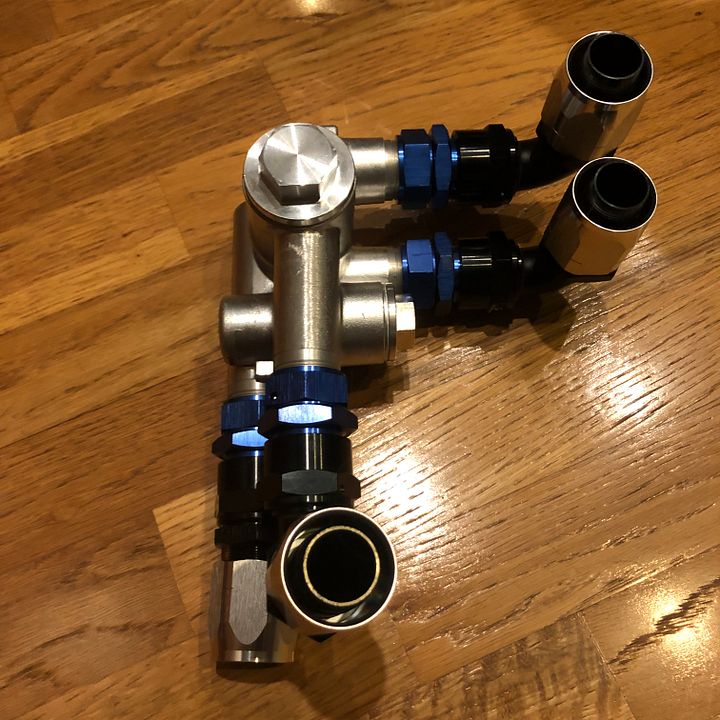

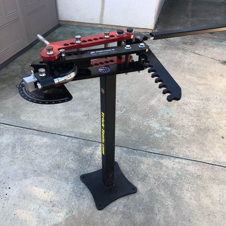

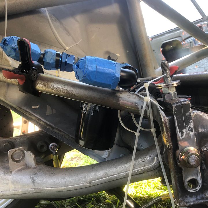

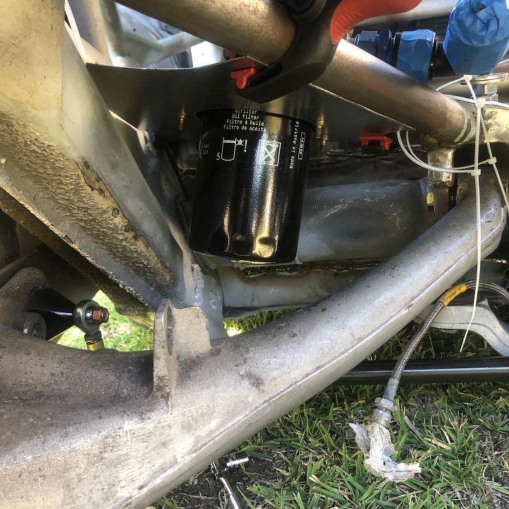

Bought a tubing bender for hard the oil line fabrication and reinforcing the front inner fender area similar to 964/993 and 911 Targa reinforcements
0E150577-6D5C-4212-AC19-E9CAD8DDDDF4
Still thinking I will weld some sheet metal between the reinforcement with some dimple die holes
7958DF04-47DC-41ED-9C1C-154F746D6640
Started mocking up the oil system for AN16.... I think the oil filter will stay here but the thermostat I think will end up in the smugglers box. Not a lot of room once all the giant AN16 lines are in there. I went with a 911 thermostat and a 964 oil filter console as there isn't much aftermarket setup for AN16 fittings and I like the pressure release circuit in the stock thermostat.
1A2AFEBD-4F0E-48E3-A3A4-B1E062327FC3
AF2A42AB-1AE7-4BE4-BBE2-DBAD0B623863

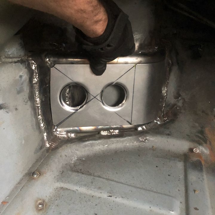

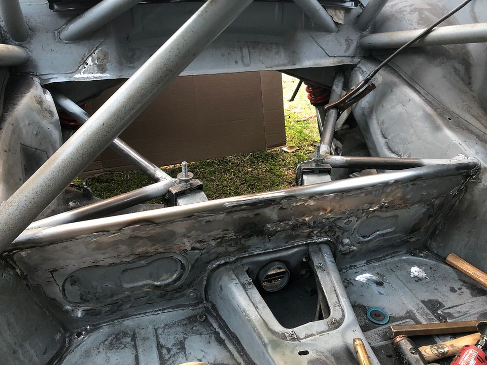

Working on this thing, I sure am tempted to buy a lot of tools. One day I will have a lathe, mill, and bandsaw at home but until then, it's hand tools.
Got one of the closing plates for my fender well reinforcements made. Dimple dies make everything look better!

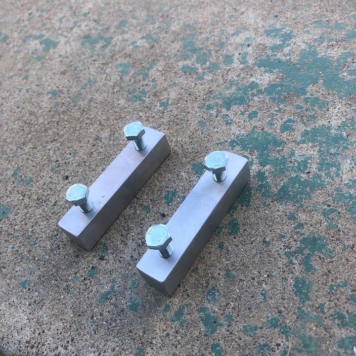

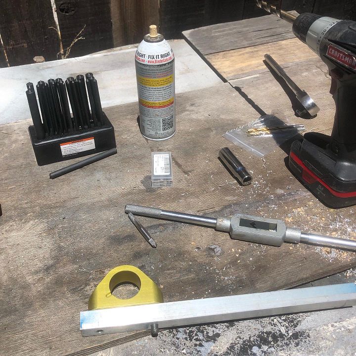

Rear swaybar "nuts" for the JWE high clearance mounts
A95032BF-049A-4935-92DF-0A6E51477B16
E08D8839-7C07-414A-8951-C878B2BD8F11
Got those knocked out so I could mount up the rear swaybar again to check for clearance with the proposed oil filter location/bracket. Anyone have a good reason why this is a bad place to put the oil filter? It clears all the suspension in full bump and droop, comes off fairly easily, should be reasonably well protected there, it's low, and running a 993 oil tank, space is somewhat limited without mounting it like a 964 which seems like running oil 3 sides of a square for no good reason.
0BA5C225-3BA6-4CC2-A7D1-97986CA3E813
96B4C959-BD62-4016-94F4-A5E4854B65F5

Evan,
That's where my fuel filter is.
The only caveat I have to share is that it gets dirtier there than you'd expect.
You have to clean up the area before you pull the filter. Otherwise, you encourage detritus to fall into the fresh filter as you install it.

That’s, good feedback Chris. Hadn’t considered that aspect of it.
Really tempted to buy that GT3 Cup Motor on BAT today…….. that would solve my where to mount the oil filter and thermostat dilemma real quick. Haha.
