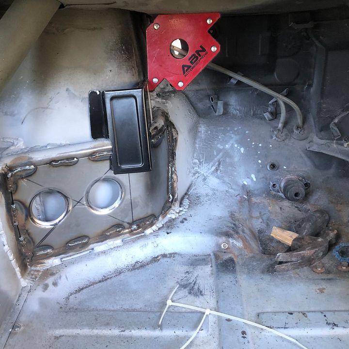

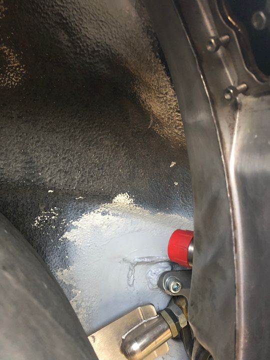

I have made some more progress with the car also. Got the inner fender wells finished up.
ACEABEBF-ADA4-4FBB-8DAC-6A1F69264E73

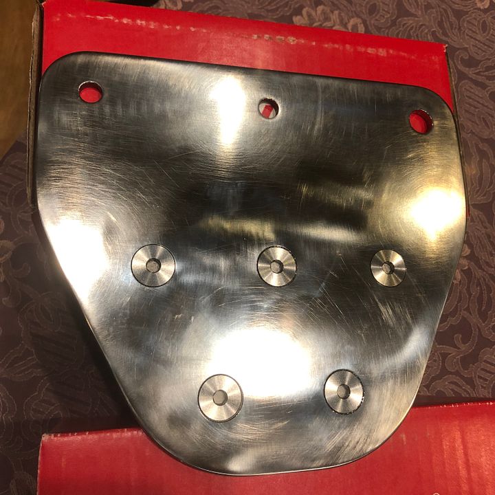

Added an RSR dead pedal
8389EC96-6502-4F59-BE4D-4DE674553BDB

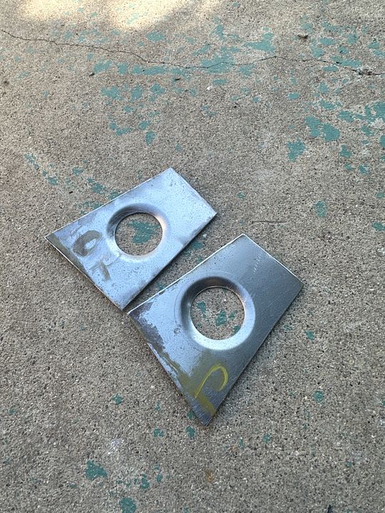

Decided it needed to meet the dimple dies.
03804238-8BD0-4D17-9343-F3C976A256D9
And the inner footwell strengthening is done. A bit more work required down here though to fit the hybrid 993/911 pedal cluster I am working on and fit the battery in the smugglers box.
F9881DEE-2904-4FF5-9F01-974CC5834683

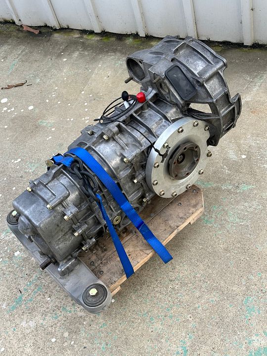

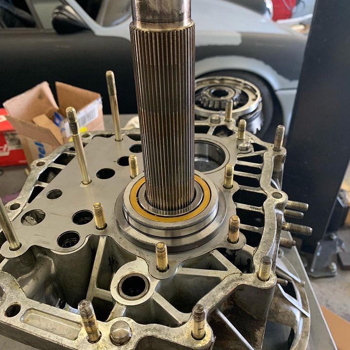

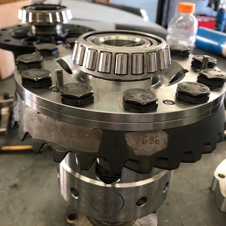

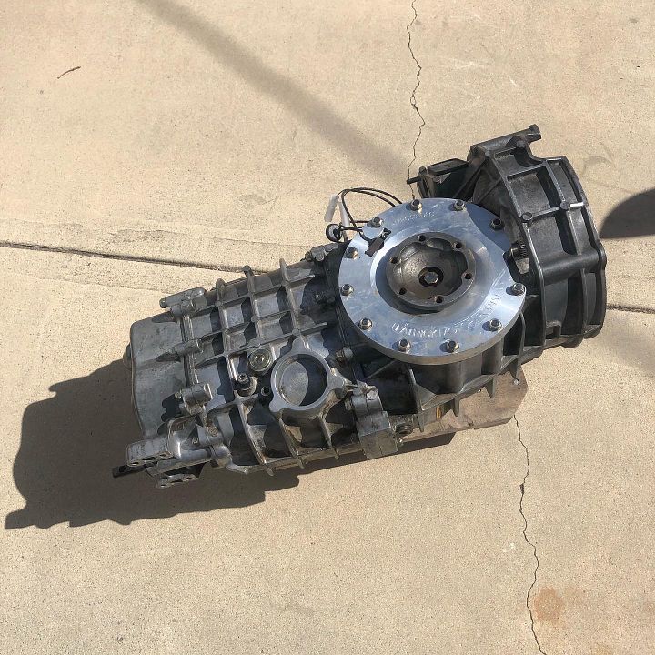

and after 10 months waiting on diff parts, the trans is back from Tyson!
0973BBA5-D838-4088-B0C7-A6FBD7DF23A6
Guard diff went in, along with a billet shift fork, the billet side cover, steel/carbon synchro on 1-2 and new brass the rest of the way through. On advice from Tyson I am going to add a lube pump and GT3 filter for the gear oil to preserve the gears and bearings from the diff plate material.
E19CE6AE-8C30-44D3-8593-982417158879
476429DF-BDAD-42B4-90DD-C6948BB952CB
Hopefully this g50 proves durable because it certainly isn't the light weight or budget option.
5B19F721-7598-434C-963B-600CFBDF28E4

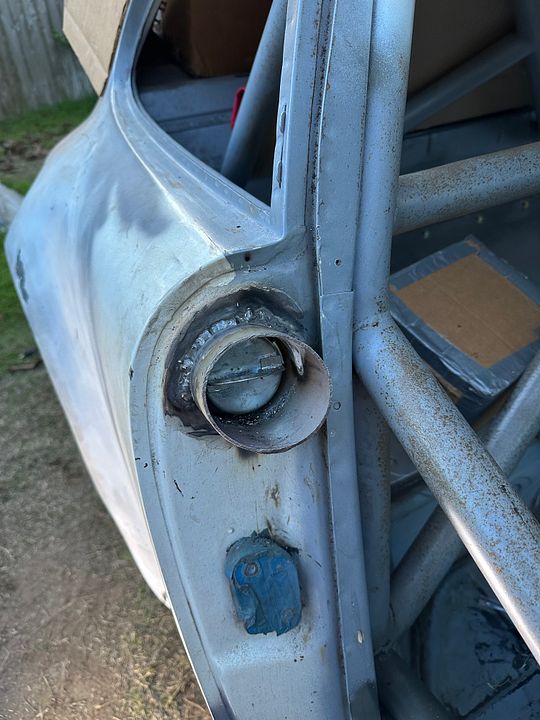

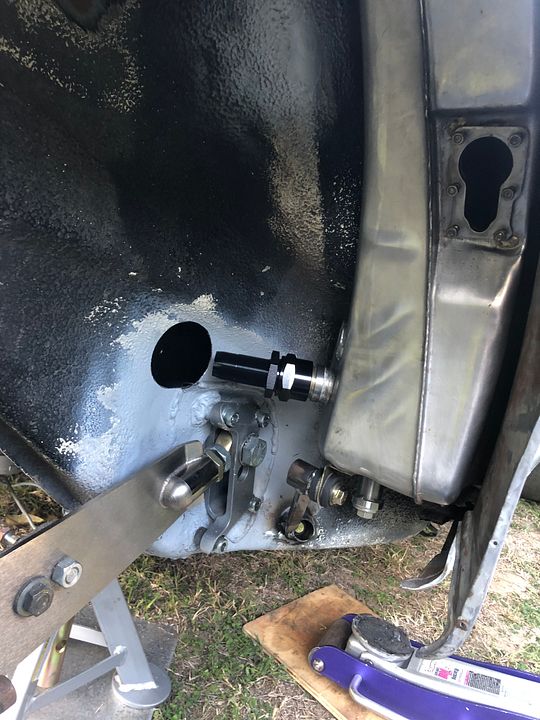

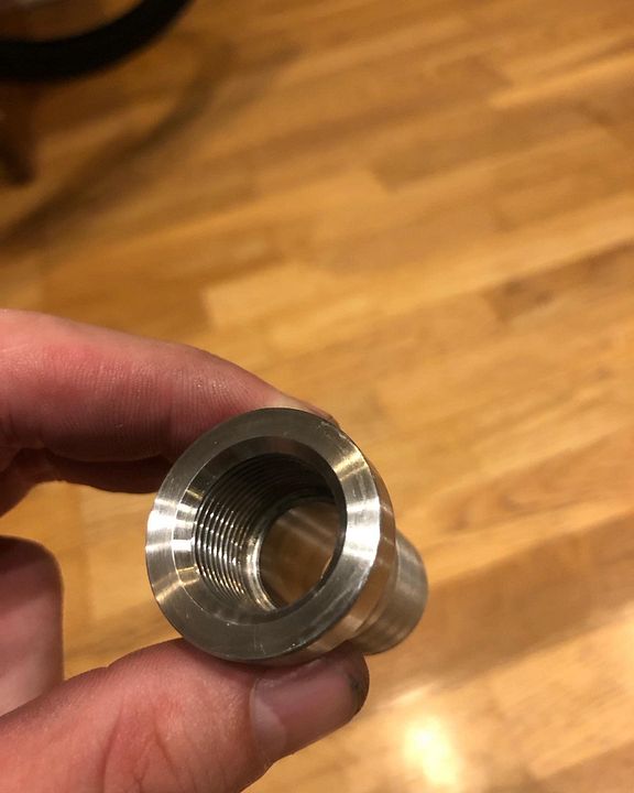

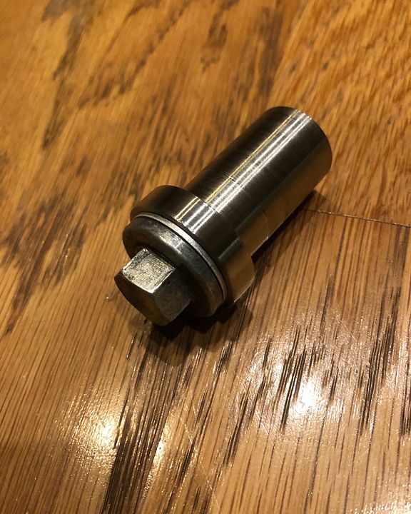

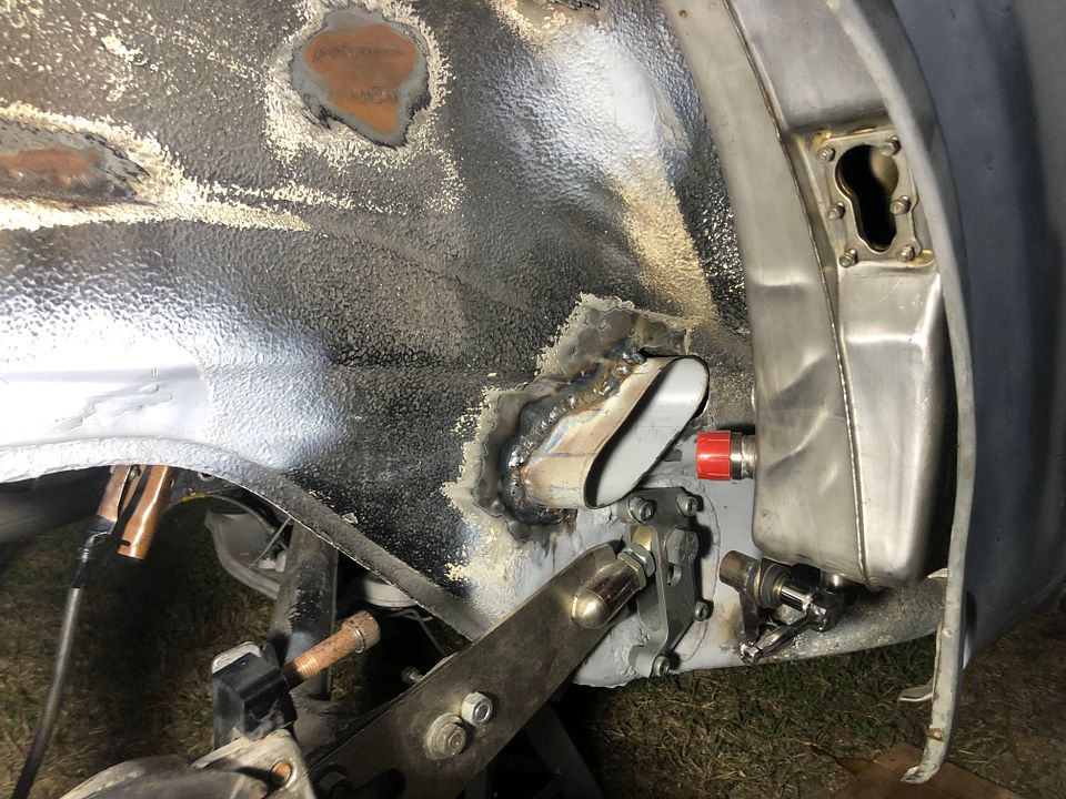

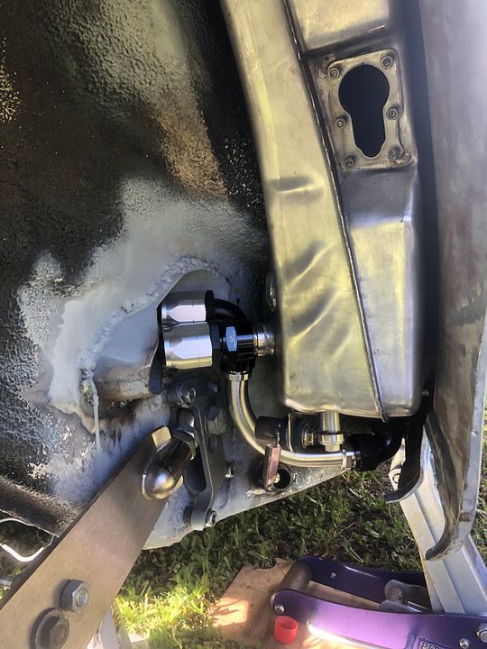

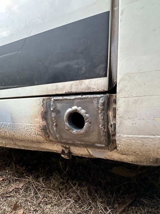

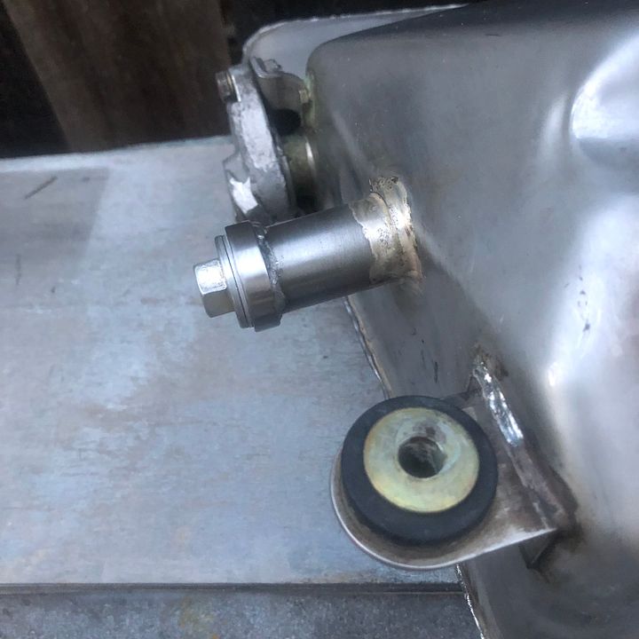

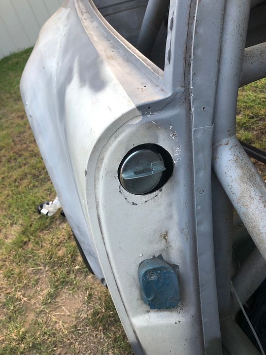

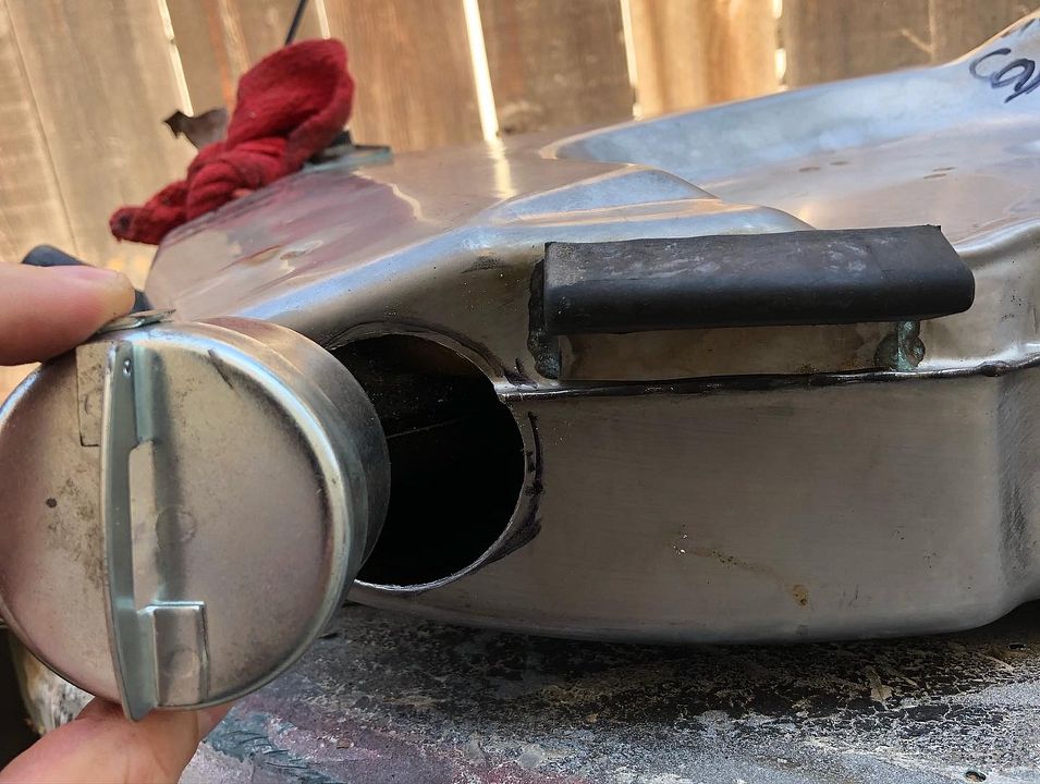

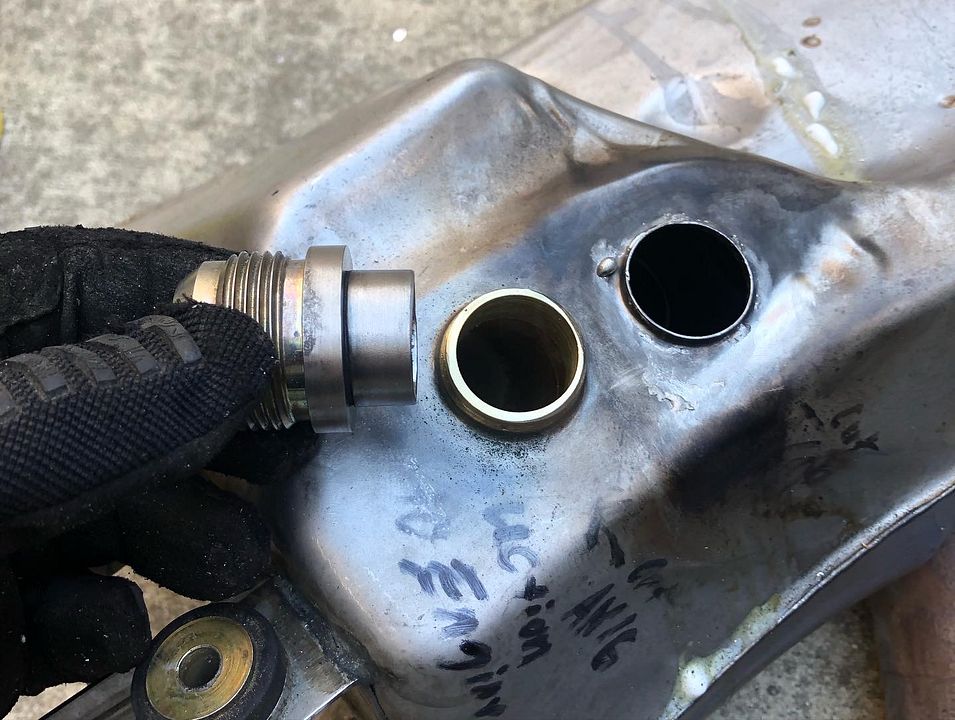

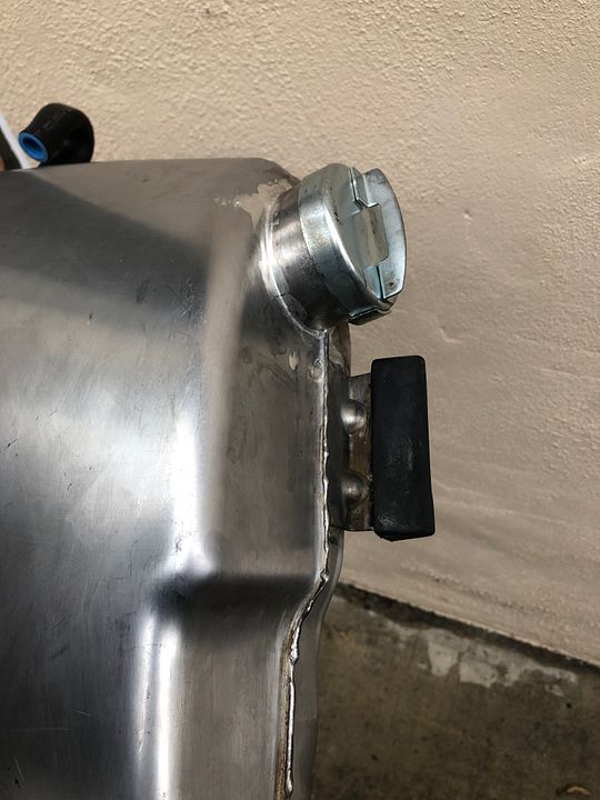

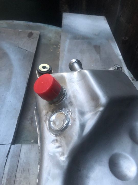

Started the modifications and fitting of the 993 oil tank.
Adapting everything to AN-16 fittings, remote 964 oil filter, through door jam filler, and normal early 911 thermostat that will be in the smuggler's box area.

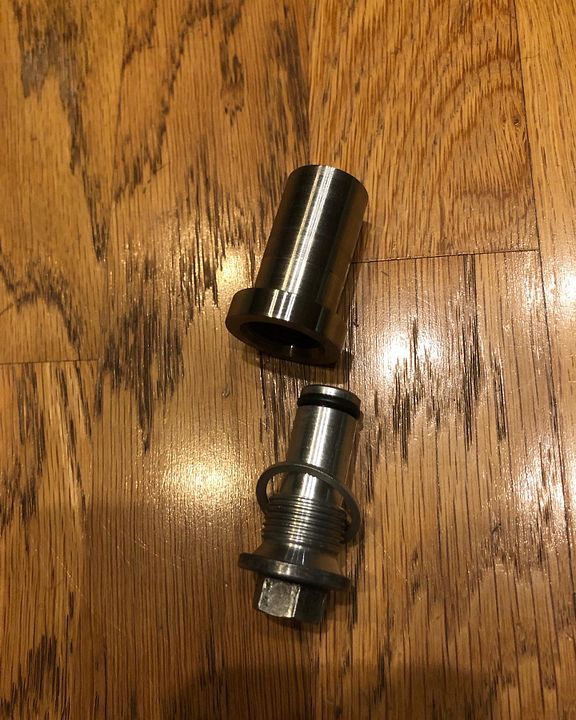

Machined up a custom sleeve for the 993 drain plug that normally lives in the 993 thermostat. Should be pretty cool to have an o-ringed drain plug making it easy to drain the tank without getting any on your hand.
EB98E795-14B7-49DF-A08C-C7B4EDEE283F
FC8EF899-FE5B-4AA2-9DB3-E7046185065C
69BEE94A-2E01-4164-B9A5-84BCA11866EA
Silver soldered into the tank.
78C722F9-876D-475E-8E20-3F9ACC4565F7
Original fill hole plugged and AN bung soldered onto the suction line outlet.
284AF164-DB1F-488B-903E-445052B2FAEE
E3887E0E-34E0-4FBA-B47B-F7B3A3AEFC30
New filler cap fitting
2F910989-E55C-4285-B5E7-33048E3606A4
Next step is to get it mounted permanently in the car to get the fame rail pass though hole in the right spot and fit the hole in the door jam before soldering in the new filler neck.
C6AC47AF-0C7B-4CC2-B1A8-6DA0B2B2C58C
EA01B50E-CD09-45D0-8B35-2AE1D5180222

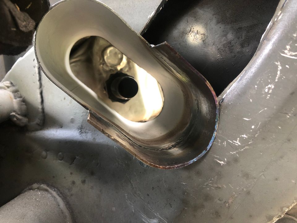

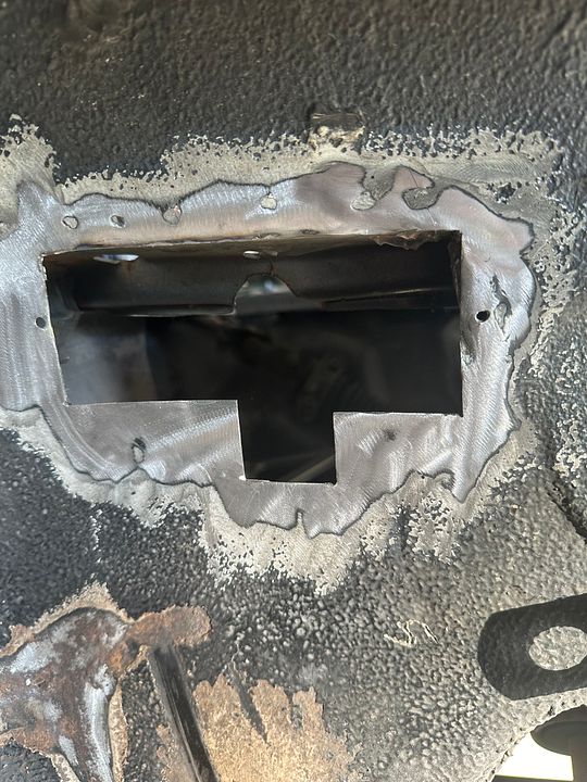

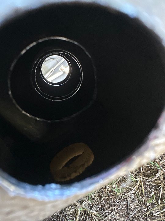

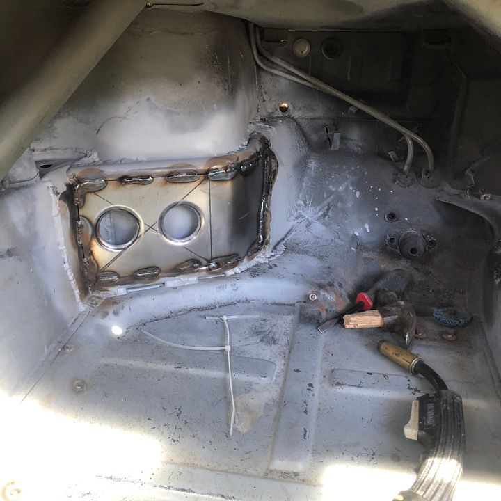

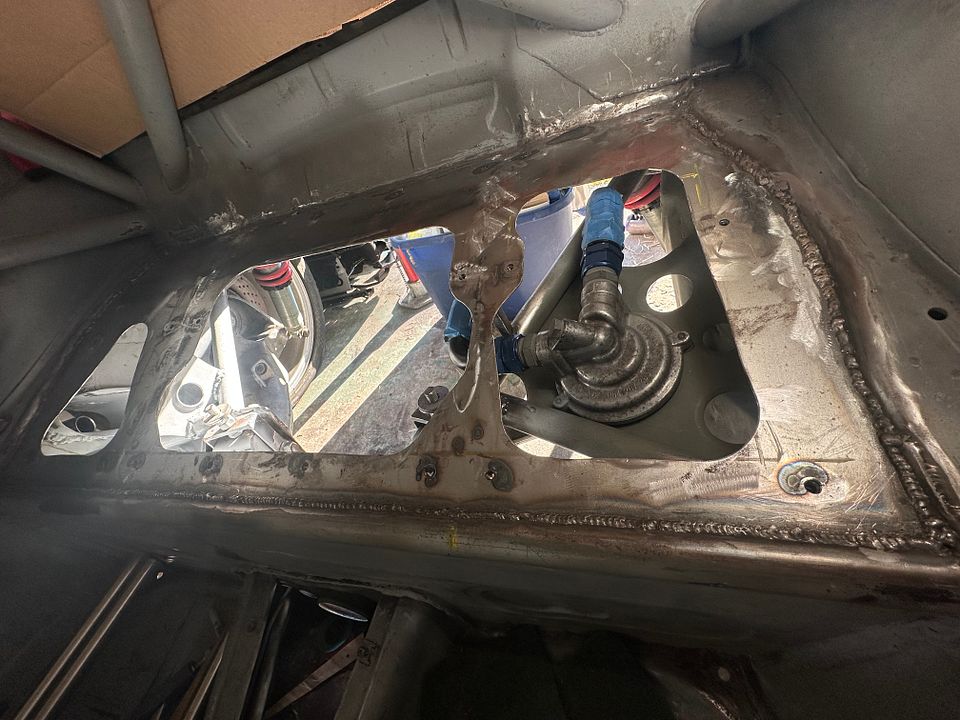

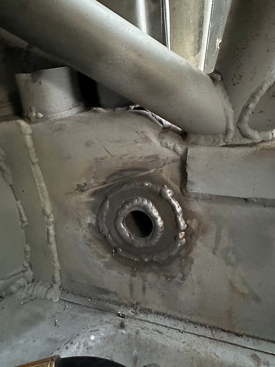

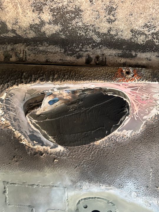

Nearly another year has gone by, would you look at that. I have made a little progress though despite a wet winter and too many other distractions.
Now being at least half way to the other side of it, I don't recommend doing a 993 oil tank or at least how I have done it........... So much work.
Cut a big hole in the chassis.
IMG_9865
And then make it MUCH bigger.
B12E9F87-1ECF-43DF-BFFB-7729888C5B74
Fit some NASCAR boom tube exhaust tubing.
E28DB22D-30EC-41B9-ACEF-00C9E2843A89
Do a lot of welding
IMG_0396
1BCD88B0-D53F-4B34-9C90-2E5DB9BB09EE
Trim some more, make a hard line...... hey this might work!
IMG_0744
Finish silver soldering on the new filler after aligning everything..... got to do this twice as I had it clocked incorrectly the first time. The cap has to be in the horizontal position to clear the door.
IMG_9905

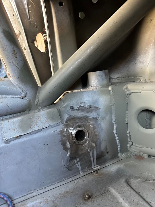

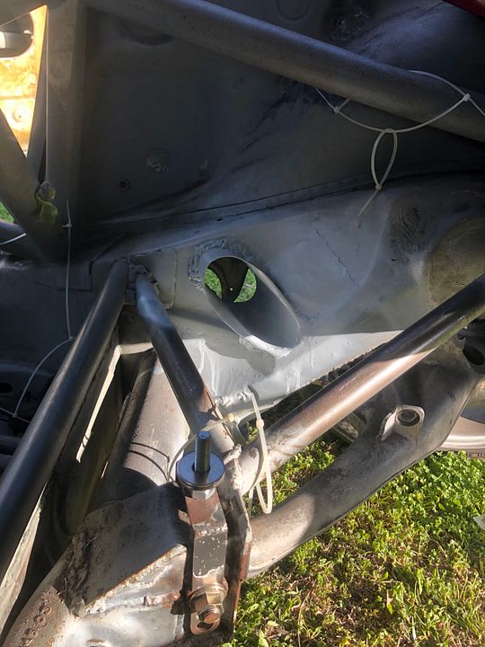

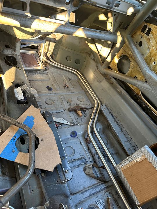

Can't locate where to put the bulkhead fittings in the rear firewall without oil lines. So bend up some stainless tubing.
70207569583__305445EB-CB75-4D9F-806D-2CBB5A4C90D2

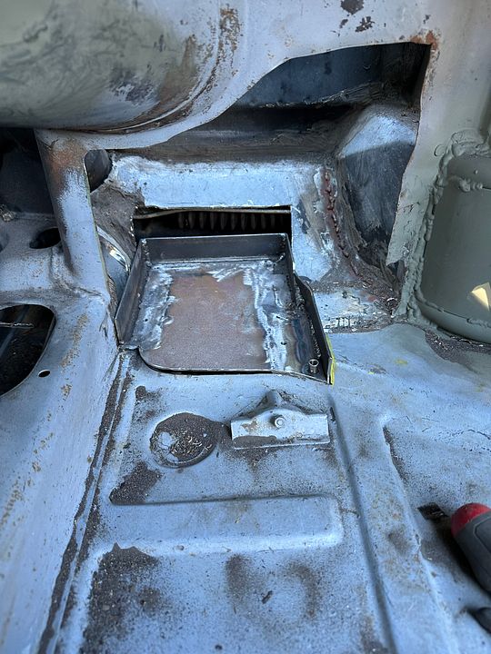

But now to fit a full size battery in the smugglers box sideways gets tight..... do have to figure that out.
IMG_1103
Do some trimming on the Ebay battery box.
IMG_0847
Cut another giant hole.
IMG_1504
Make a metal shoe to fill the hole.
IMG_1505
Finally getting somewhere.
IMG_2601

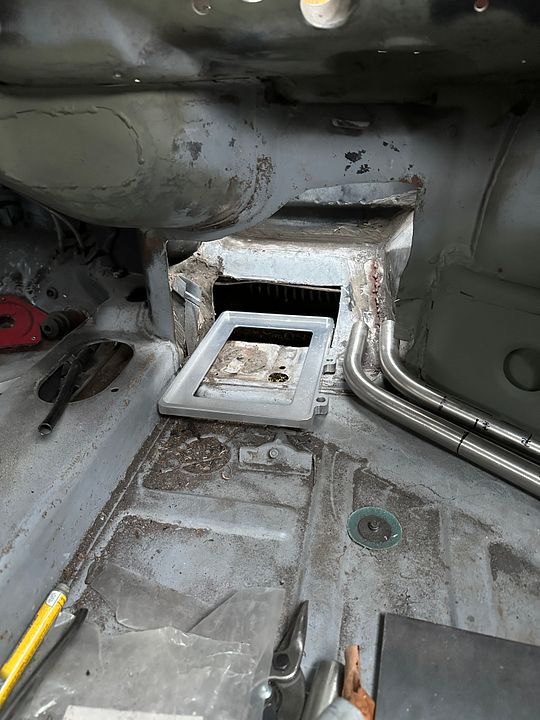

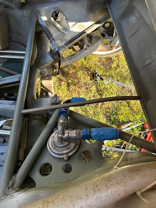

Back on the other end finish messing with the 964 oil filter console bracket.

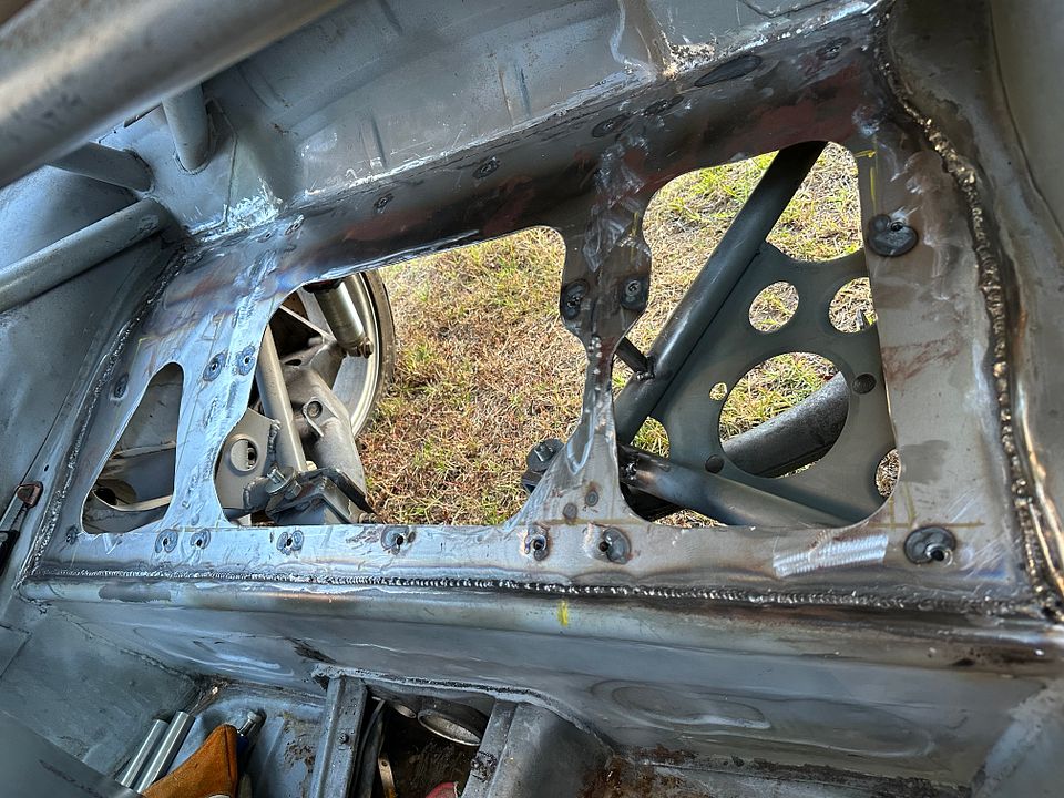

IMG_2599

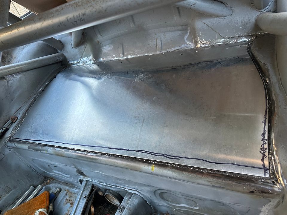

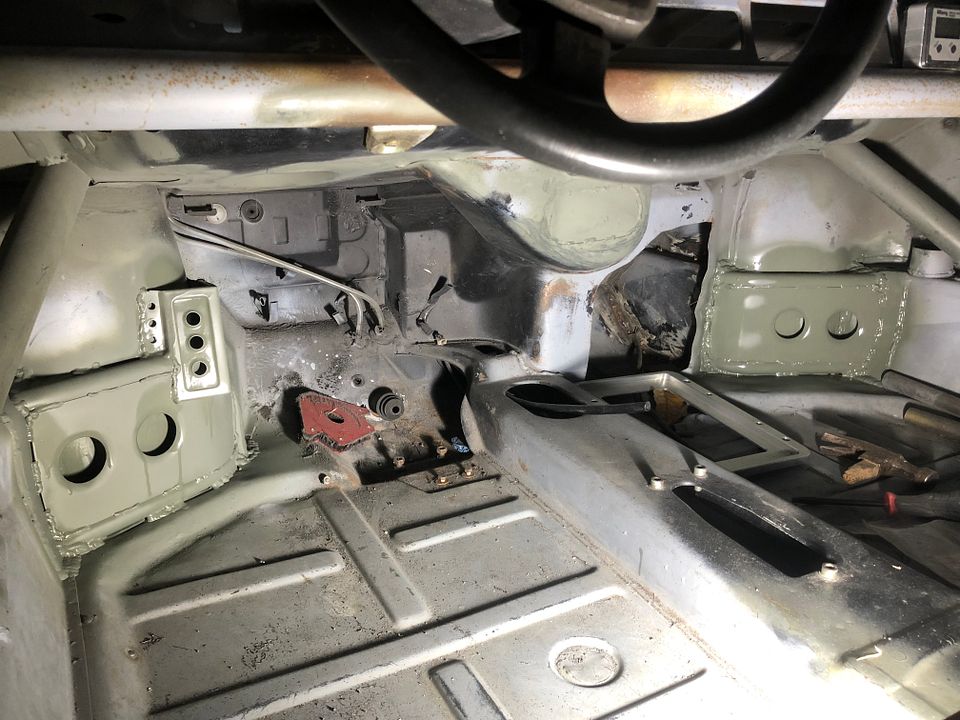

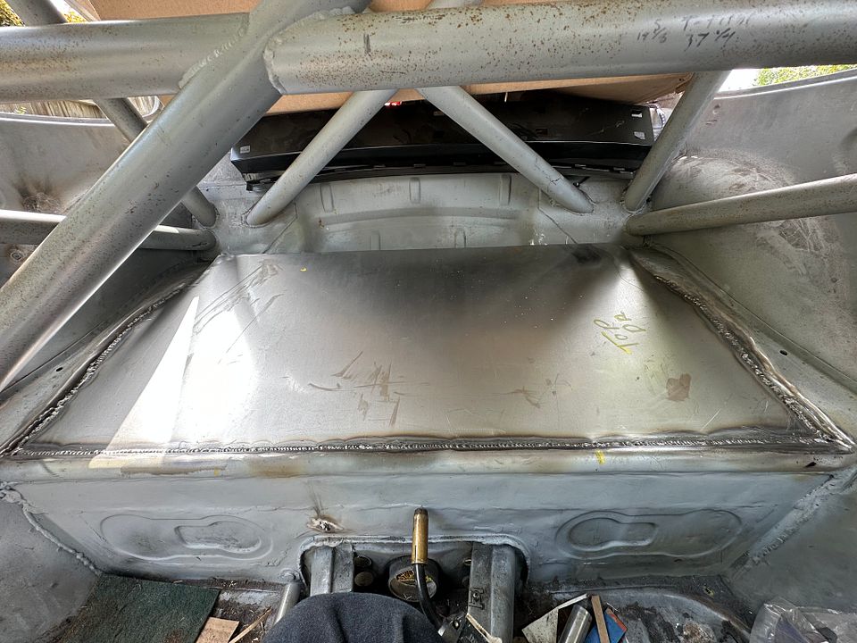

And now I can almost go back to finishing closing up the back seat area that I cut out oh so long ago!
71720903288__25387733-2A8E-48B7-819A-38F3F1556891

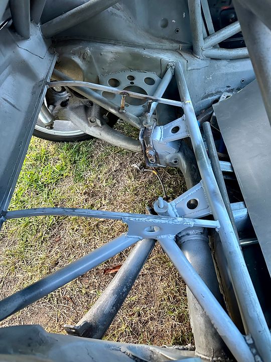

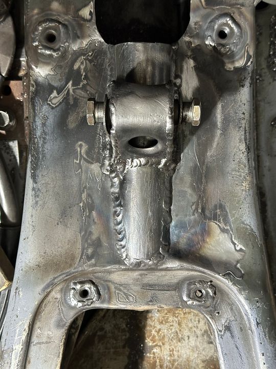

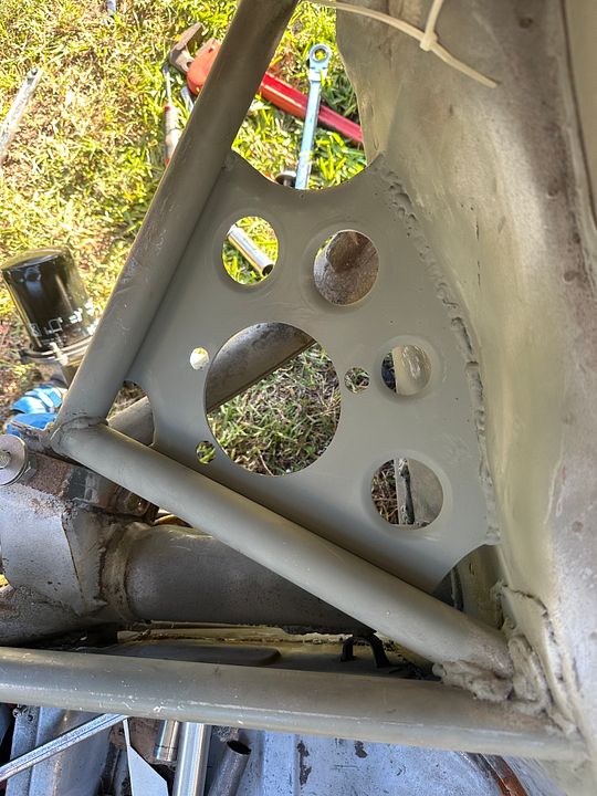

Finally almost done with the torque tube and rear suspension mounts.
I do love me some dimple died holes.
71839788736__730EDB5B-8D8C-4852-B612-D05A5B4F0698
71840311605__CC75E5D7-4807-4DD6-A695-400E127A8F11
IMG_2693
Soooo much welding.
IMG_2716

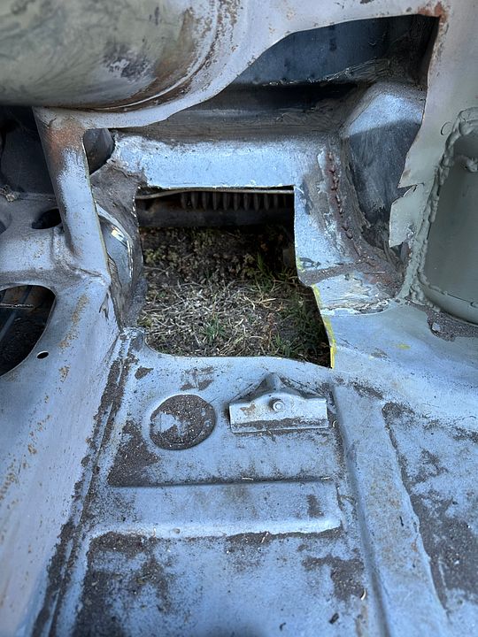

Just to cut big access holes again.
IMG_2819
964 oil filter console fits still......... kinda.
IMG_2891

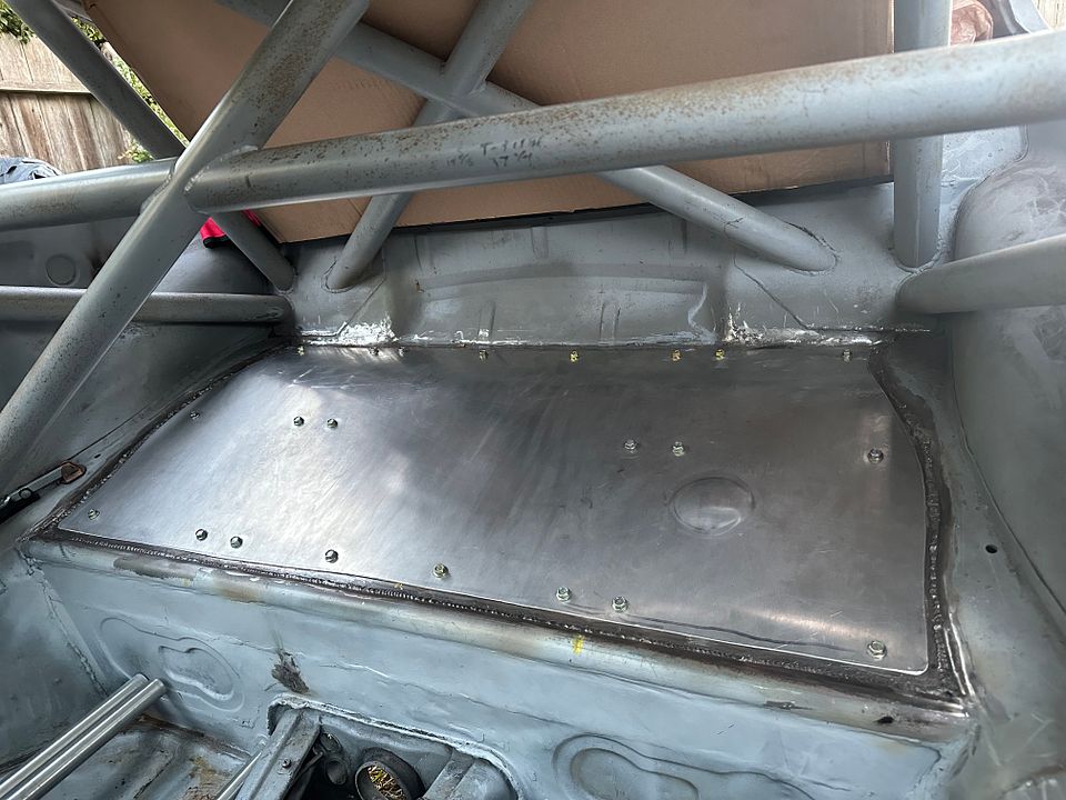

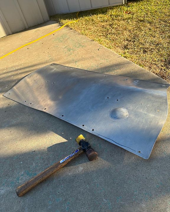

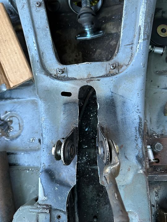

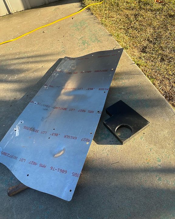

Rear seat delete panel round 2! Never underestimate how long it takes to trim and fit these panels and line up mounting holes........ it takes forever.
IMG_2820
Extra clerancing required.
63CC646D-07C1-4C4E-9F80-34B38148607A
360C9BCB-B9B0-4782-AC34-C0987A43D5AB
Finally done....... pending some titanium pan head bolts........ and maybe a carbon kevlar skin on the aluminum panel to try and cut down on the tinniness of it a little.
IMG_2894

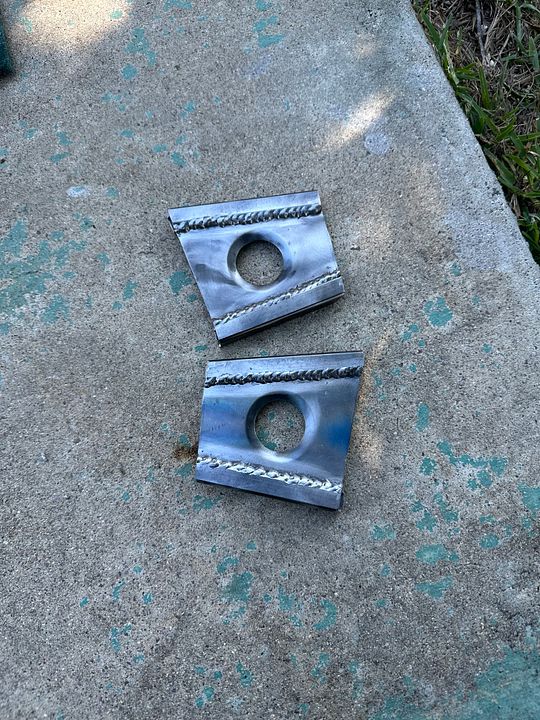

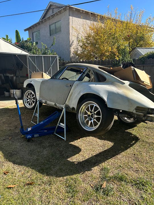

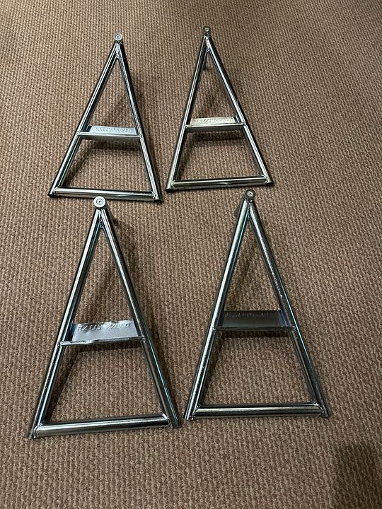

Got myself some pin stands.
IMG_3017

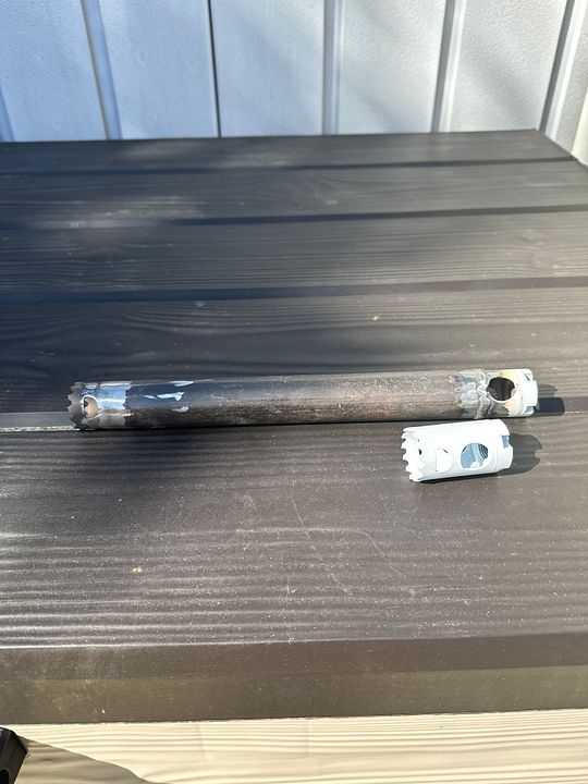

Had to make an extra long hole saw.
72203113720__E94A840B-68BD-4DE7-9A49-6ADF786438F8
Just a few layer to drill through.
72203261524__7905DCFB-3BAE-4C91-BFFF-F8436888AEBE
1.25 x .120 wall tubing goes in next.
IMG_3026
Lots of welding later.
IMG_3029
IMG_3073
IMG_3076
A little extra bracing on the rear ones.
IMG_3089

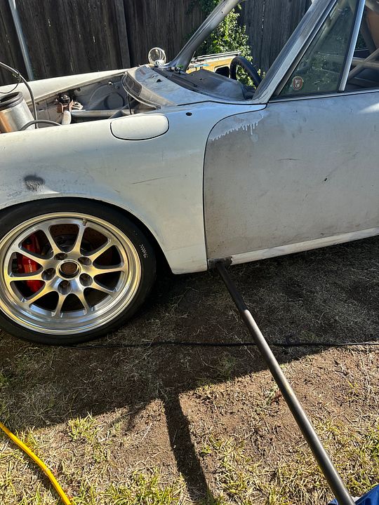

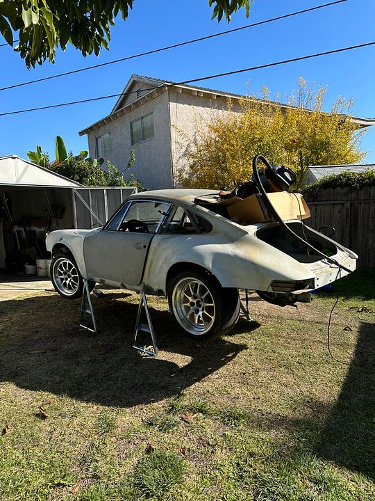

Only slightly sketchy jacking on dirt.
IMG_3109
This height sure makes working on the bottom of the car a lot nicer.
IMG_3111

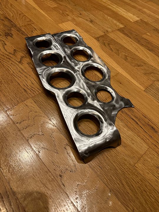

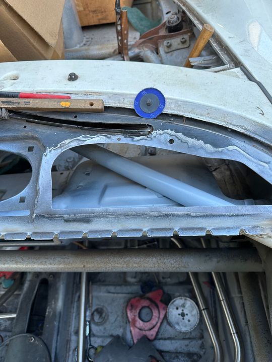

Started filling dash holes. Going to go with an RSR style Perlon dash with no dash pad.
Might as well tie the X into the top of the glove box while it is accessible.
IMG_2973
IMG_2976
IMG_2977
IMG_2980
IMG_2980

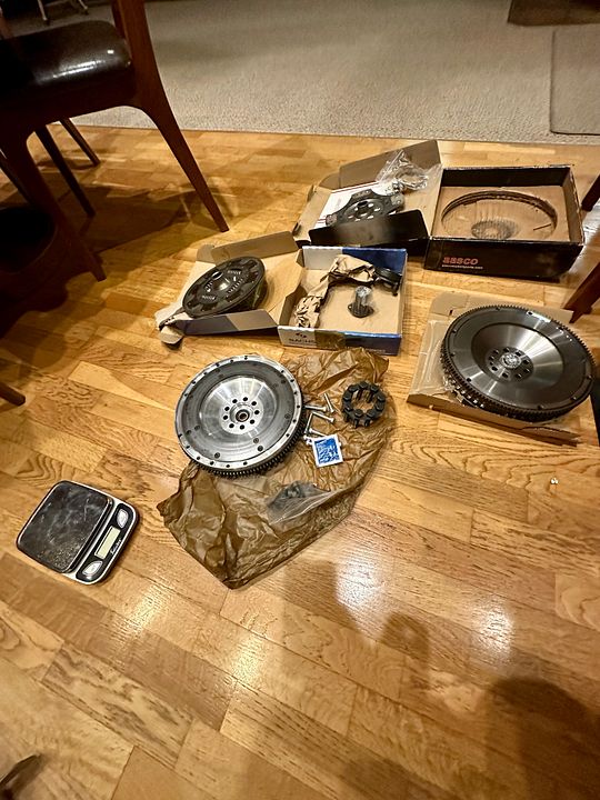

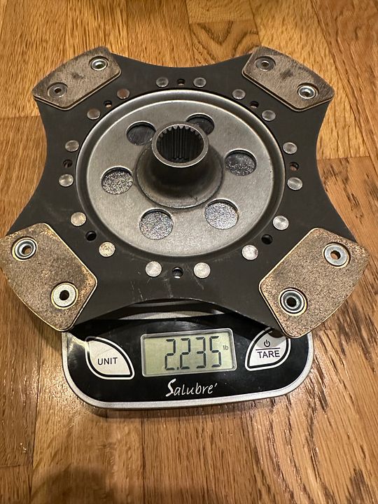

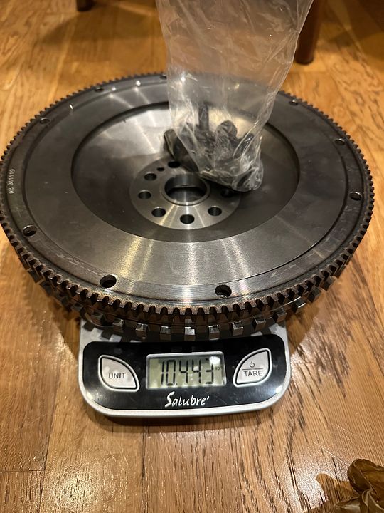

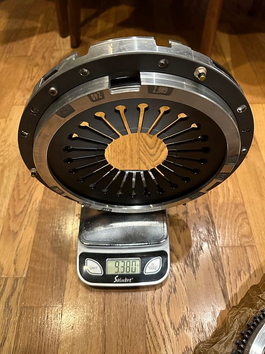

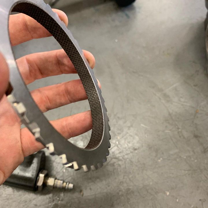

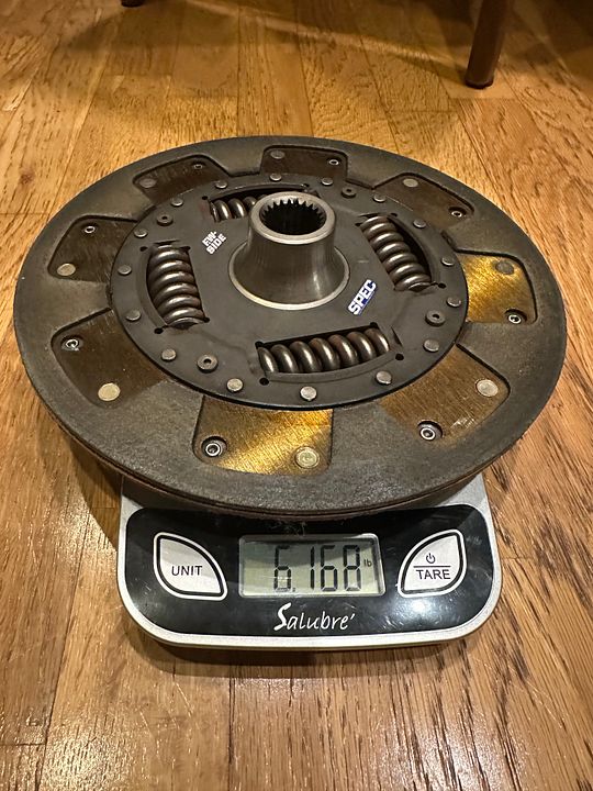

Drive train planning has also been going on. Have a couple clutch and flywheel options to choose from. Some interesting weight data.
IMG_2993
AASCO aluminum 3.6L flywheel 14lbs
964 RSR/ GT3 RS 4.0L flywheel 10.4lbs
Sprung hub semi metallic/kevlar clutch disk 6.2lbs
Unsprung 4 puck disk used in 993 GT2 and 996 Cups 2.2lbs
Might be a little rowdy with and unsprung puck disk but saving 4lbs off of the clutch disk is huge for reduced effort on what the synchros have to speed up slow down.
GT3 RS 4.0L pressure plate comes in at 9.4lbs. It has a steel friction surface unlike the plasma sprayed air cooled RSR pressure plate which I had in the car. Saving a little weight on the clutch disk but I think my total rotating mass will actually be almost identical to what was in the car before.
IMG_2990
IMG_2988
IMG_2987
IMG_2996

Been some progress happening. Got the return for the oil tank welded in.
IMG_3113
IMG_3117

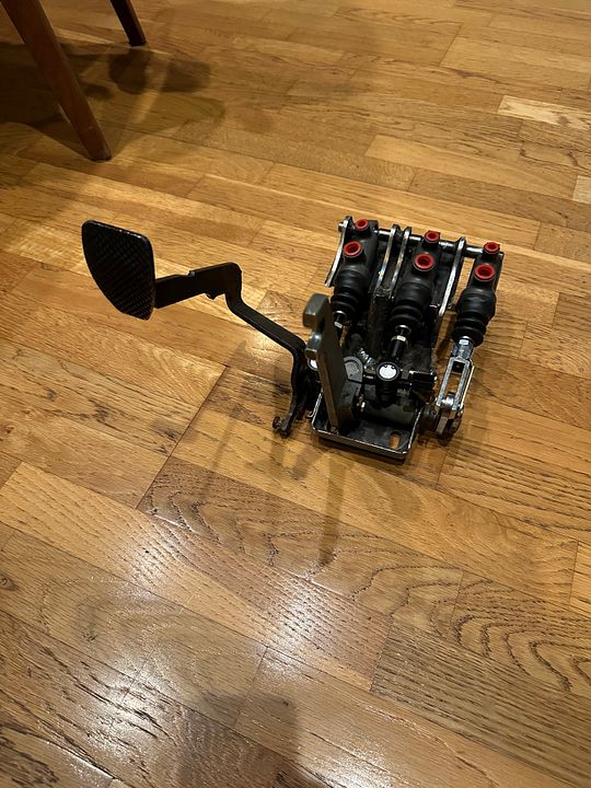

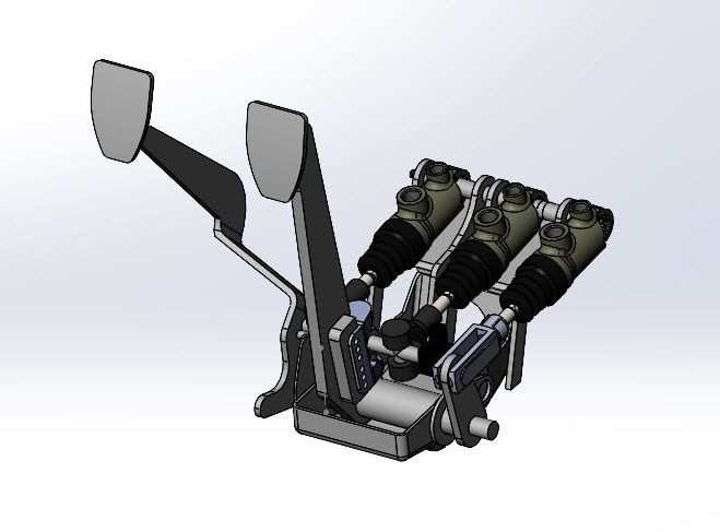

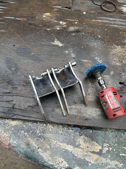

Got on the CAD one weekend and designed my own pedal box using Tilton 78 series master and a 900 series balance bar....... as is proving with most of the car, I am not the first to make any of these parts and it takes forever but I can actually get them. Trying to buy some of these not so standard bits has been quite painful so.
2024-01-15_10-12-09
IMG_3505
IMG_3606
IMG_3612
IMG_3614

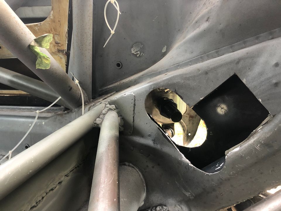

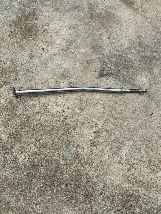

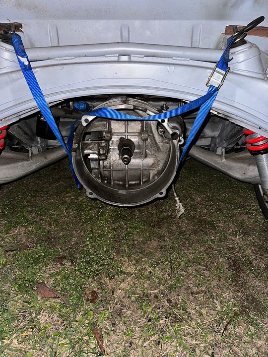

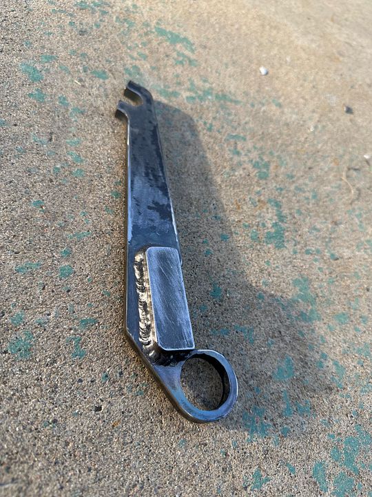

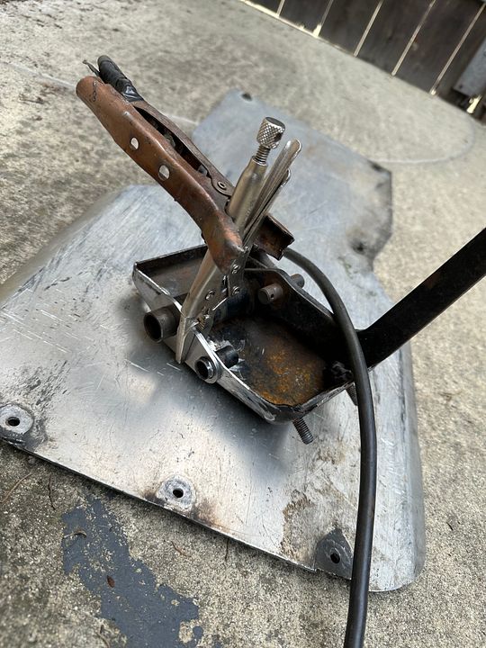

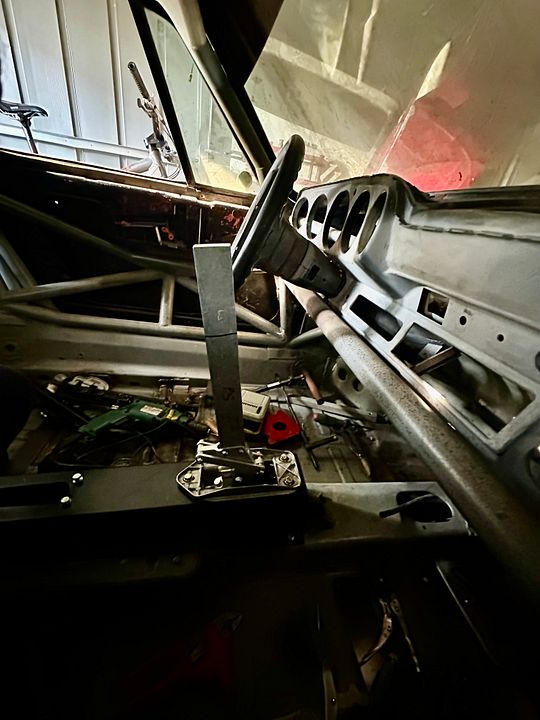

Dug the gearbox back out and test fit that again to work out the shifter.
IMG_3249
IMG_3254

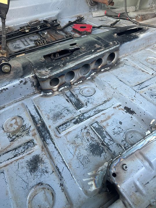

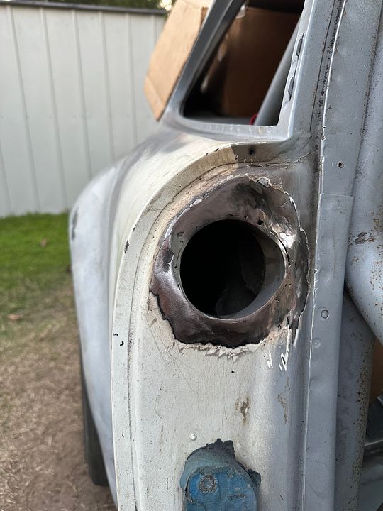

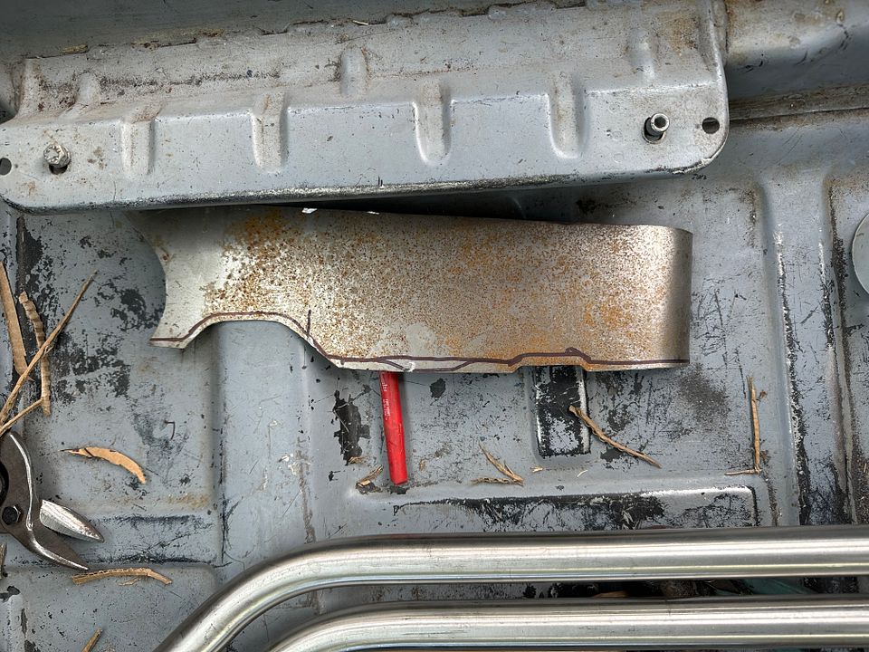

On the long list of questionable decisions, cut some more holes in the car to fit the GPE Raised shift tower.
IMG_3269
Had to section some off the end of it to fit around the inner seat belt mounts. This riser is designed to bring the shifter 4in back and 4in up........ so the shift rod also has to be shortened...... and the parking brake tubes...... and of course the shifter handle now need to have some of the curve taken out of it.
IMG_3245
Shift rod shortened with 2in out of the front and 2in out of the back.
IMG_3647

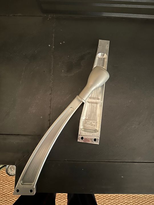

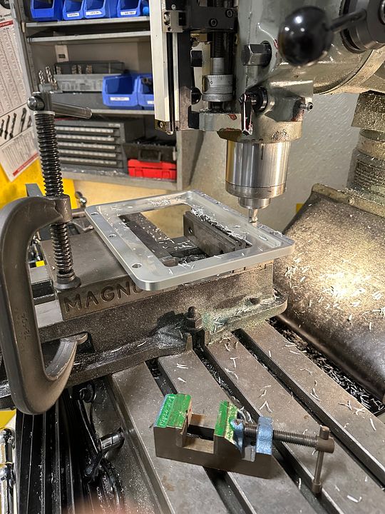

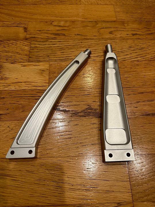

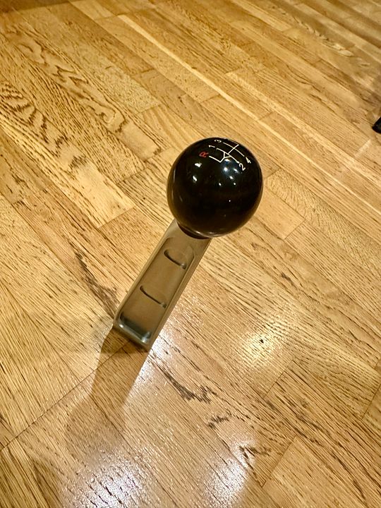

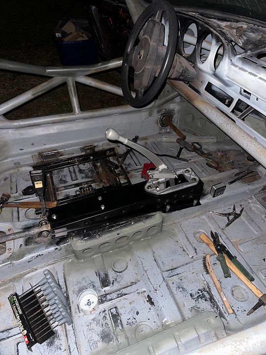

Machined up a straight shifter on a manual mill to try it out....... this shows the relative position of going 4in back and 4in up with the shifter base.
IMG_3351
IMG_3372
Design was a go...... so I had one CNC machined, bead blasted, and anodized to fit a custom shift knob Dave Mason made me as a favor for making his first shift bushing prototype all those years ago.
IMG_3550
Featuring the solid ebony knob Dave made me.
IMG_3551
Reinforced where I cut out between the seat belt mounts with clearance for the now angled shift rod.
IMG_3437

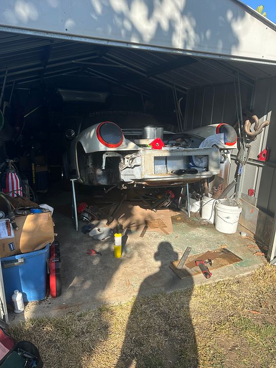

Posts: 1,181

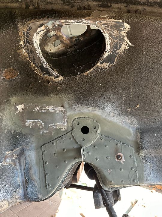

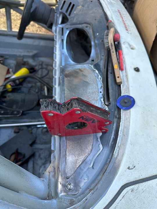

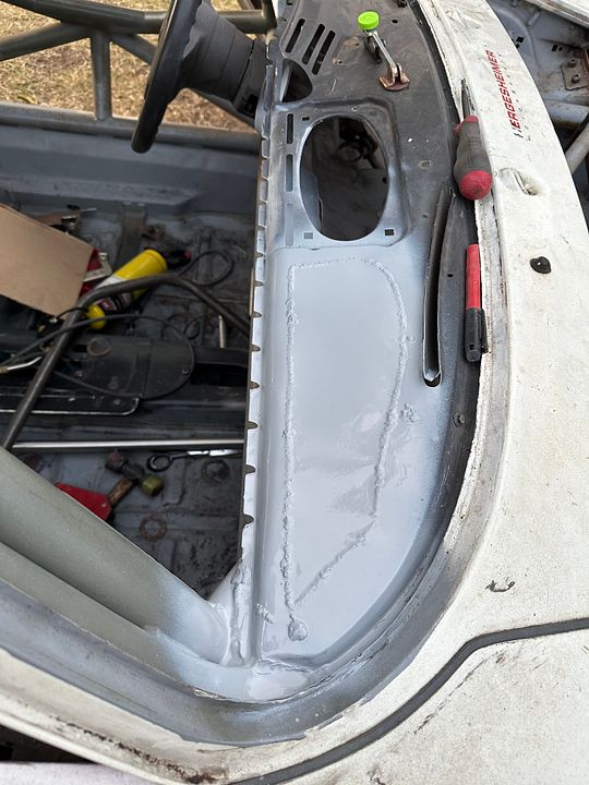

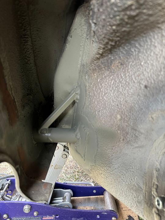

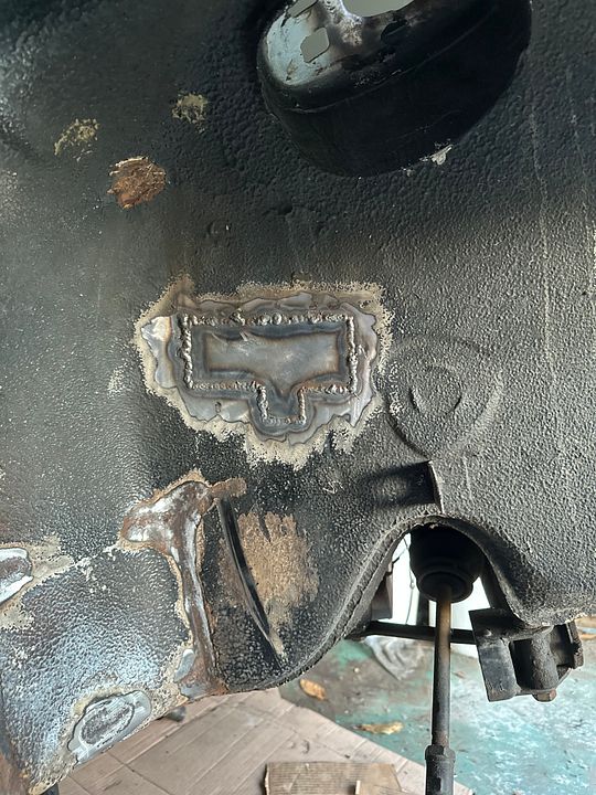

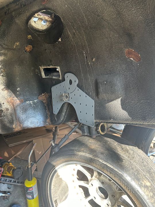

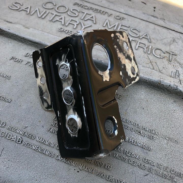

Summer update.

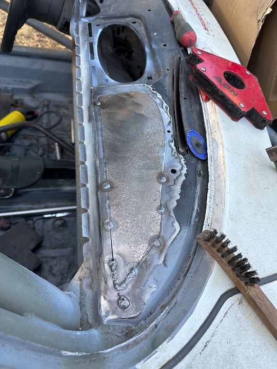

Got the car up in the air and pulled the front suspension to start working on the inner fenders. It's a tight crowded space but you work with what you have.
IMG_6008
Time to fix the butchery what was the dealer installed AC and weld in the swaybar reinforcements. This car is getting a 28mm front bar and I have cracked two 914 chassis here so hopefully this keeps everything attached.
IMG_6007
IMG_6011
IMG_6014
While I am in here, time to delete the pinch weld on the shock tower as the tires hit it at full bump and don't want to cut down a tire.
IMG_6020
Now to do it all again on the other side!
IMG_6021

Dang it! I never knew about this pinch weld delete/shave. May give that a go when the fenders come off next.
Keep going! Looking forward to the day this thing gets on track!

I’m also looking forward to driving it one day, thanks for the encouragement Chris!
Your car the pinch weld may be a non-issue. Only really becomes an issue with lots of camber on wide high offset wheels with large diameter tires. I suspect with your new fenders, your tire is outside of the inner fender.
